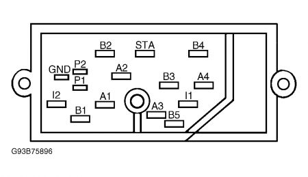

That could be related .. if the ignition switch is sticking .. the contacts inside the switch ... it may be not connecting the live to the starter motor correctly ..
IGNITION SWITCH
To inspect ignition switch for mechanical operation, rotate lock cylinder through all switch positions. Lock cylinder should not bind, and should return from START to RUN position without assistance. Replace ignition switch as necessary.
To test electrical function of ignition switch, disconnect ignition switch connector. Check continuity between specified switch terminals using a self-powered test light or ohmmeter. See Fig. 2 . See IGNITION SWITCH CONTINUITY table. If continuity is not as specified, replace ignition switch.
Continuity Between TerminalsSwitch Position
STA & B4...................Start
GND & P2...................Start
B5 & I1.......................Run
B1 & A1......................Run
B5 & A1......................ACC
B3 & A3......................Run
B2 & A2......................Run
B4 & A4......................Run
Fig. 2: Identifying Ignition Switch Harness Connector Terminals
http://www.2carpros.com/forum/automotive_pictures/266999_term_1.jpg
the engine should crank over by hand .. it will be easier if you take the plugs out ... ...if it doesn't crank by hand .. we're in big trouble .. the engine is seized somehow ??
