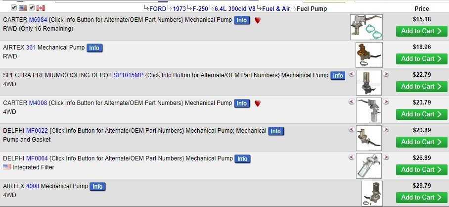

At the end of my answer I "screenshot" part of rockauto.com.(you cannot do any clicking on my picture!)
They show various pumps in their catalog.
Go there, plug in your information, find what I screenshot.
Click into each one of the pumps and see if any look like your old one may have looked. If there are different views, look at them too. Read specs, look at the arm lengths.
Here is the link to get you started:
http://www.rockauto.com/
Maybe you will find the correct one. I have also looked at other online auto stores, most seem to have a long arm.
