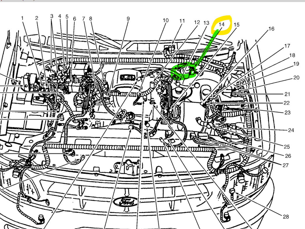

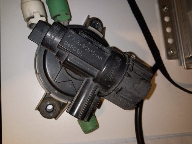

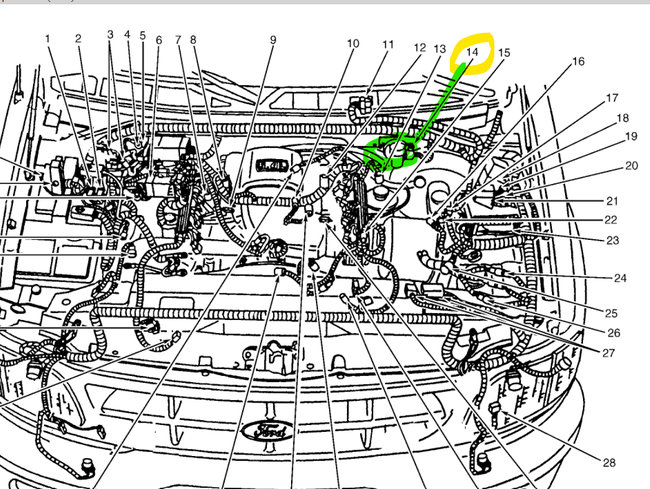

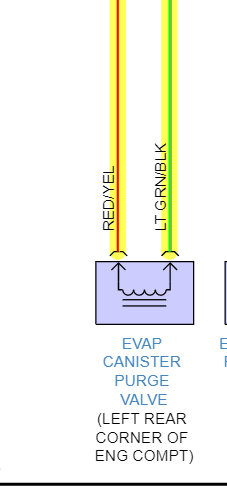

AL514
  • 4,795 POSTS
Another possibility is while the gas cap was off, liquid gasoline ended up in the vapor system and is causing either a blockage or is drawing liquid gas threw the vapor system into the vapor canister, then flooding the engine out. This seems to be more of a logical answer because you replaced the gas cap and now still have an issue. These systems can be hard to diagnose. But having someone check to see if the vapor canister (Charcoal Canister) is full of liquid gasoline may be in order. Or you can unplug the Purge valves electrical connector and see if the truck runs better just don't leave it unplugged for long. If you want to try unplugging the Purge valve let me know and I'll try to find a picture of it with the wiring colors to it. It's a 2-wire plug.
The 1st picture is the general location of the purge valve. The 2nd is the wiring colors of the connector on the purge valve, and the 3rd is the valve itself from a 2001 ford that I happened to have. You'll notice the little green cap. If you unplug the electrical connector and the truck runs better, then you know where the fault is.
Thursday, February 10th, 2022 AT 5:47 PM

AL514
  • 4,795 POSTS
In the 3rd picture above, the Purge valve picture, if you follow the hose on it going to the Intake manifold (where it draws in the vapor) you can pull that hose off the intake manifold and plug both ends, The purge valve hose and the intake manifold hole where the hose attaches too, And start the engine and let it run for a minute and see if its better, but make sure you plug both of the open hoses, you don't want fuel vapors floating around the engine compartment while the engine is running. This will help rule out if the Purge Valve is stuck open.
Also inspect the Gas Tank filler tube, (where you put on the gas cap) for damage. If you had to really fight to get it off, it might be damaged as well.
Just be careful when working around gas fumes, don't make any sparks.
Tuesday, February 15th, 2022 AT 10:51 AM
