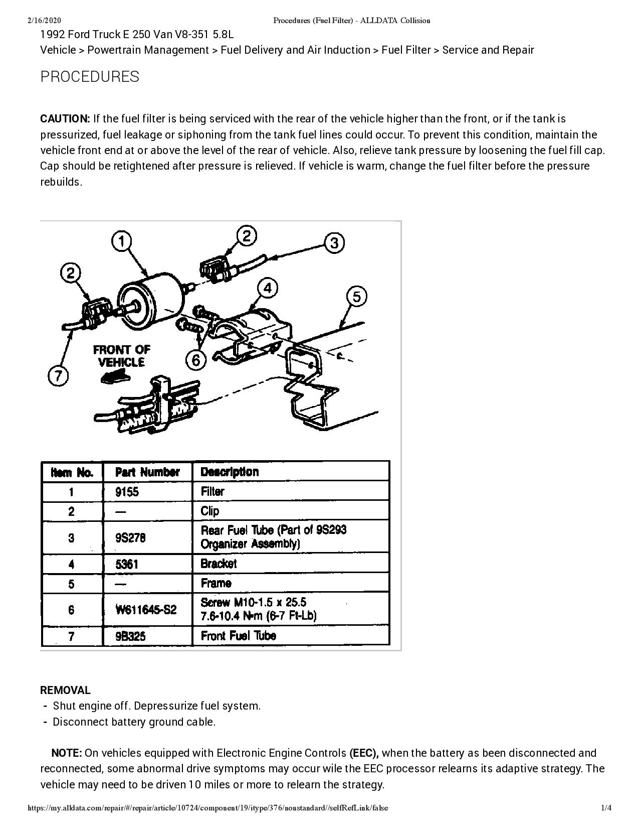

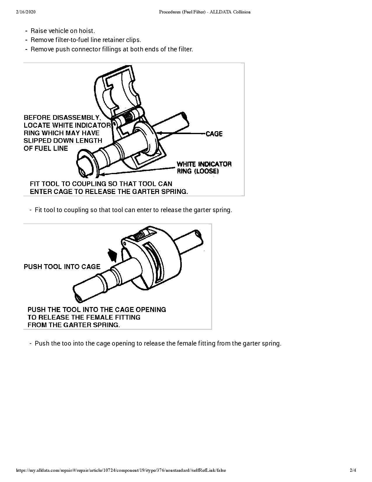

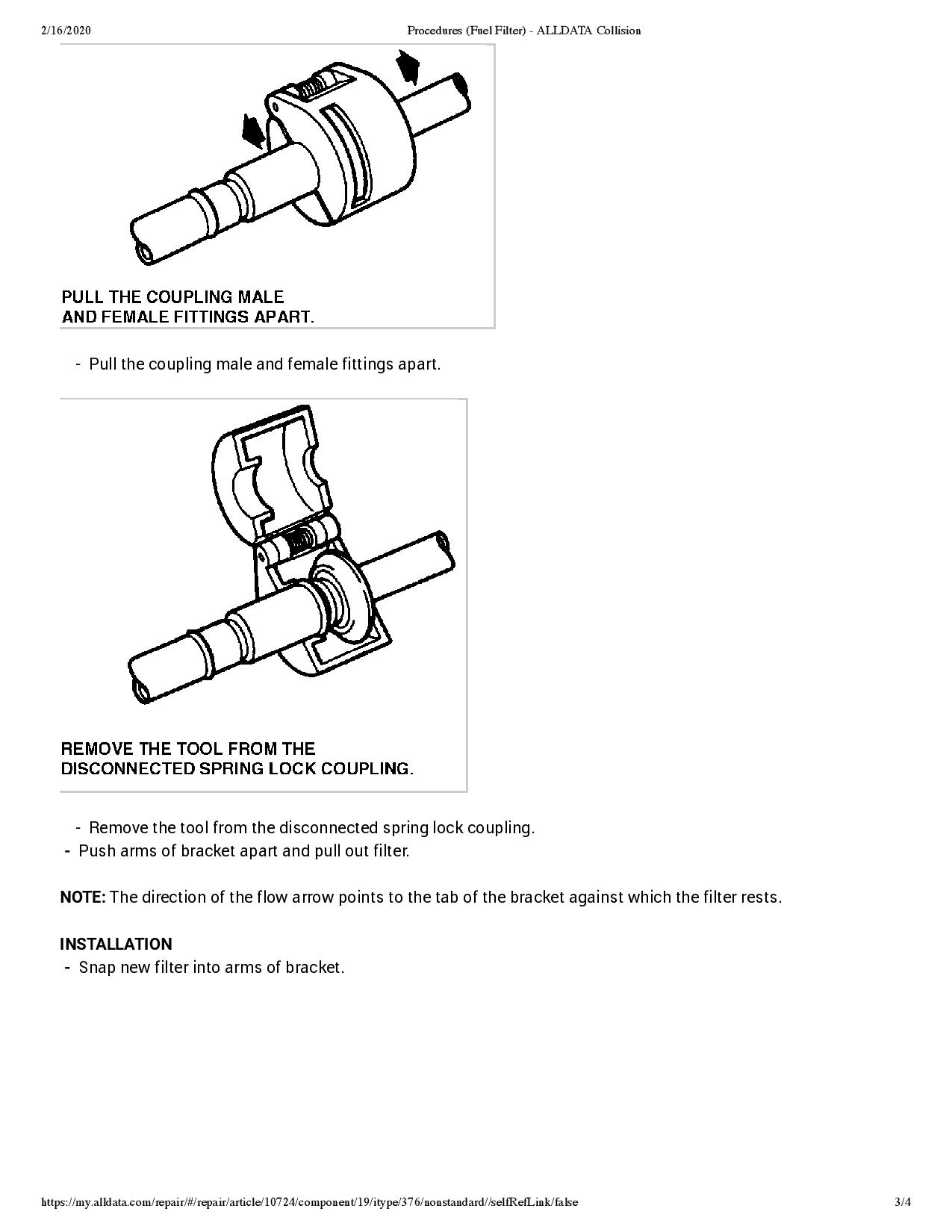

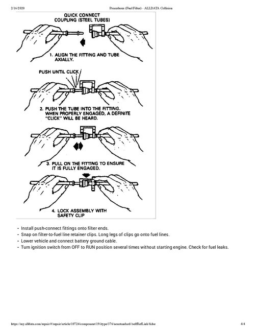

Hey DILDON,
Did you also replace the fuel filter?
Sounds like you may have already but wanted to confirm.
The instructions for replacing the filter are below.
I would advise when you have the the old filter removed try blowing back through in reverse direction into a container and seeing how contaminated the fuel entering was.
How did the inside of the tank look when you replaced the pump?
Regards, Joe

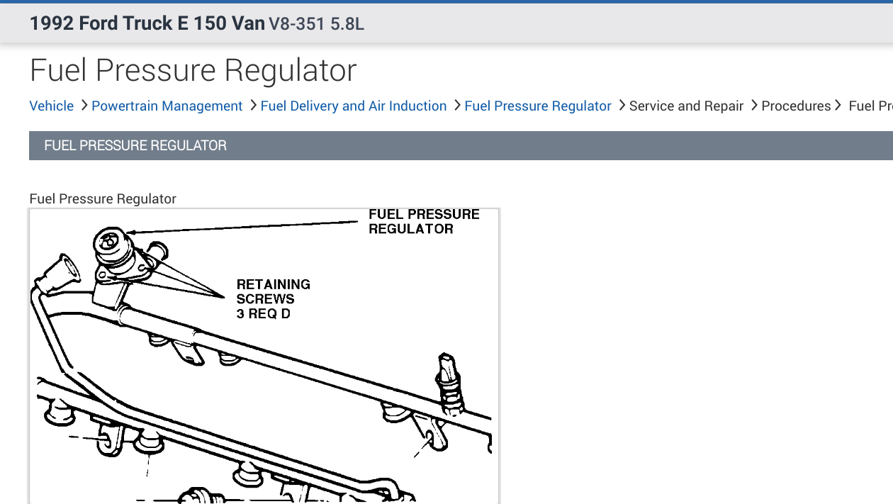

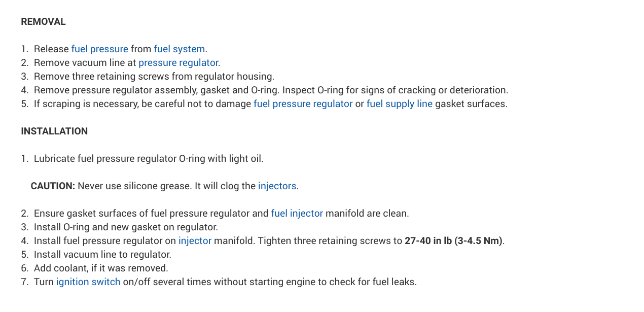

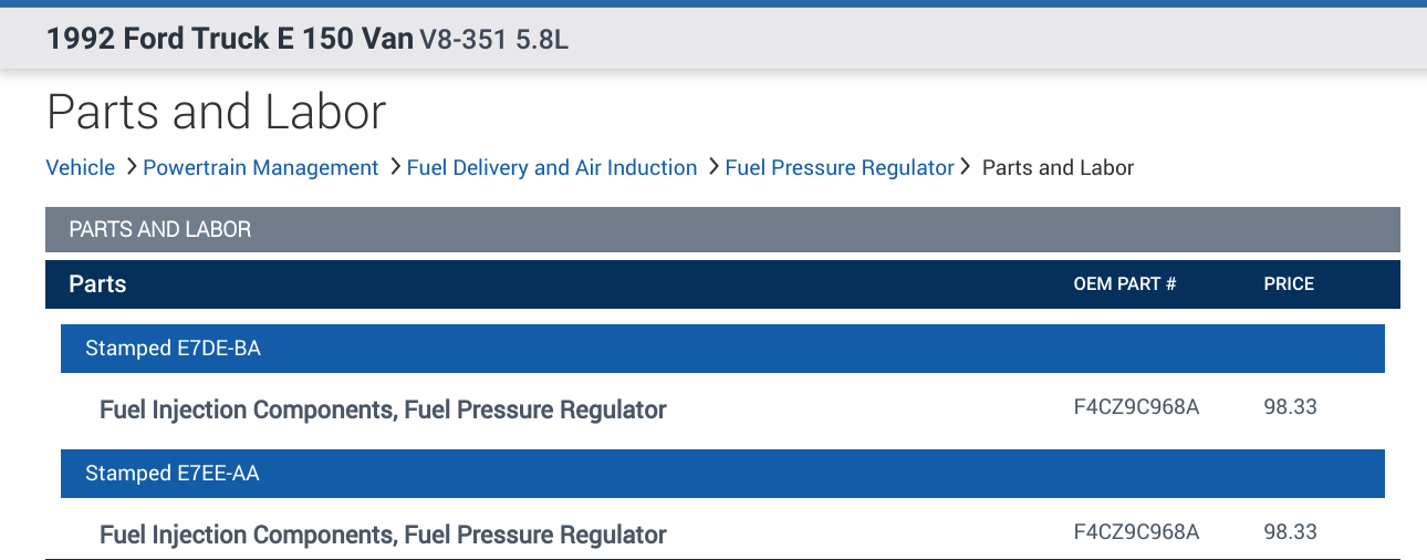

This sounds like you could have a faulty fuel pressure regulator. The fuel pressure on Ford vehicles should be 39.15 lbs. at the fuel rail. What usually happens when the fuel pressure regulator fails is the diaphragm inside fails and allows fuel to leak into the vacuum line on top. In the diagrams down below I have included the directions for the removal and installation of the fuel pressure regulator for your vehicle as well as the Original Equipment Manufacturer[OEM] part number for your reference. Please go through these guides and get back to us with how everything turns out.
Thanks,
Alex

Hey DILDON,
To confirm you have replaced the fuel filter?
It sounds like you have a restriction in the fuel system.
I would ensure that you haven't crushed or kinked any fuel lines when installing the pump.
Also can you check the vacuum line to the pressure regulator and make sure it is in good condition.
What did it look like inside the tank when you replaced the fuel pump?
Regards, Joe

Hey DILDON,
Let us know about the fuel filter condition, remove the filter and blow back through to check for dirt.
Recheck the fuel lines and let us know what you find.
Regards, Joe

SCGRANTURISMO
  • 4,897 POSTS
Hello again,
After you install another fuel filter please check the fuel pressure regulator and get back to us.
Thanks,
Alex
