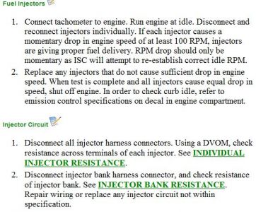

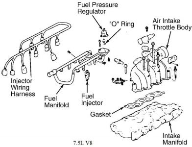

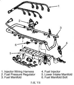

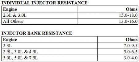

Runs like it is choking all the time. Black smoke when starting and when on the road step down on the gas more black smoke. I have changed many parts. o2 sen, temp sen, manifold temp sen, egr position sen, egr, map sen, all vac lines, cap, rotor, pluges, wires, fuel filter. I have checked the grounds I could find.
What is good fuel pressure? Where is the regulator ?
How do you check injectors? is there a voltage?

KOEO=Key ON Engine OFF KOER=Key ON Engine RUNNING with 5.0L(302ci) V8
https://images.2carpros.com/forum/automotive_pictures/55316_92e150fuel302_1.jpg
with 7.5L(460ci) V8
https://images.2carpros.com/forum/automotive_pictures/55316_92e150fuel460_1.jpg
https://images.2carpros.com/forum/automotive_pictures/55316_92e150fuelinjector1_1.jpg
https://images.2carpros.com/forum/automotive_pictures/55316_92e150fuelinjector2_1.jpg
Your O2 sensor should fluctuate between 0.1 volt to 1.0 volt, not maintaining a constant 0.9 volts (rich). Black smoke represents rich fuel condition and will have an adverse effect on fuel economy. You are on the right direction. Start with fuel pressure and then individual fuel injector. I would also check for compression. One, maybe more cylinder is not within the specs.
