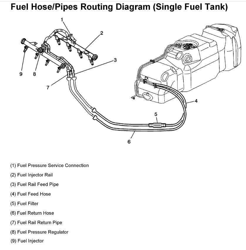

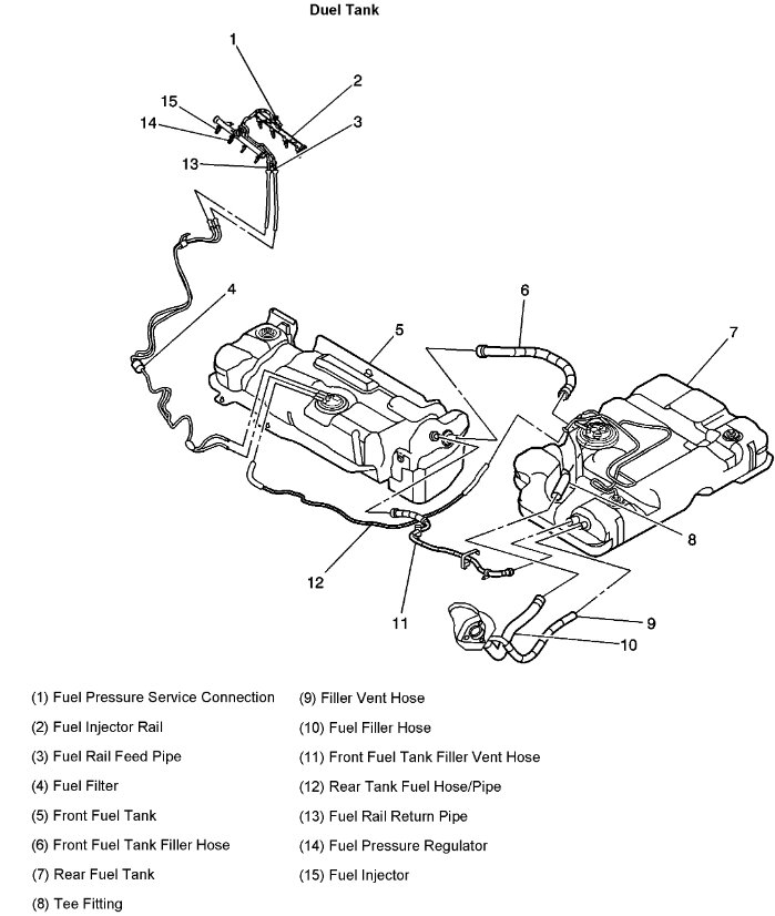

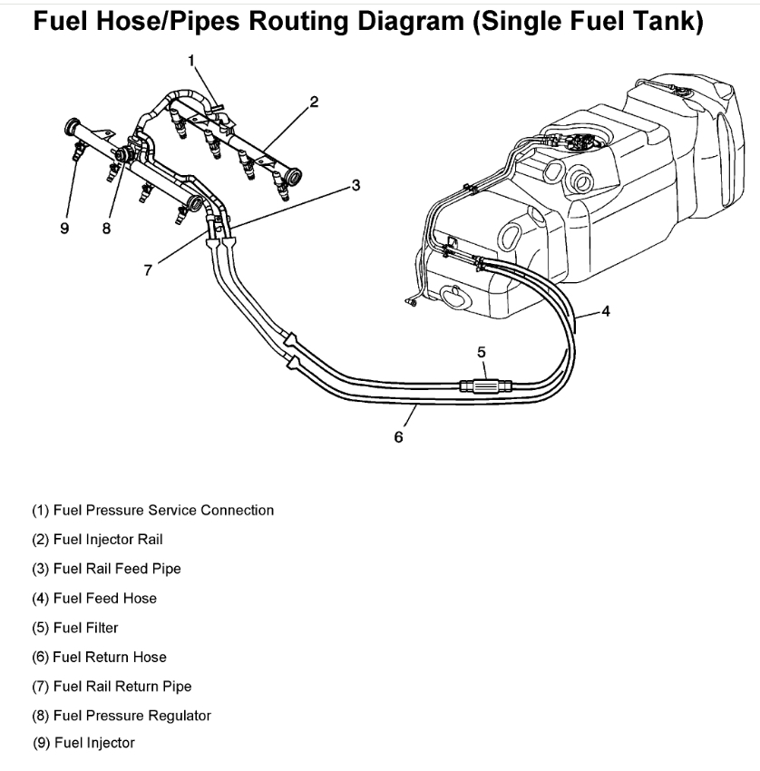

I bought a truck with gas tank out I need a fuel line diagram.
Oct 5, 2024 at 10:44 AM
Experienced Mechanic
55,647 POSTS
Sure, here are the fuel lines for the single and dual tanks. Check out the images (below). Let us know if you need anything else.
