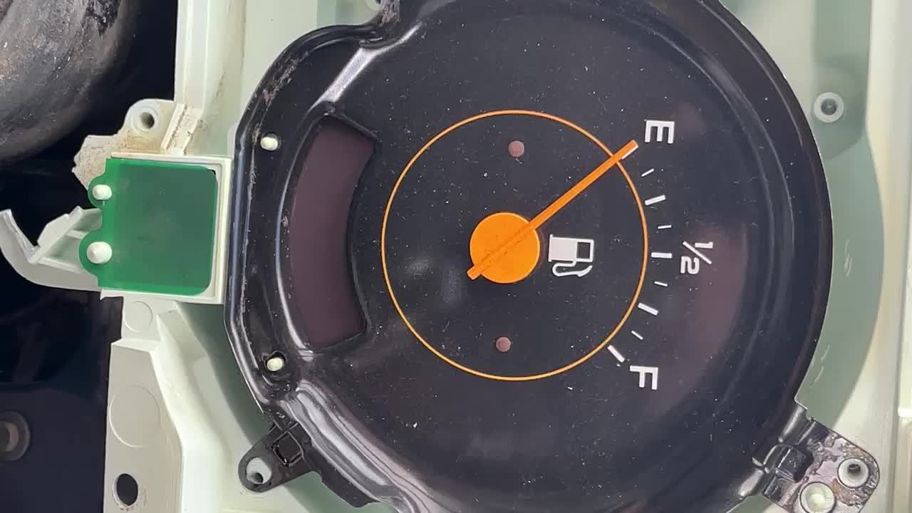

I dropped the tank over the weekend and pulled the existing sending unit. Tested it and it's working perfectly. I reinstalled everything, but still no gauge function.

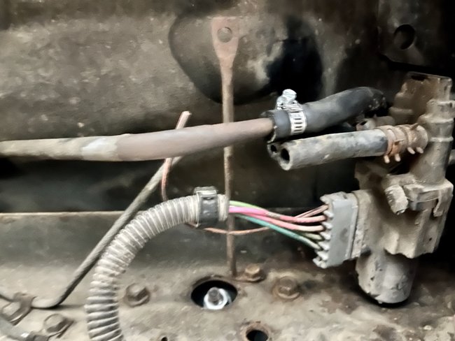

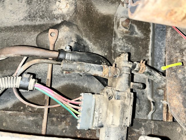

I replaced the dual tank selector switch on the dash, but still have the dual tank selector valve down by the tanks. It's not connected, other than electrical (fuel lines are bypassed directly to the engine). The fuel gauge is reading at 3 o'clock, so it's getting a signal, but no resistance.
This is how my setup is currently connected: pink wire from engine harness -> down driver side frame -> connects to pink wire going across frame -> aux/pass tank sending unit. (I only have one tank currently.) I can't figure out what function the selector valve is serving, if any, in the system, but I suspect it's something. Is there a way to bypass that and just get a straight signal from the sending unit to the gauge, or is that a lot of wiring work? Any thoughts on getting the gauge to work again?

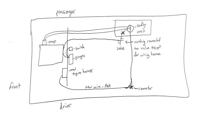

I've tried that, with no luck. I've attached a crude drawing of the current setup/connections.
Tuesday, January 18th, 2022 AT 2:53 PM
  • 109,755 POSTS
Take a look at pic 1. Is that how it is set up? Looking at your pic, it should work. Are you getting a voltage signal to the sending unit? Is there 12v direct to the gauge separate from the 12v from the sender? You have an X after the switch. What does that mean?
Tuesday, January 18th, 2022 AT 3:56 PM
TWEBB101
  • 178 POSTS

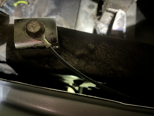

Yes, the sending unit has a ground cable that is connected to bare metal on the frame. The gauge is grounded through the printed circuit board/wiring harness. The X in my drawing is where the new wire connects to the old "pigtail" wire that goes across the frame to the sending unit.

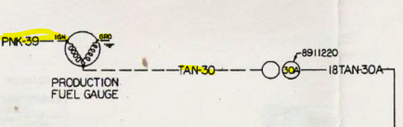

  • 109,755 POSTS

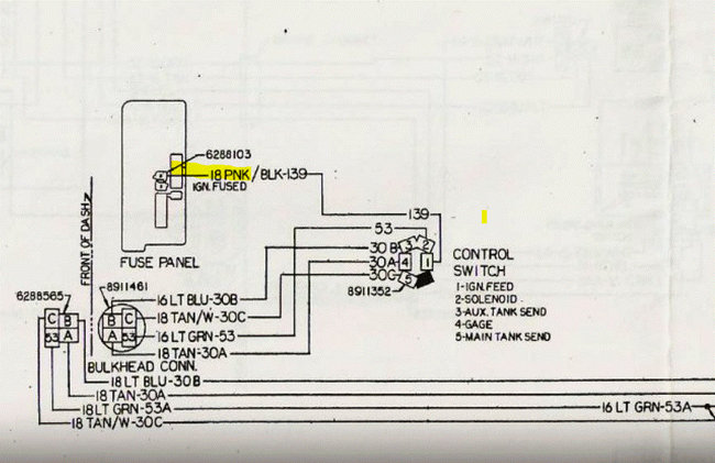

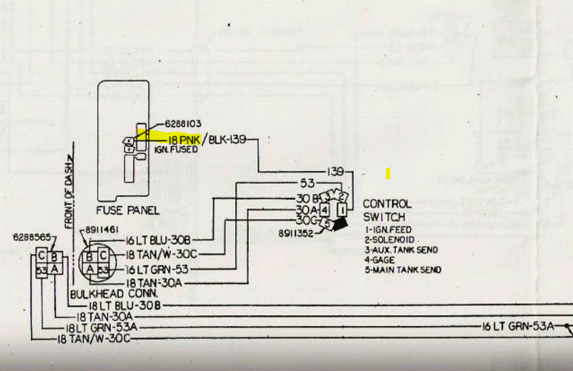

Please bear with me. I'm trying to decipher what they are saying in the above pic.
Do me a favor. Take a look below. I was able to find an old schematic. It is for the dual tank set up. I don't see why you wouldn't be able to bypass the tank switch (pink wire) between the two, sender/gauge.
Let me know your thoughts.
See pics.
Tuesday, January 18th, 2022 AT 6:26 PM

No go. I ran a brand-new wire from the sending unit in the tank, to the brand-new pink wire from the engine harness, and now instead of reading 3 o’clock, we are back to reading at E. If I unhook it, it goes back to 3 o’clock. I verified that I have 12 V at the instrument cluster where the gauge plugs in, and I unplugged and re-seated the instrument cluster harness. No luck.
At this point the selector valve is completely bypassed. I checked all my grounds as well, and they are all in clean bare metal. I’m at a complete loss.

If you have power to the sender and ground, it should work the same. Is there a ground issue?
