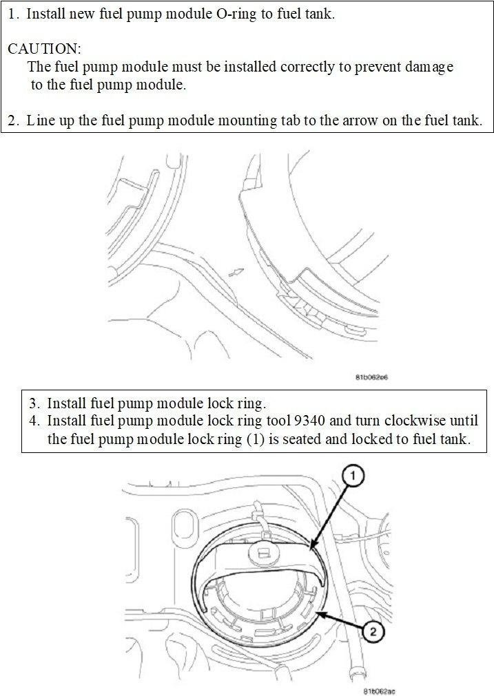

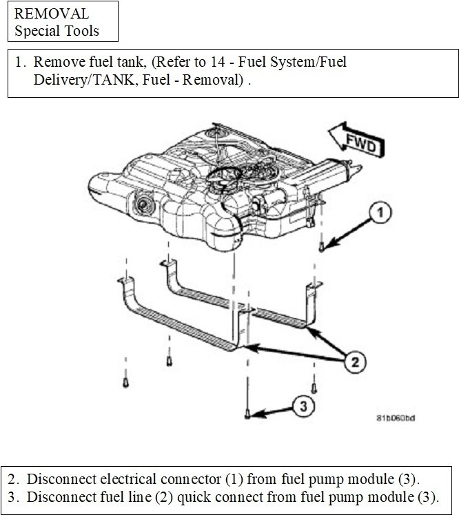

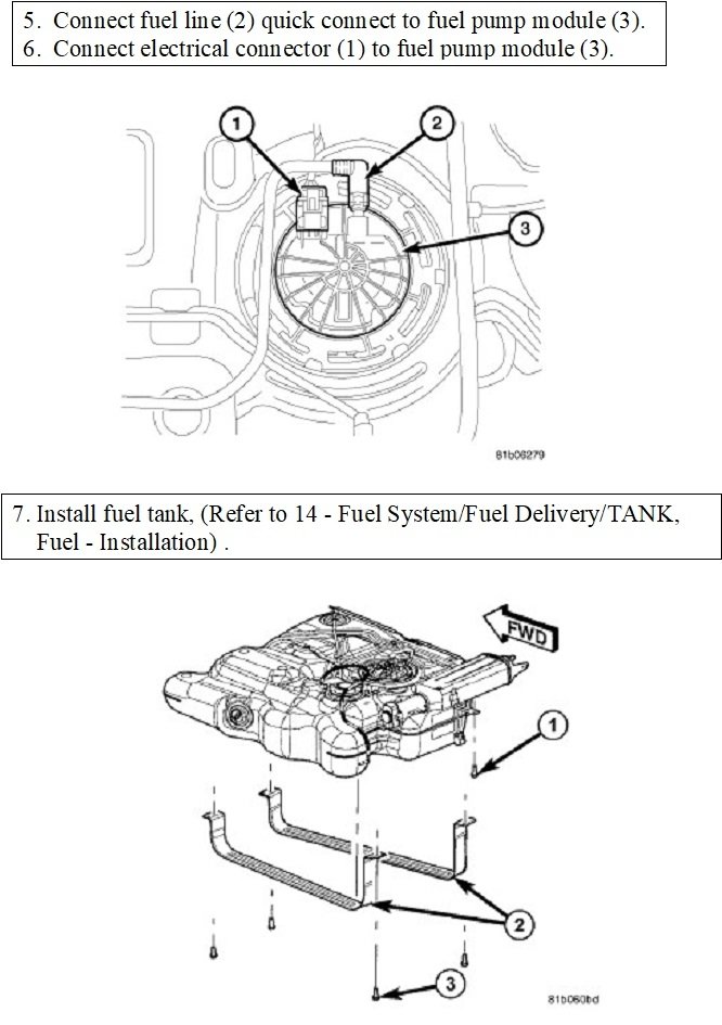

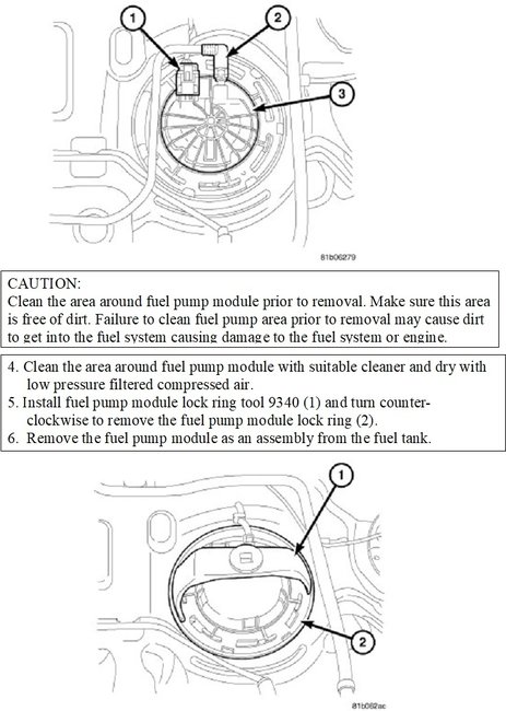

I am trying to find my fuel filter and I also need a diagram on where to find it.
Jun 4, 2022 at 12:08 AM
CARADIODOC
  • 34,366 POSTS

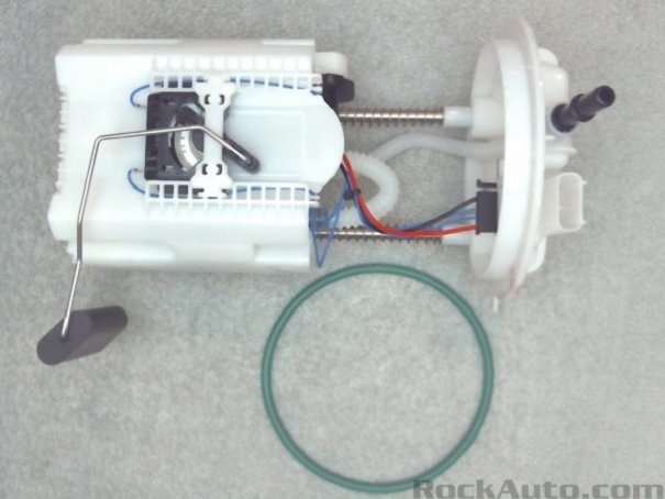

Other than for diesel engines, you'll never solve an engine running problem on a Chrysler vehicle by replacing the fuel filter. They commonly last the life of the vehicle unless they rust out and start leaking. Now, since it doesn't pay to replace it, the fuel filter has been made part of the fuel pump assembly inside the gas tank. If you need it, here's the removal and installation instructions. Please let me know if that is sufficient or if I can add anything.
