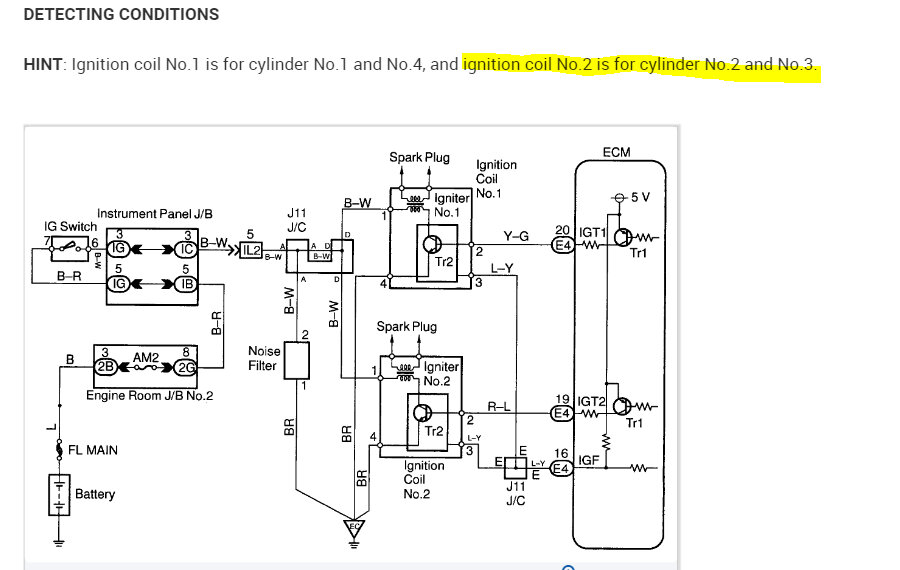

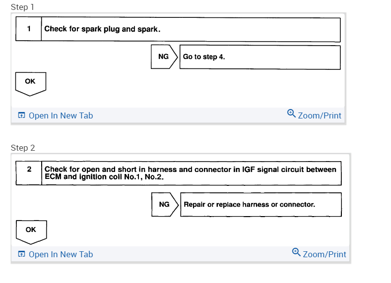

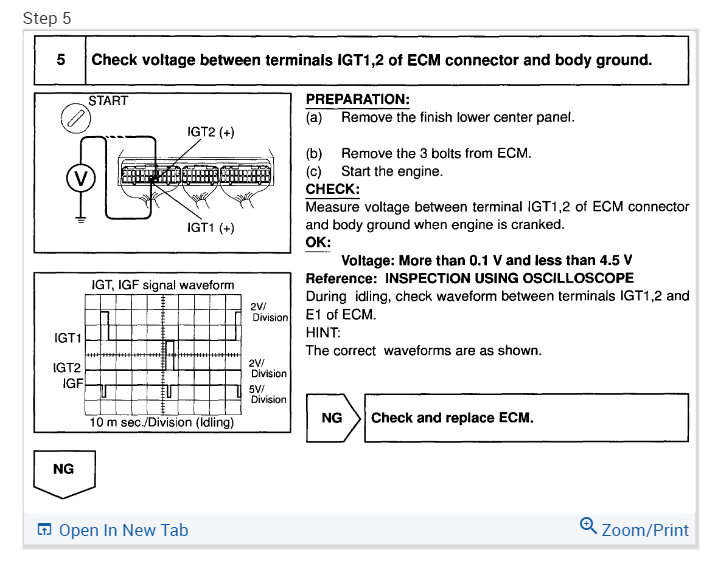

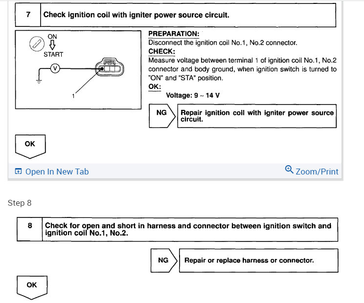

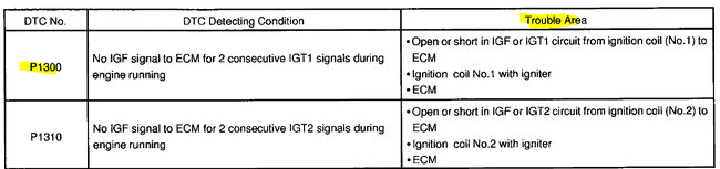

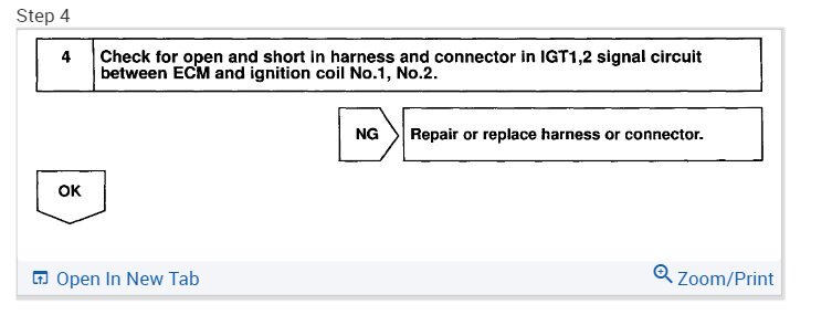

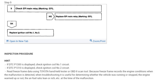

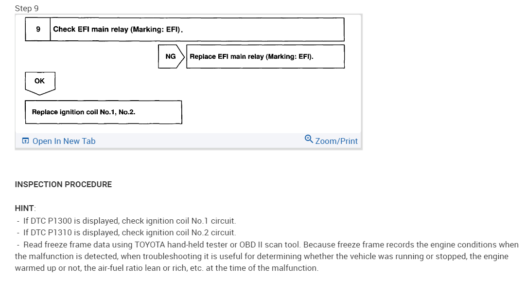

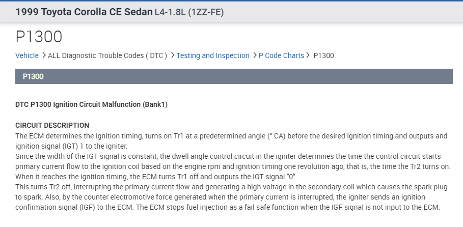

I attached the diagnostics below for the P1300. Take a look through them and let me know what you find. Note that cylinders 1 and 3 work in tandem, so if one is having an issue, the other will as well.
Also, are you certain there is no spark on 1 and 3? If there isn't, there has to be a misfire.

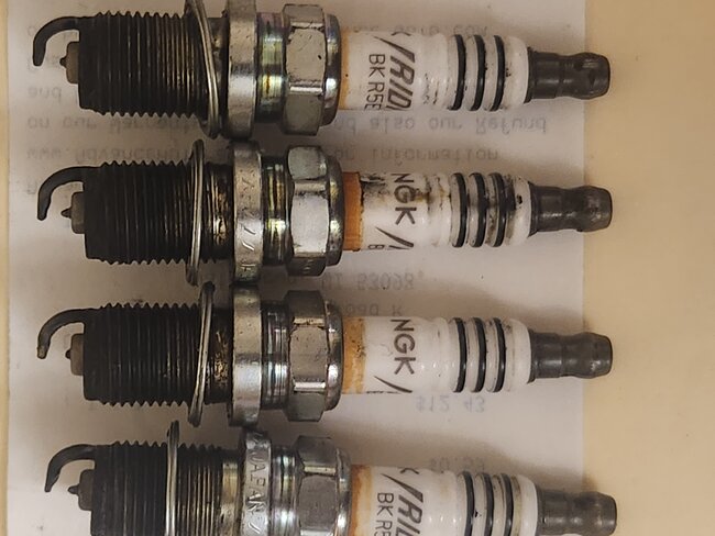

No, there's spark on all 4. I was saying that if I lift the spark plug boot up while the car is running the spark arcs from the boot to the spark plug well. I didn't think it was supposed to do this if the boots were good. Anyway, I went back to basics. The compression test revealed 170-175 all cylinders. Two of the fairly new NGK iridium plugs I just put in had the electrodes almost all the way worn down and two looked good. I think they may have been Ebay knock offs. I replaced all four with legitimate NGK standard V-groove gapped at.044. The only code I'm getting is PO125, but I don't think the ECT is bad. What I think is the ECM isn't receiving the reading from the ECT. What this means and how to check it I don't know. Did you see the resistance readings I listed coming out of the ECT? Also, I am wondering about a plugged Cat because there's a strong sulfur smell after driving it full throttle and shutting off. The smell seems to be more under the front of the car not out the tailpipe. By the way, for as rich as it's running the color on all 4 plugs looked ok. I'm ready to just try an ECM. It's only $20. Short of that I'm very close to paying a tech to diagnose it. I also pulled the injectors and cleaned the throttle body, which wasn't that dirty.

The P1300 is no longer present? As far as the sulfur smell is concerned, it is usually related to the catalytic converters.
When you say the electrodes were nearly worn off two of the plugs, which cylinders? Were they cylinders 1 and 3? Also, it is normal for the spark to arc to a ground. If it was coming through the side of the boot, that is a different story.

Correct, the P1300 code is gone. The only one coming up right away is PO125. I tested the ECT against a new one and basically got the same numbers. I put the old one (Toyota) back in. The coolant temp is 190-200 so I know it's not that. Is there a way to check the ECT reading at the ECM? I also spoke to a Denso tech, and he informed me that because they make the O2 sensor for Toyota they cannot put their aftermarket part number or name on their aftermarket part, but it is the same specs as the Toyota sensor. The voltage from sensor 2 should be less than. 5V but it's reading.95-1.0V due to the rich fuel program. Wouldn't a bad Cat set off its own code? I'm not quite ready to give up yet. Lol #Hardheaded #Determined I've included a photo of the plugs where you can see the worn electrodes. Unfortunately, I'm not sure which cylinders were worn. But I think #1 was the first plug I pulled and noticed it. They are not shown in any particular order. Isn't one coil for #1, #4 and the other coil for #2, #3?

What do you mean #1 and #3 work in tandem?
Tuesday, November 14th, 2023 AT 9:47 PM
  • 109,917 POSTS
The same coil is used for the two different cylinders.
Wednesday, November 15th, 2023 AT 7:17 PM
JEFF HERMAN
  • 453 POSTS
Isn't it 1, 4 on one and 2, 3 on the other?
Wednesday, November 15th, 2023 AT 7:31 PM
  • 109,917 POSTS
Yes, you are correct. Sorry about that. I messed up. At this point in the day, I have 18 hours in. The old eyes must have missed the mistake. I need to be more careful. LOL

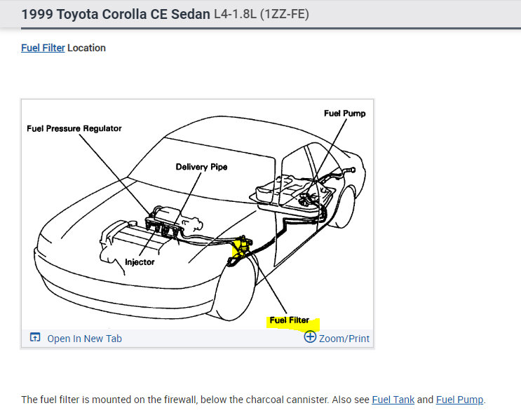

What about a partially plugged fuel filter even though there's no performance loss? Is the filter for this car on the pump in the tank? I'm finding conflicting information, but I don't see one inline. Also why is my sending unit so slow to respond to adding fuel? I just want to try everything before jumping to the ECM. If live data shows 87-90 degrees C does that mean the ECT is working and sending the information to the ECM? I'm thinking the tips of 2 of the iridium plugs wore down so quickly due to the lean condition. What do you think?

Yes, a lean mixture will burn hotter and cause damage to the spark plugs, but I would think all of them would have been damaged.
As far as the fuel filter is concerned, it is at the firewall and below the charcoal canister. See pic below.
Low fuel pressure certainly can be caused by a restricted fuel filter, but the only way to confirm that is via a fuel pressure test.

I know that's where there's supposed to be a filter but there isn't.
Friday, November 17th, 2023 AT 10:55 PM
  • 109,917 POSTS
I double checked and that is the only place it is showing one. Does it appear that one may have been there at one time?
