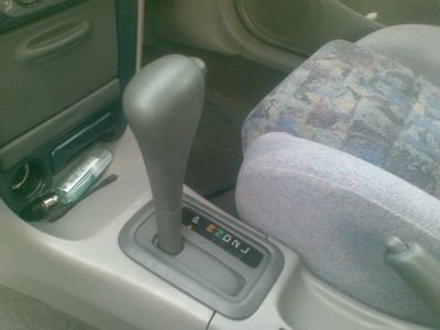

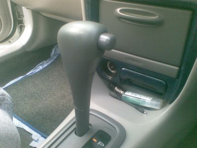

I have checked in my car there is no any O/D button or Option, so what does it mean,and i checked fluid level its ok but i change rack position of steering but still not enough good. any way i send u some pictures of car check it and please let me know about O/D.
Thakns
waiting for your quick response

Have transmission checked, it should have a TCC (torque convertor clutch) lockup. This will lock the convertor at certain speeds, if malfunctioning, it will cause RPM to rise 300-600 rpm and your mileage will suffer.
