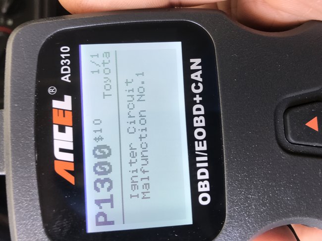

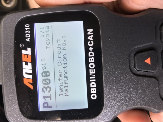

Joe, thanks for the reply and info. The code reader I have didn’t give a specific code number. It said on the screen “igniter circuit malfunction no. 1” after it had me choose the make and model of vehicle. I unhooked the battery and had couldn’t work on the car for a few days and when I came back this morning there were no codes stored. I’m going to let it sit for a while and see if it recovers anything.
Dec 29, 2020 at 1:17 AM (Merged)
DAKOTA.FOWLER
  • 5 POSTS
Update: I tried updating the comments but it’s not saving. The code reader says P1300. I’m on my way to the part store to grab a test light.

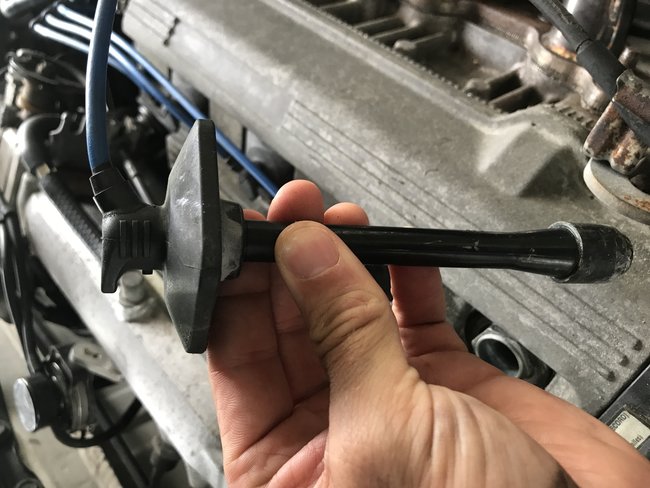

Update: I picked up the test light. Tested cylinders number 1 and 2 and got no light when my wife tried to start it. This is what I tested.
  • 110,248 POSTS

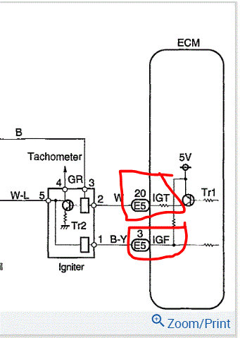

The code indicates no IGF signal to the ECM. Basically, there is no spark. The IGF signal is communicated with the ECM to indicate a spark has occurred. We have one of two problems. Either we are not getting a signal from the ECM to the coil to create a spark or the coil is bad.
I see the pic above is the spark plug wire. How did you test that?
The way this needs checked is this. We need to determine if there is a signal to the coil and a response back via the IGF signal. I attached a pic below. At the coil, disconnect the electrical connector You will need a multi meter to test for power. Also, the power will only exist when the engine is being cranked and will not be constant. It will power on and off.
Okay, at the connector, there is a white wire (IGT) that sends signal to the coil to fire. There is a blue wire with a yellow tracer that returns signal to the ECM indicating there was spark.
Test one at a time. It will not be more than 5v, but you should see a signal as you have a helper crank the engine. You will need to back probe the wires because they need to be connected on the coil when testing.
If there is signal from the white wire, replace the coil. If there is no signal, we need to work back to the ECM to see if there is an open circuit or a connection issue.
Since you said it starts somewhat with starting fluid, I have a feeling the coil is bad and not producing a strong enough spark to burn fuel. However, this is the only way I know to confirm.
