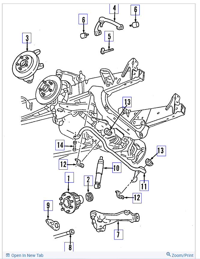

My front driver side tire has a lot more wear on the inner section more so than the rest of the tire. I'm assuming it's from a negative camber. My question is, what is causing this? When I reverse uphill and turn the wheel towards the left, I notice a non persistent clicking noise, also a slight bounce. Sometimes when I hit a bump my steering wheel goes left and right like crazy. How can I tell if it's the ti rod or the control arms or the struts or what could it be? I don't want to get ripped off at a shop and if I could get an idea of the problem I will be able to fix this problem before I get a new set of tires and alignment. Thank you! I'm from Denver by the way!

I suspect you have a couple issues. First the inner tire wear is most likely a camber issue that is more then likely caused by the upper control arm. The noise could be a bearing issue or possibly an axle shaft. The steering going crazy is most likely related to the control arm and ball joint.
Then again, it could all be attributed to the ball joints so I would start there.

According to this diagram, your truck uses the SLA suspension system, so the vehicle design should not be an issue with accelerated tire wear. Keep in mind that with sagged ride height, camber can still be set to specs on the alignment rack, but the geometric relationship between the control arms and spindle will be drastically different. This is where you will have greatly increased tire wear even though the alignment appears to be perfect. This wasn't a problem at the dealership when working on vehicles only a few years old, but trade-ins were often old enough to come in with sagged springs. Fortunately the owner where I was the alignment specialist understood this issue and allowed me to replace sagged springs before doing the alignment.
