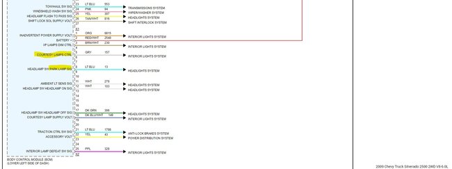

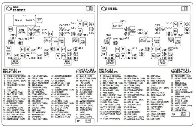

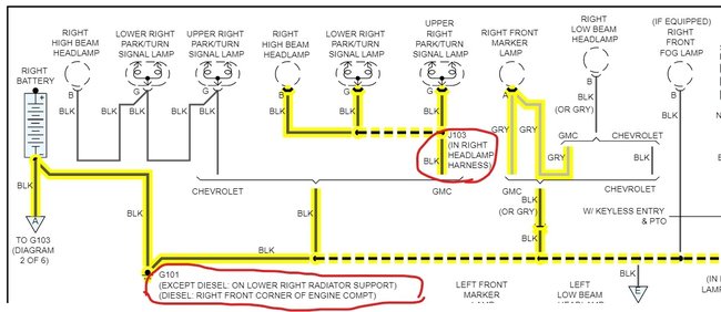

The truck listed above is 2500. Everything was fine. I drove home from work. No lights were on when parked. When I let the dogs out around 9:30pm the front passenger marker light was on and couldn’t get it to turn off. Drained the battery. I changed all bulbs and fuses are good. Any help would be really appreciated a lot!!
Feb 27, 2022 at 9:57 AM
WENDY W
  • 86 POSTS

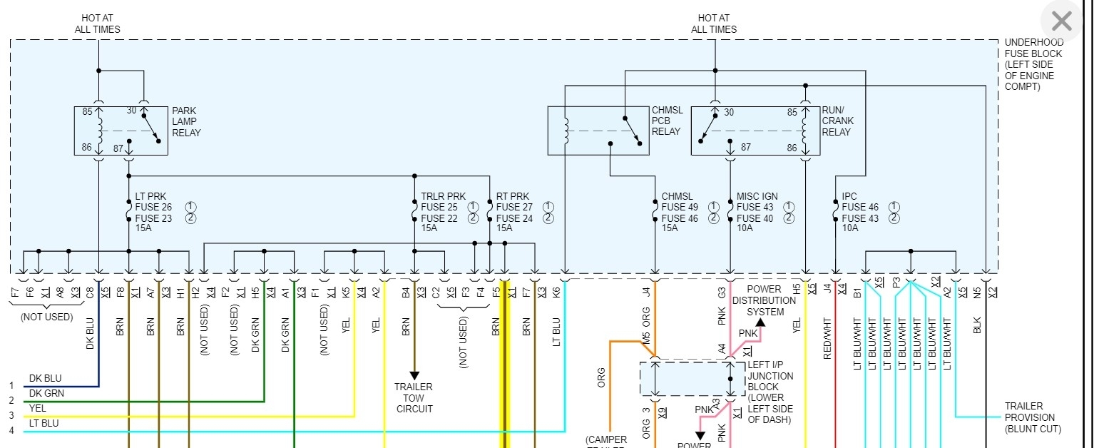

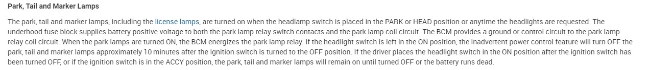

Hello!

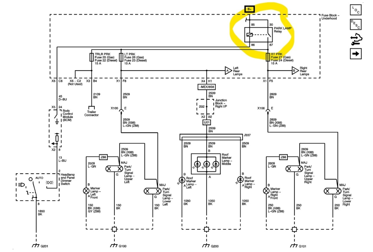

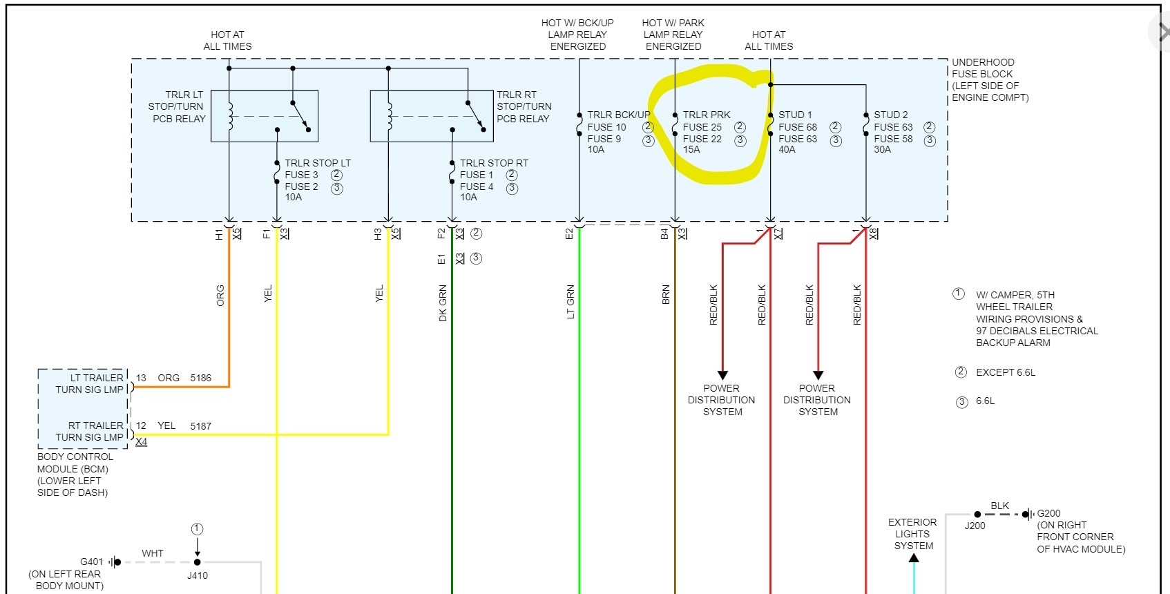

It sounds like the park lamp relay in the under-hood fuse block may be malfunctioning. Please check out the diagram (below). These repair guides may help you track down the fault:

I'm curious, if you pull the right parking light fuse, are you still getting power at the passenger side front marker lamp?
Has the vehicle been in an accident or had any other repairs recently, or is there aftermarket trailer wiring?

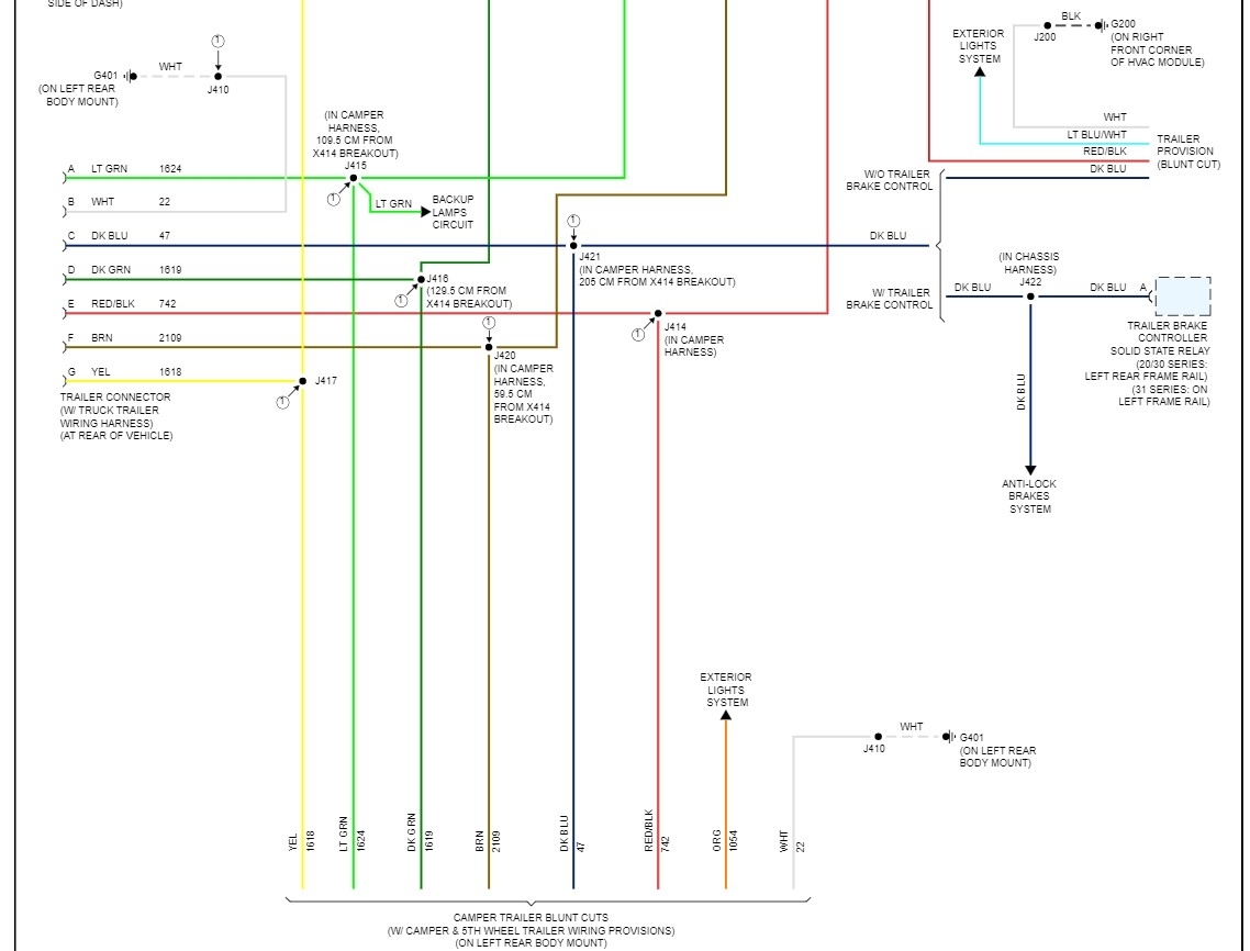

When you wiggle the harness, nothing happens, they look good I took out both light assembly’s yesterday and it looked good. Could it have something to do with the trailer wiring? Just a question. I haven’t tried pulling that fuse yet just to see what happens.

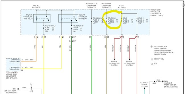

Yes, it's possible there could be a short in the trailer wiring harness. I've attached those schematics for you (below).

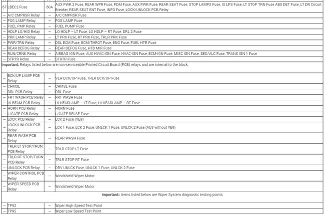

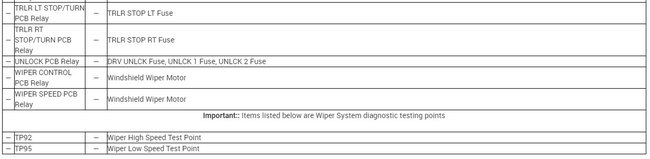

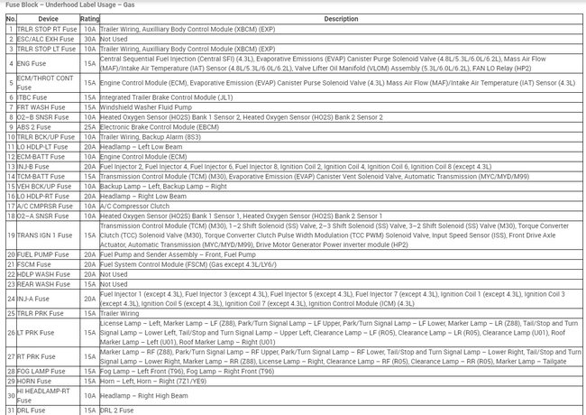

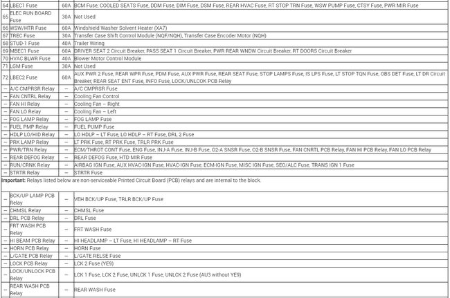

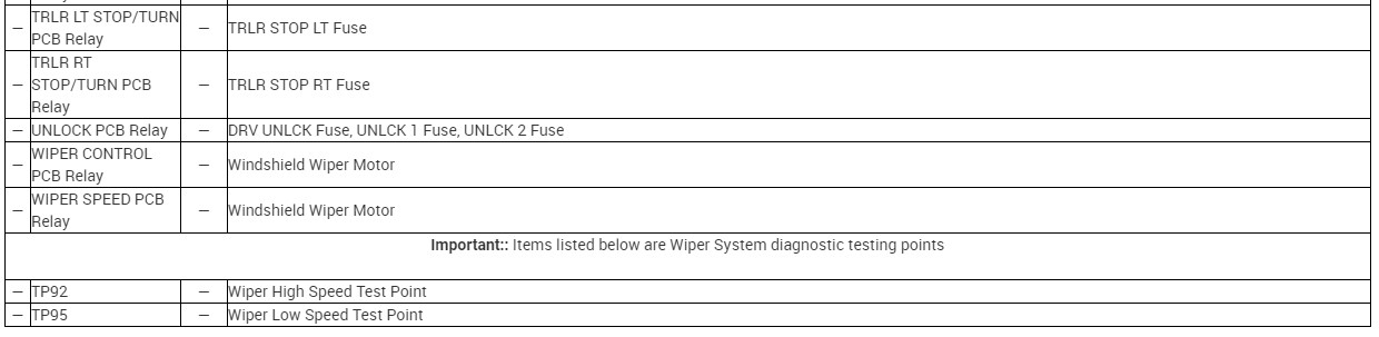

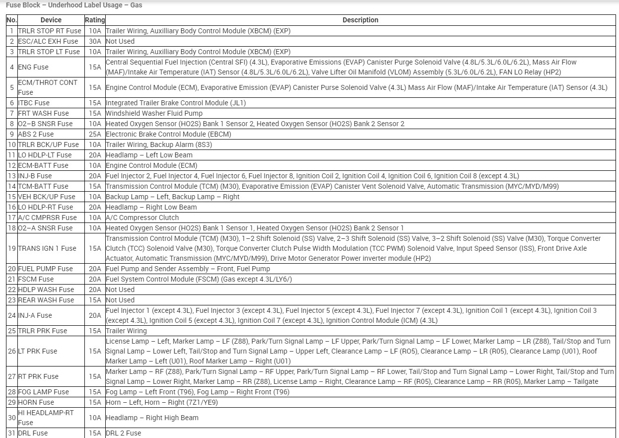

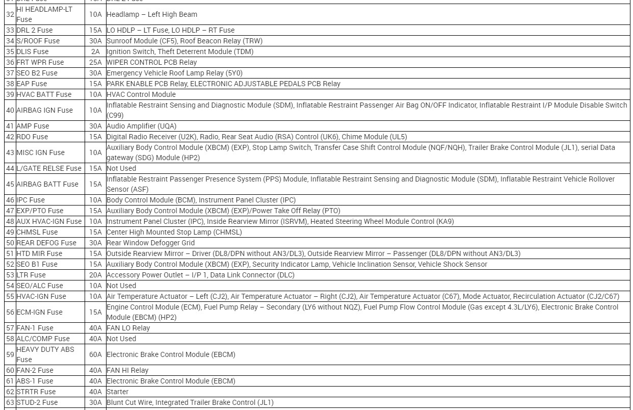

With the key on, are the rest of the exterior lights functioning properly?
Has the vehicle set any OBD II codes that you know of?

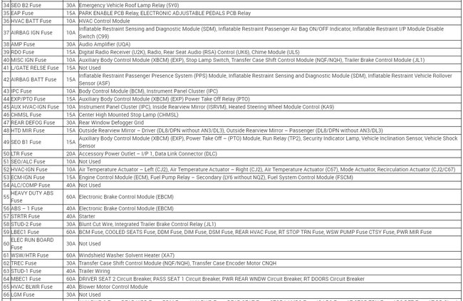

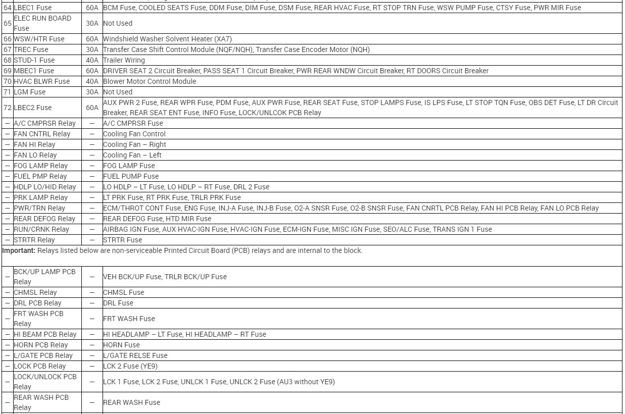

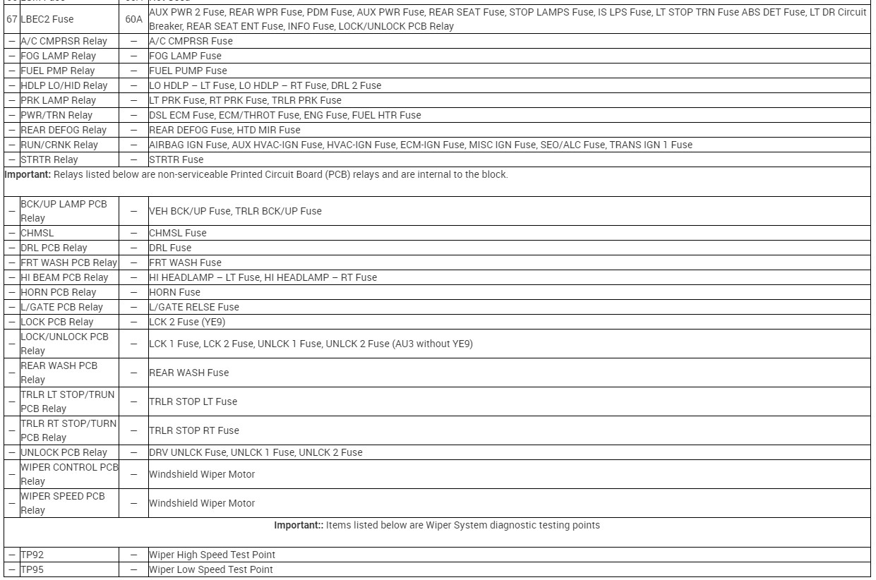

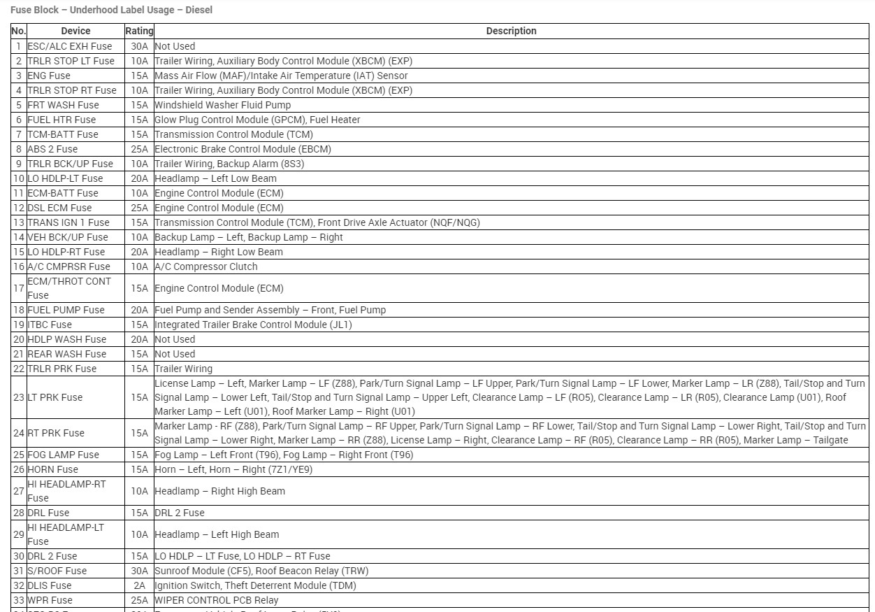

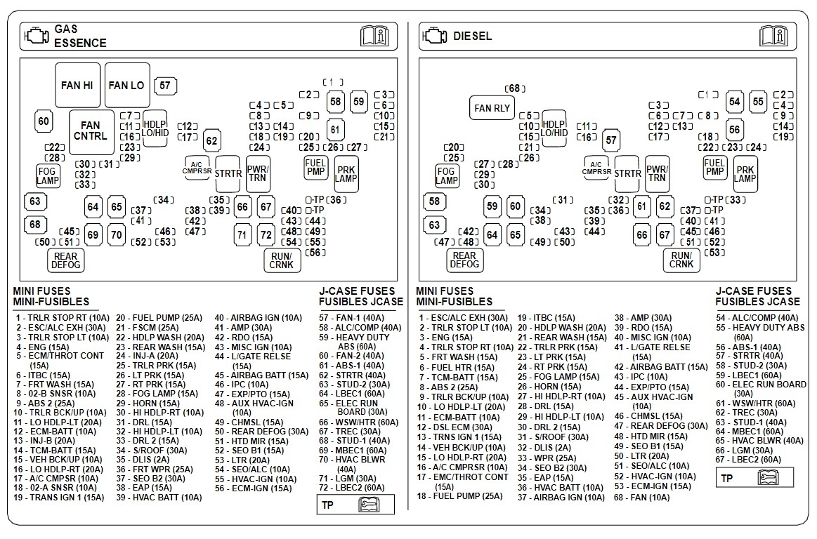

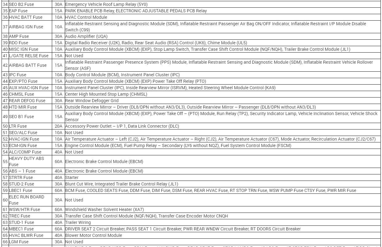

If the circuit is cross-feeding with another circuit, you may be able to remove fuses, one at a time, to see if the light goes out. That might help narrow down which circuits are involved. I've attached detailed descriptions of the under-hood fuse block so you can see which ones involve the exterior lights.
Please let me know what you find, Wendy W.

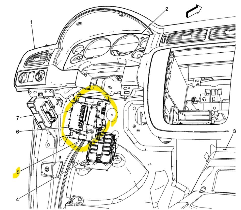

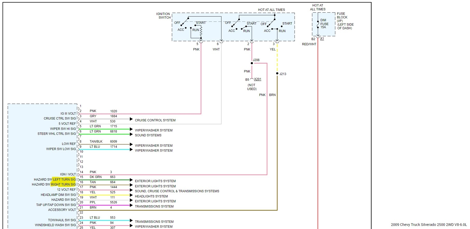

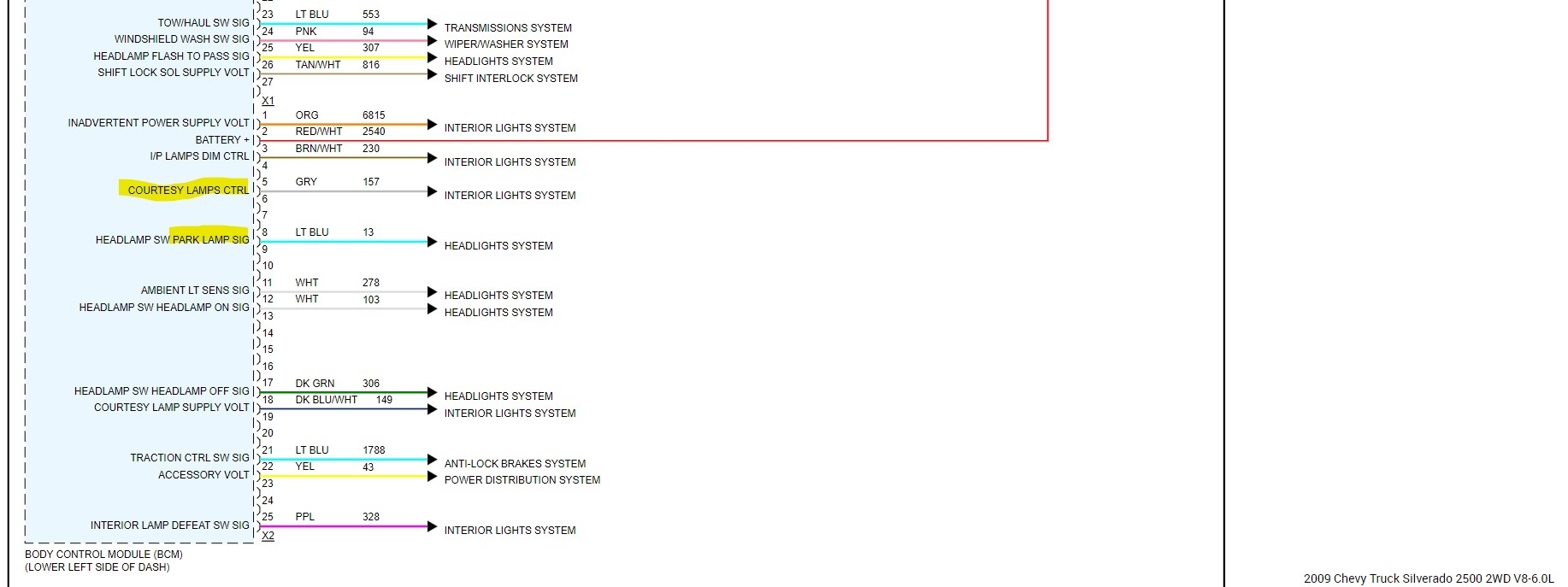

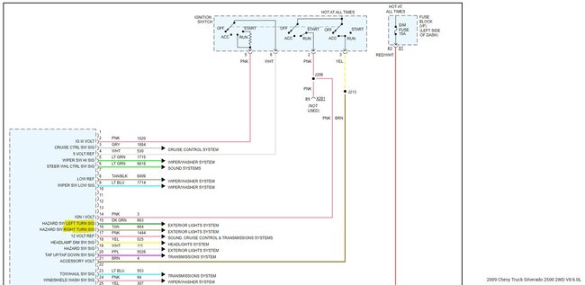

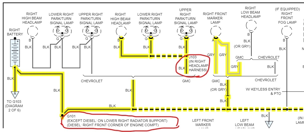

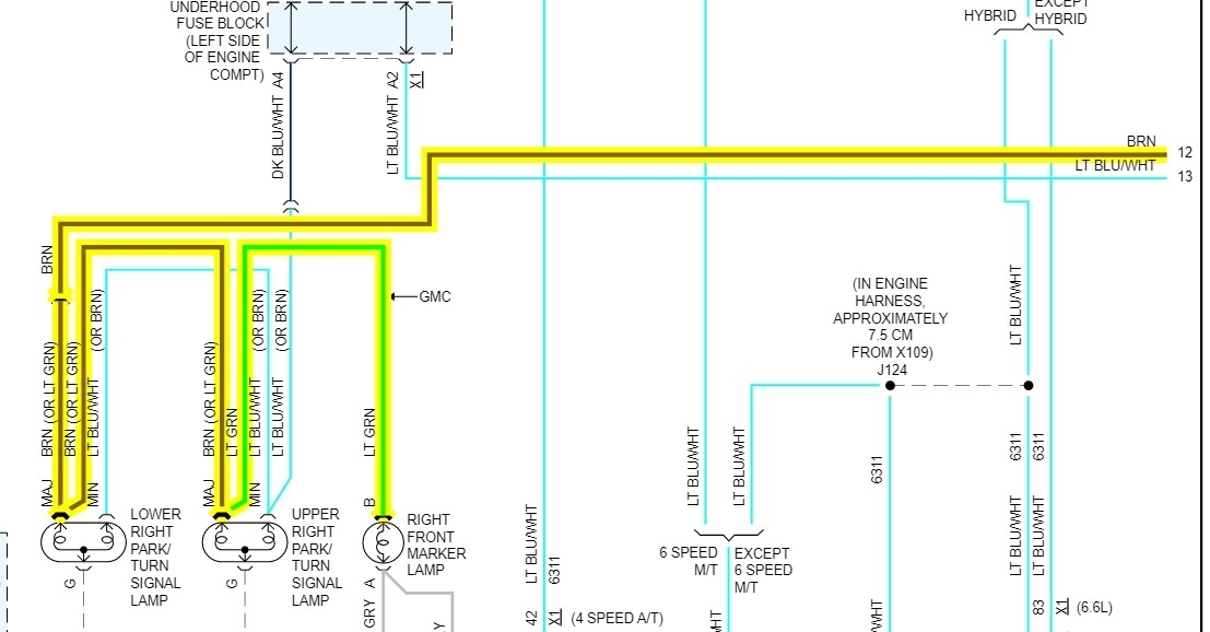

There are two grounds in the exterior lighting wiring harness that you might want to check. They're circled in red on the schematic below.

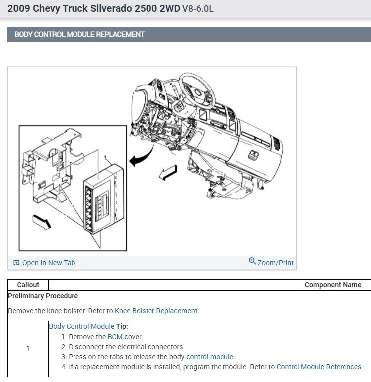

Another possibility is that there is a fault in the BCM (body control module). Please see the schematic below. Notice that the courtesy light, turn signal, and parking lamps all communicate with the BCM. Please note that the negative battery cable should be disconnected before unplugging the BCM to avoid possible damage to the unit.
Here's a repair guide on what to expect when replacing a BCM:
https://www.2carpros.com/articles/how-to-replace-a-bcm-body-control-module
If you need any further information, please let me know.
Thanks! Wendy W.
