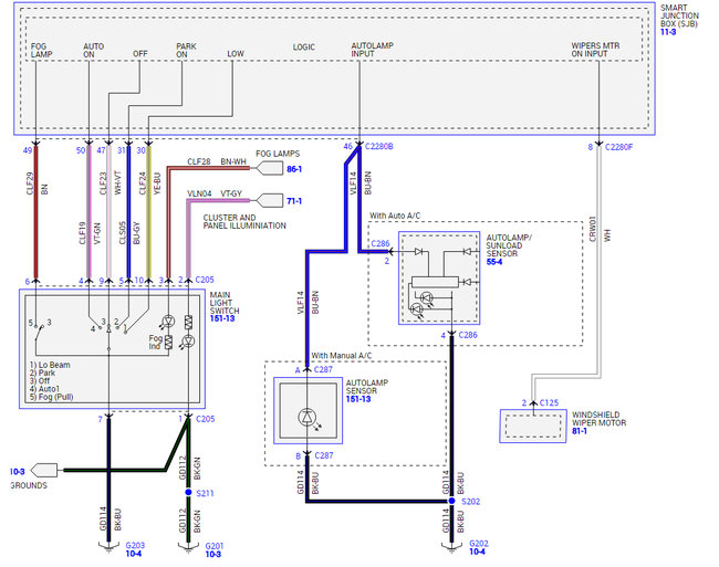

I have attached the headlight harness for your reference.
Please let me know if you need any other info.
Friday, August 13th, 2021 AT 8:12 AM
MORGAN8173
  • 69 POSTS
Thank you. So I can understand that yellow and violet is going to be the ground wire right. I can’t make out what the other colors are per the diagram.
So 1. Yellow and violet (2) middle wire (3) 3rd wire color.
Friday, August 13th, 2021 AT 8:18 AM

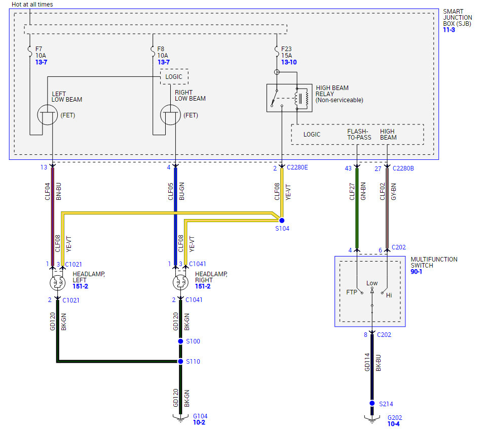

My apologies, I think I sent you wrong diagram. Look below of the correct one. This will make more sense.

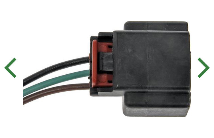

So I attached a picture of the harness I bought it’s a Dorman for H13.
1) blank wire, which color wire?
2) green wire.
3) brown wire.
So I have a green/black wire, yellow/violet wire, green and some other color maybe yellow I could make out. Can you tell me what color goes to what wire? I don’t understand these diagrams.

MORGAN8173
  • 69 POSTS
Sorry, I typically take pic of these things before cutting wire but it’s tight quarters in that area and with the connector being burnt between that and pulling it off the wire pulled out of the connector leaving me in this position.

If you are looking at directly into the socket with the clip side at the top. The left wire is the low beam which needs to attach with the factory harness that is blue/green. The center one is ground which will attach with the factory harness that is black/green.
And the last one is the high beam needs to attach with yellow/violet.
Hope this helps.
Thanks.
Friday, August 13th, 2021 AT 10:10 AM
MORGAN8173
  • 69 POSTS
Thank you for your help, I now have working headlight. So I had the true ground wire all along connected to the black wire on that connector dumb me not thinking it’s a after marker that black wire is nothing more than a black wire nothing different than the other two. I just couldn’t understand why it wasn’t working. So thank you. Hey, in the meantime I literally soldered tons of wires hoping that was it. Because I just knew it wasn’t that headlight.
