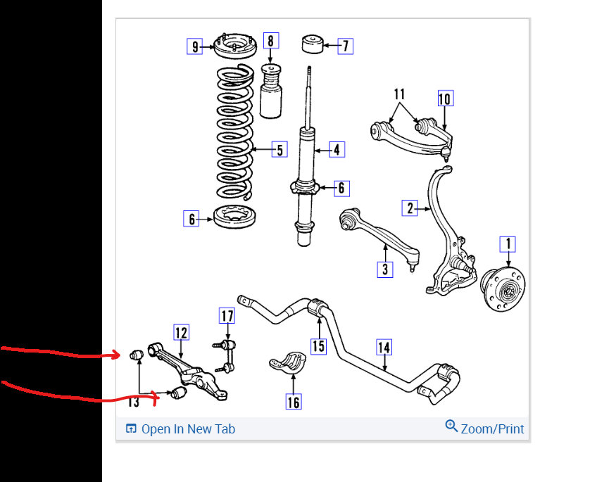

Yep, that is a noisy one, thanks for the video. Can you tell front or rear of the car because it sounds like a strut has come apart internally. Did it make noise before you replace the struts or after? if after you have a defective strut. Also use a flashlight to check the lower control arm bushings. Check out the images (below). Please let us know what happens.

When you did the struts did you do the strut mounts as well? # 9 in the photo.

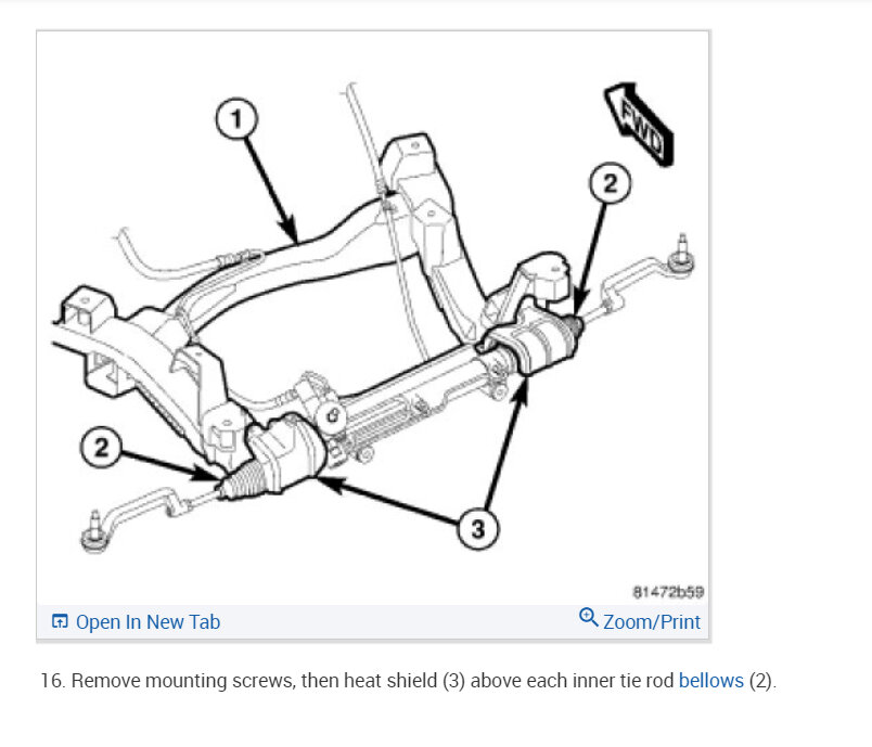

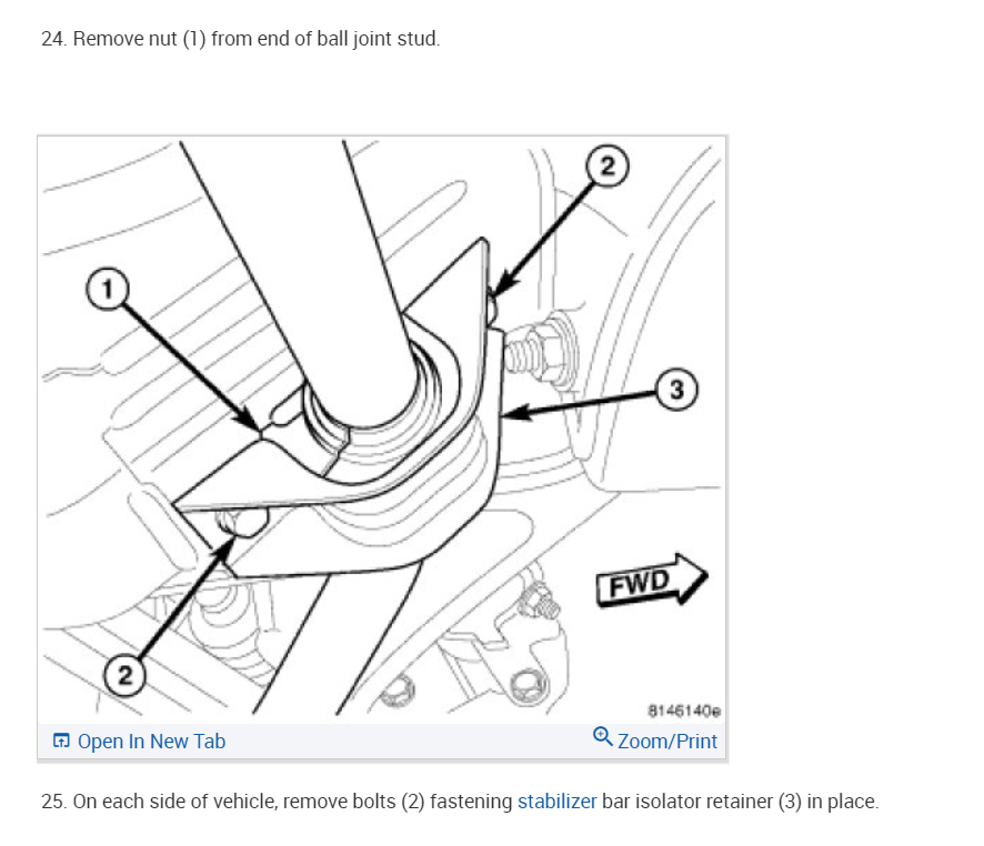

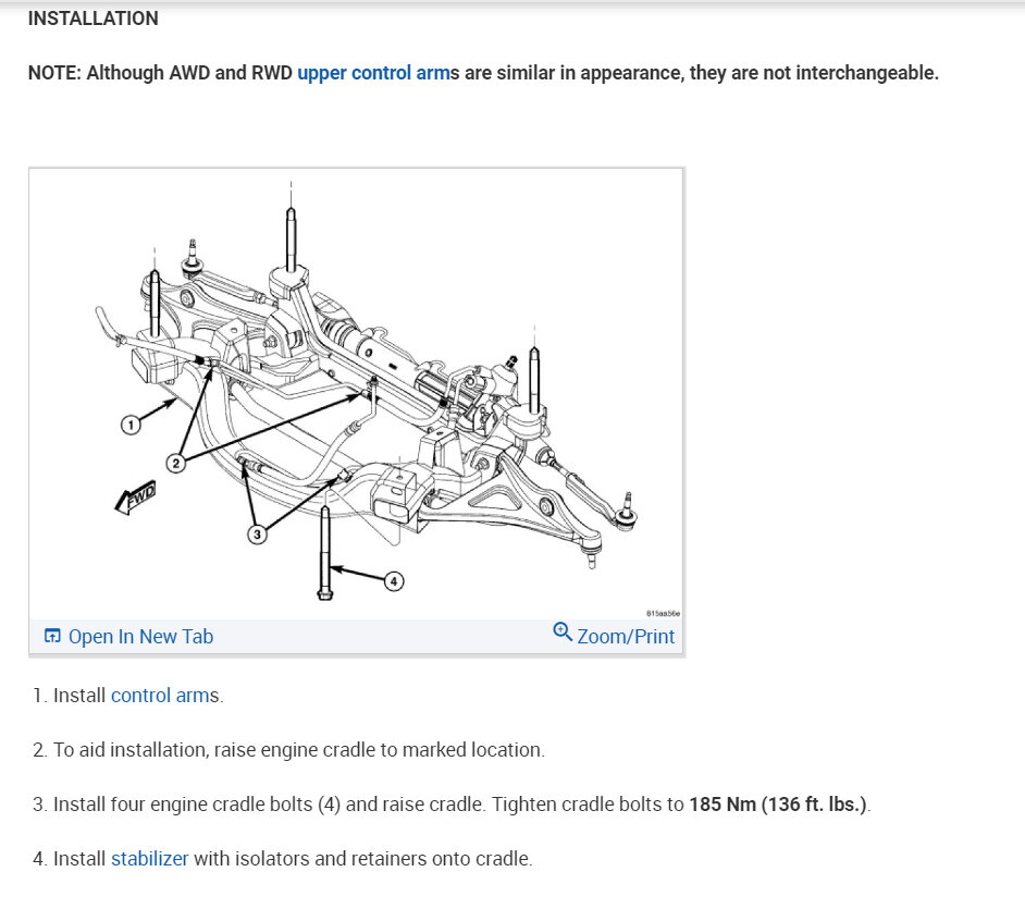

  • 55,781 POSTS
I had a thought, it could be the cradle bolts either loose or need replacing. Here are the mounts so you can check them out. also looks at the sway bar frame mounts to make sure they are okay. Check out the images (below). Please let us know what happens.
