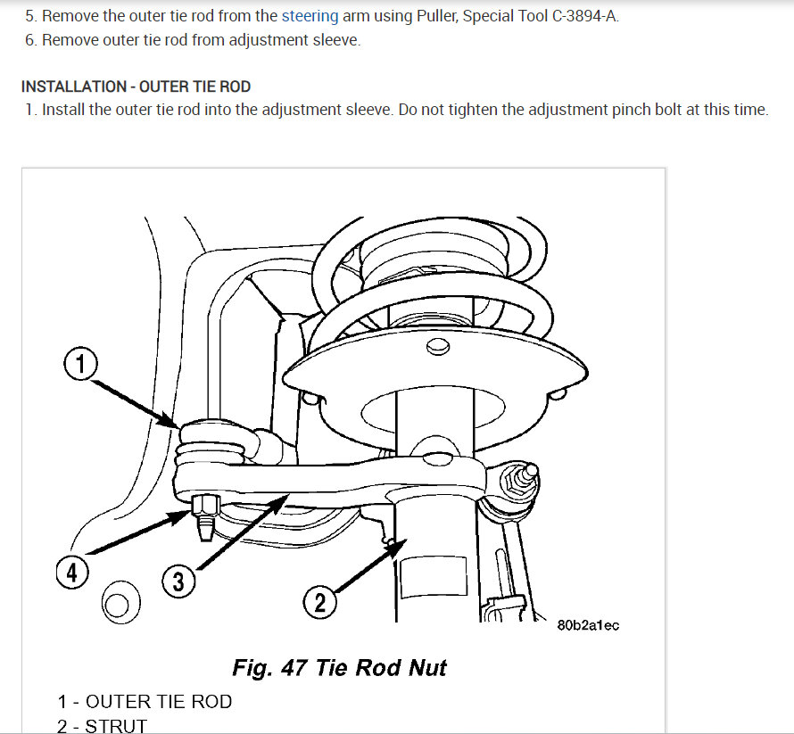

Front end shimmy's between 55-65 mph on the highway... doesn't always do this? When I apply the brakes to slow down and stop the shimmy it gets worse. Steering wheel shakes during the shimmy.
Feb 28, 2015 at 2:04 AM
HMAC300
  • 48,601 POSTS

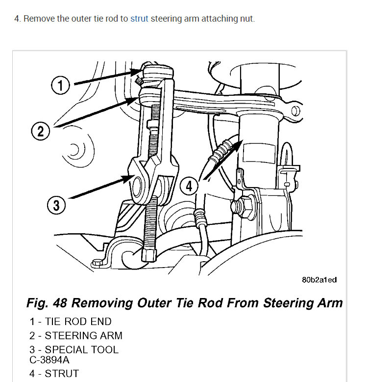

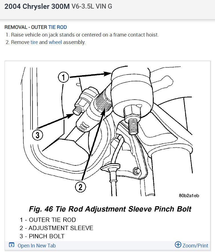

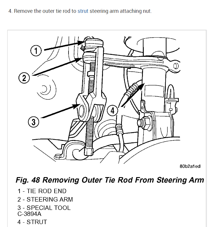

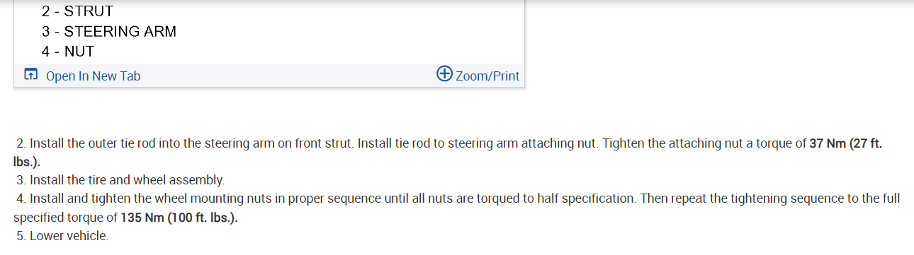

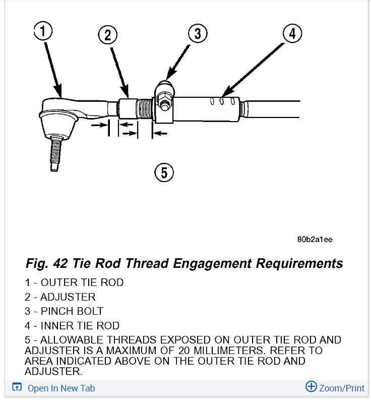

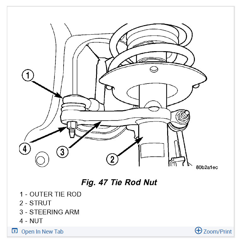

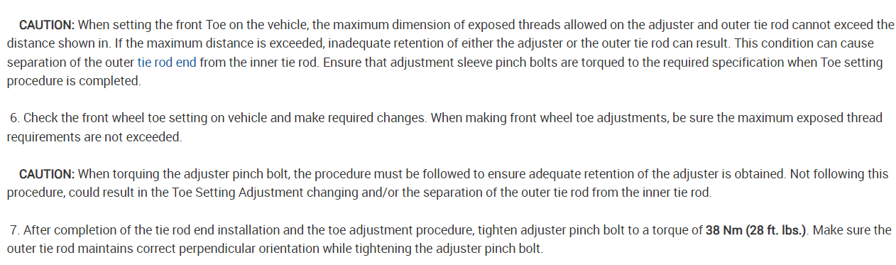

The shimmy is caused by tire balance or the tie rod ends are worn out, here is a guide to help see what's going on and I have included how to change out the tie rod ends as well.
https://www.2carpros.com/articles/steering-wheel-shakes-when-accelerating-or-braking
Check out the images (below). Let us know how it goes
