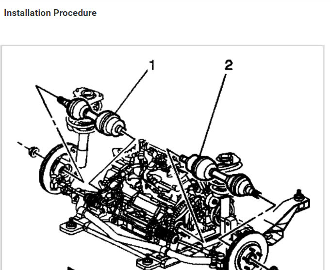

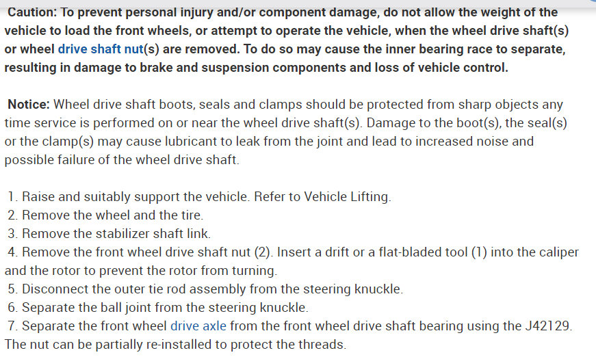

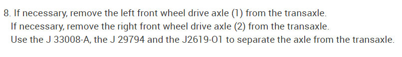

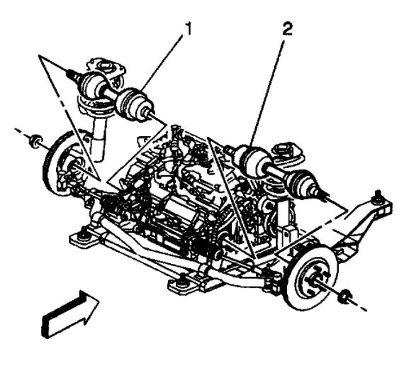

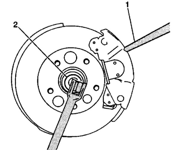

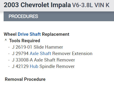

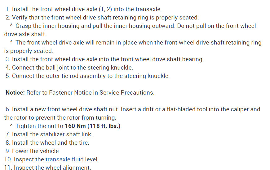

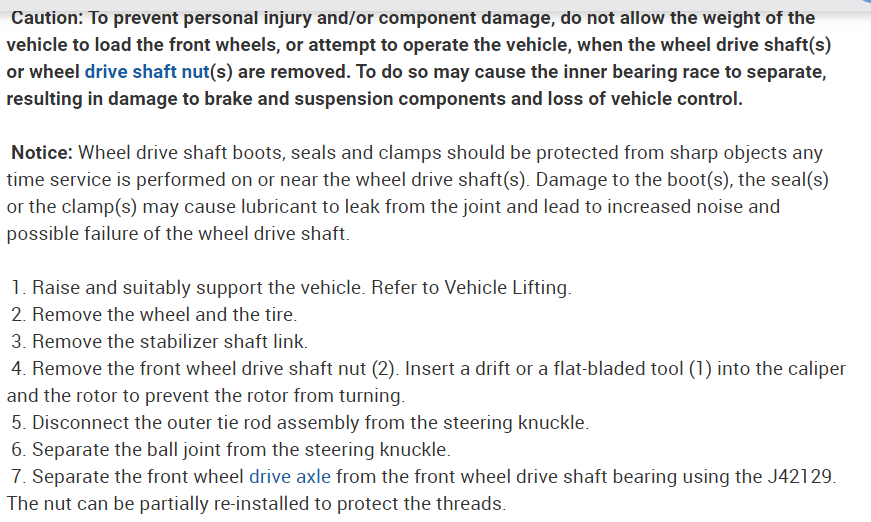

Usually what we ask people to do is use their cell phone to make a video of the sound and upload it here. It sounds like you might be having an issue with the CV-drive axle. When CV-drive axles are failing that is when you hear clicking or popping sounds from the front end when turning. Here is a tutorial showing what is involved in its replacement:
https://www.2carpros.com/articles/replace-cv-axle
I've attached CV-axle replacement picture steps below for your car. I would suggest making a video and uploading here for us first before just replacing. Get back to us and we'll go from there. Hope this helps and thanks for using 2CarPros.
