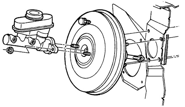

Was getting brake pad sticking/seizing on driver front disc brake. Replaced brake caliper as caliper bushing was shot and thought piston was sticking. Replaced brake line from master cylinder to caliper as there was no indication of pressure at bleed screw but was from metal line at top of rubber hose. Now vehicle has no pressure and can lock front right tire up when pressing brakes hard enough but driver front continues to role. What is wrong!? I have spent $100.00 already trying to figure this out. :(

Based on your description, it sounds like the master cylinder may be bad. This unit is a tandem master cylinder. The primary (rear) circuit feeds right front and left rear brakes. The secondary circuit (front) feeds left front and right rear brakes. What I need you to check is if the if the right rear brake is working. It sounds like the secondary circuit of the master cylinder may have failed. Check to see if there is pressure to the right rear brake. If there is not, replace the master cylinder.

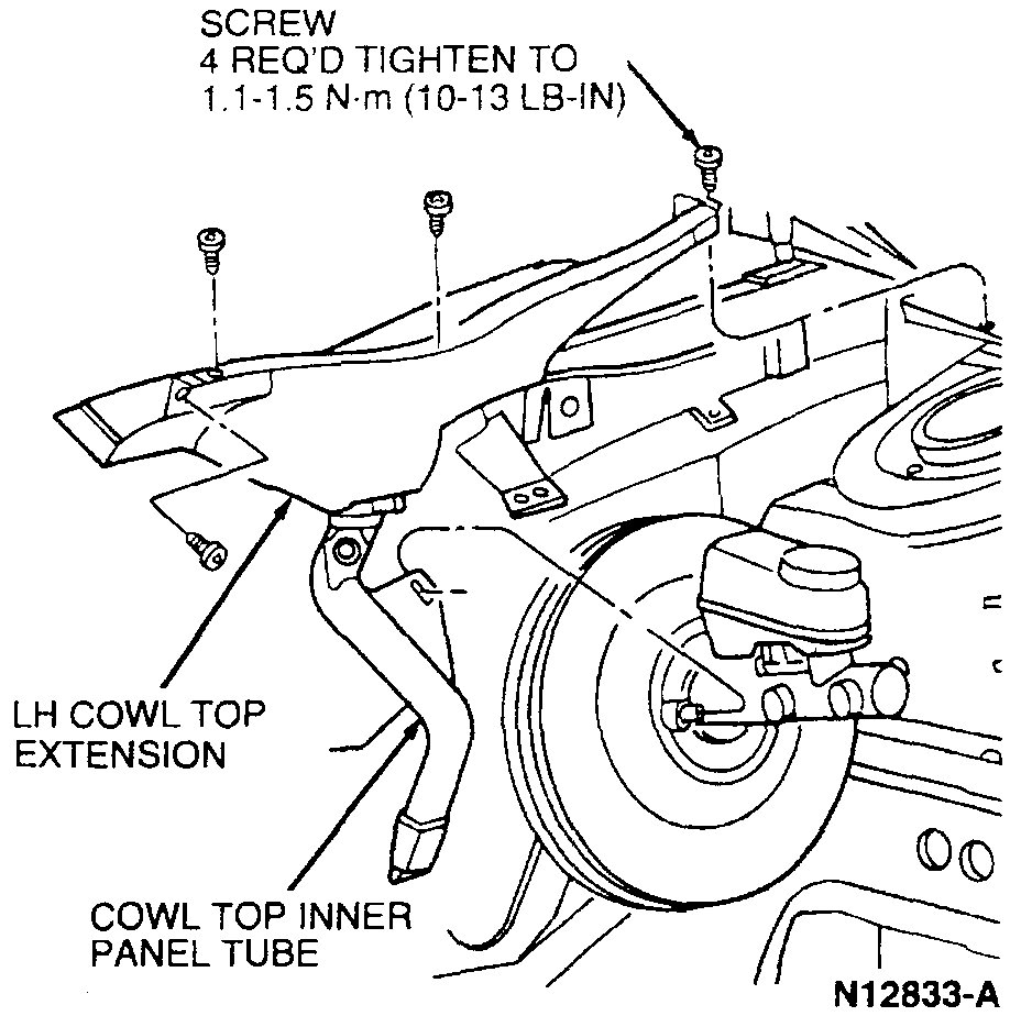

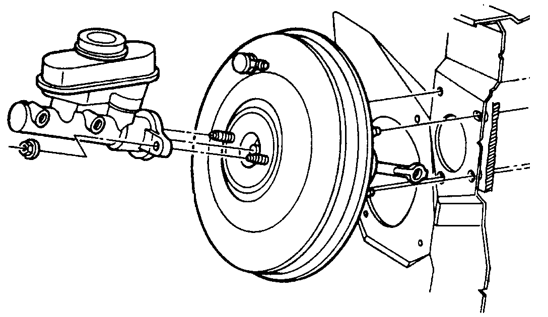

I attached the directions for removal and replacement of the master cylinder in case you need them. They are specific to your car. All attached pictures correlate with these directions. The link below contains general directions for replacement of the master cylinder. It also explains how to bench bleed the new master cylinder before install.
https://www.2carpros.com/articles/how-to-replace-a-brake-master-cylinder

4. Remove nut retaining cowl top inner panel tube to brake master cylinder.
5. Disconnect cowl top inner panel tube from cowl and remove.
6. Remove two nuts retaining brake master cylinder to power brake booster assembly.
Master Cylinder
7. Slide brake master cylinder forward and upward from vehicle.

1. Before installing the master cylinder, check the distance from the outer end of the booster assembly push rod to the face of the brake booster assembly.
Master Cylinder
i 2. Position brake master cylinder assembly on studs on power brake booster assembly.
3. Install mounting nuts. Tighten to 26-39 Nm (19-28 lb ft).
