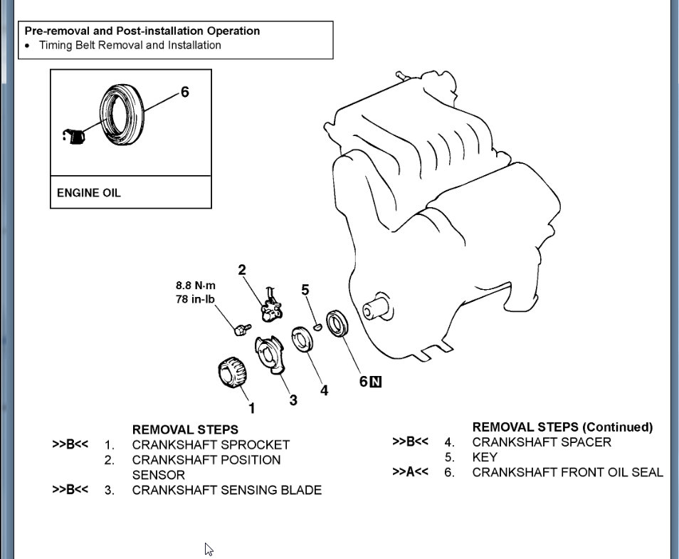

I have oil all over front of engine, belts , alternator etc. Trying to nail down where it would be coming from. Could it be the front crankshaft seal?

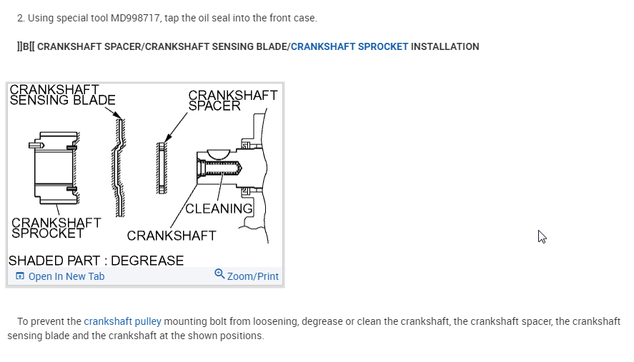

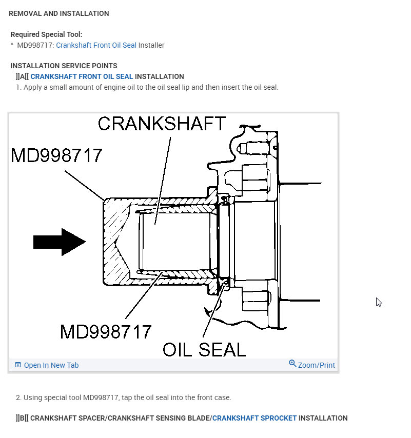

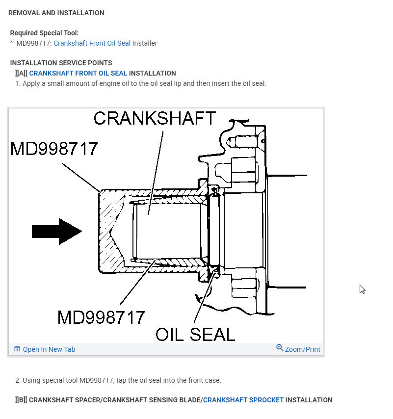

Okay, that limits it down. So I think you are good to go with the crank seal . The only thing I would do it make sure that it is the crank and the dampener is the one spraying it around. I would hate to do all that and it is something else dripping on the belt and it is getting sprayed around that way. It will only take a few minutes and a couple can of brake clean to spray off the front of the engine and then retest it.
Once you confirm it, here is the procedure for replacing it. Unfortunately they are not very detailed so let me know if you need more info and I will try to find a video or something. Thanks
