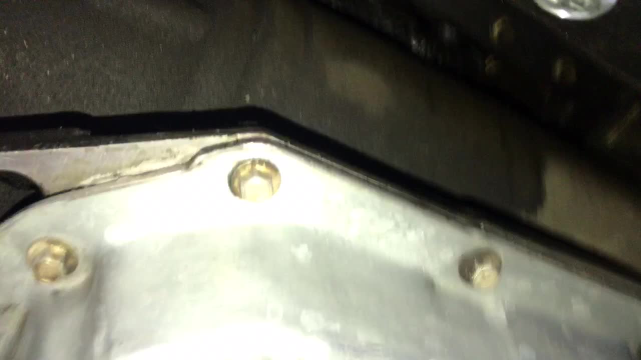

So, I have asked a similar question to this before, that I had dripping oil under my car for quite some time now. At first I thought it was the transmission pan gasket or the oil pan gasket, I have replaced both valve cover gaskets and the intake manifold gasket. Also replaced the camshaft position sensor that was badly leaking oil from on top of the engine. This stopped the leak under my car, but there was still caked on oil around the transmission pan and oil pan. A few days ago, I sprayed the heck out of the bottom of the car, around both pans with engine degreaser. I hosed it all off and everything looks great and dry. No leaking or moistening since, but I have this fresh spot of oil right up next to the engine oil pan, I do not know where the leak/drip is coming from. I posted a video, anyone know what it might be?

There seems to be some sort of blue connector close to the bolts of the oil pan. It does not seem like it is dripping from the actual gasket of the oil pan. I would think the oil would be dripping onto the bolts, I may be wrong though.

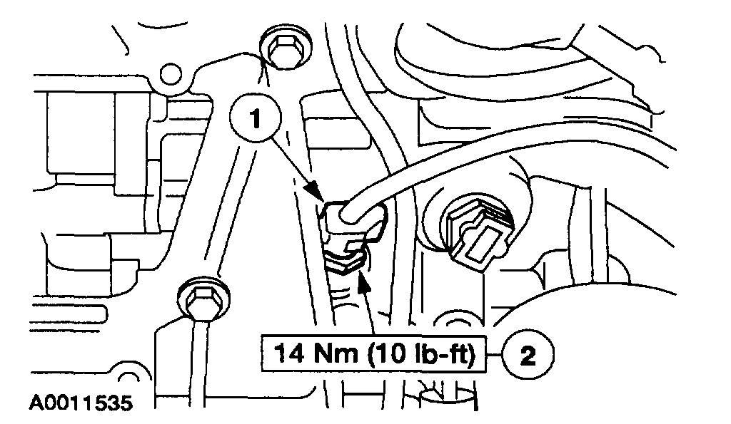

  • 110,241 POSTS
I have to be honest, I think it is the oil pressure sender that is leaking. Over time, they will start to leak around a crimp. However, based on the engine design, (4v or 2v) determines its location. I attached a picture of where to look based on the engine you have. I cannot identify type without a VIN.
Let me know if this helps.
Sep 20, 2018 at 12:38 PM

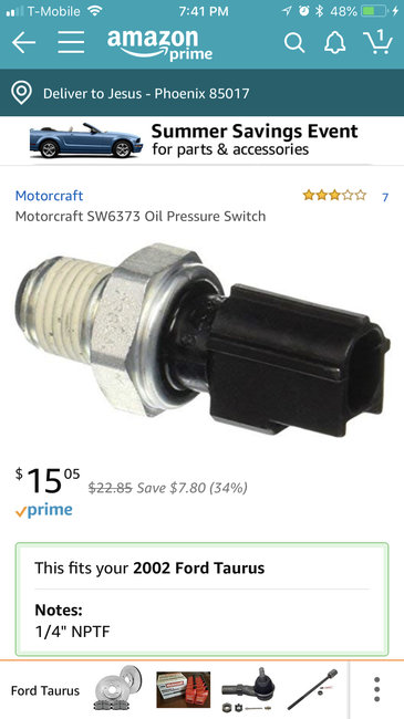

JGONZO2398
  • 374 POSTS
This part?
Sep 20, 2018 at 12:41 PM
  • 110,241 POSTS
Yes, that is the part. As far as engine, the four valve per cylinder verses the two valve have different locations.
