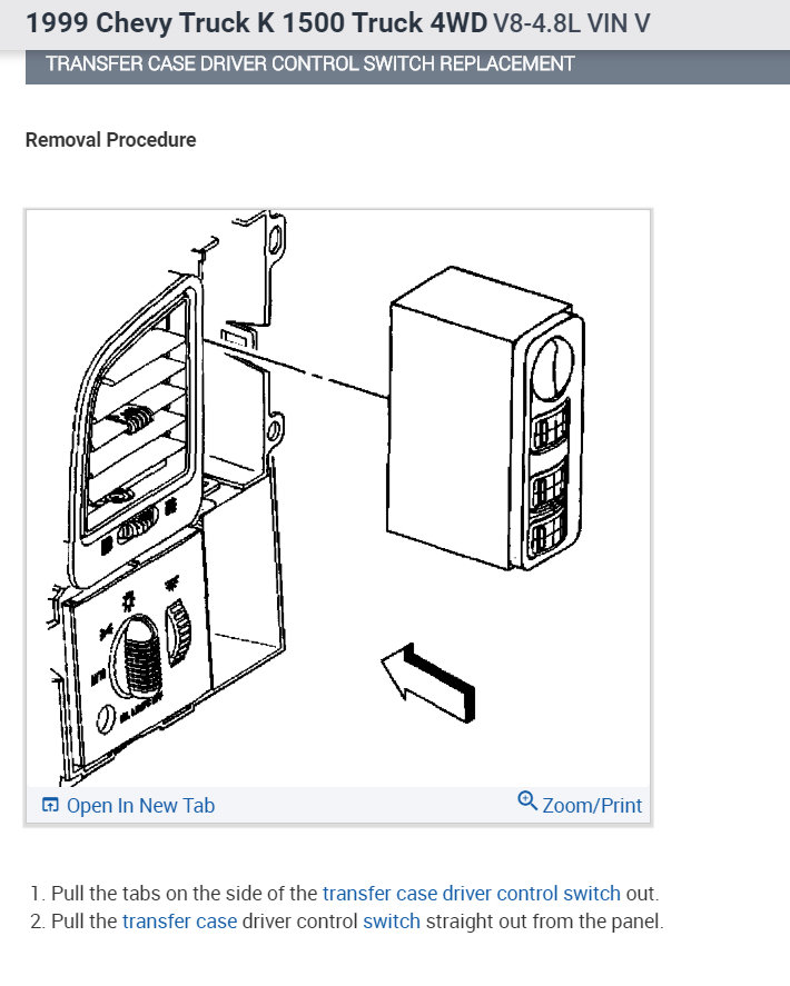

I had this truck with this problem. I replaced the control switch and it fixed it. here is how in the diagrams below. Check out the diagrams (below). Please let us know what happens.
Sep 2, 2020 at 3:45 AM (Merged)
TYLER SANDER
I replaced the switch still not working. Could i take old TCM to a part store to get any stored info off of it to get a better idea of what to do next?

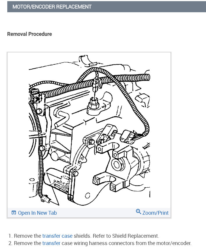

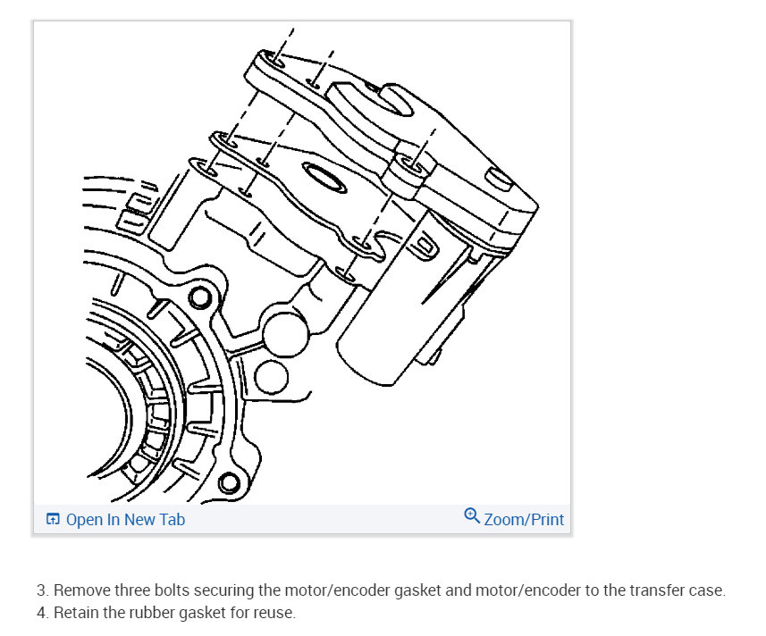

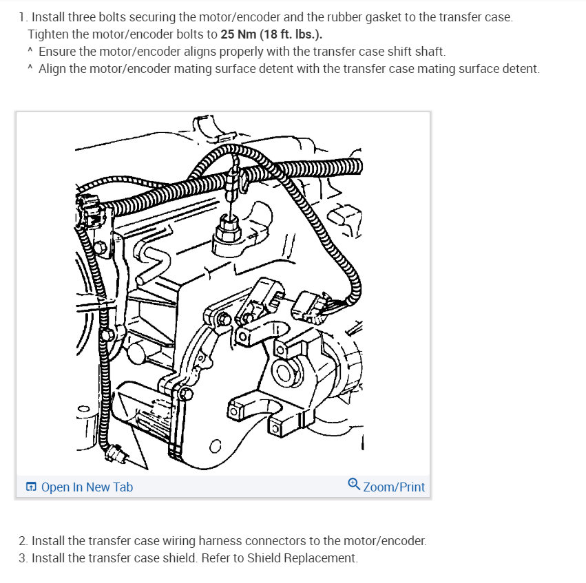

The system doesn't work that way, it sounds like the encoder is out. Here is how you replace it. Check out the diagrams (Below). Please let us know what happens.

I finally replaced the encoder motor. When i started up the truck i tried to go and drive but the wouldnt come out of park. I shut it off and turned it back on and then tried again and it did go into gear. i moved into the open and put the truck into neutral. i pushed the 4hi button and all i heard was grinding, i waited a few seconds and it wouldnt stop so i shut off the truck. I started it back up and tried again, and all i got was the 4hi would flash a few times at me and go back into 2 hi. I tried 4lo and i heard a few clicks underneath in went back into 2 hi and then 2 hi flashed at me and service 4wd light came on and the control module went out. i turned the truck back on and the module was saying 4 hi for bout 2 seconds and the service 4wd came back on and the lights went out. i can make that stop by pushing the 2hi after i turn the truck on. I am competely lost.
Sep 2, 2020 at 3:46 AM (Merged)
MASTERTECHTIM
  • 4,750 POSTS
is it possible you put the encoder motor in wrong. try starting from the beginning. remove the encoder motor and with it plugged in put it in 2wd then make sure the transfer case is in 2wd then reinstall it.
