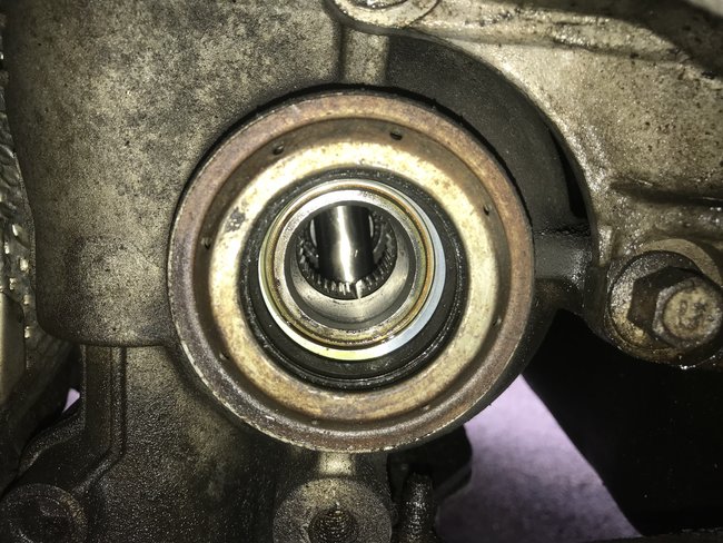

I removed the passenger side CV axle on my van. I replaced the boot and went to reinstall but it will not back in. I have checked the snap ring, tried greasing it slightly, made sure my splines were lined up, and tried tapping. I even filed the spline ends a little just in case they were damaged somehow. I can feel the end the axle hit the ring inside the engine it should sit into but it will not go passed that point. I also checked for debris in the insert to make sure it was clean. I cannot think of any other reason it will not go in.

I bet you spread the clip if you removed it. That clip will not seat if it expands. You must "bang" the axle inward to get it to seat correctly. Try compressing the clip and try again or turn the axle over. Give it a good wack with a rubber mallet.

I actually have the clip off at the moment. I did that too ensure that was not the issue. I could remove that end, try to reinstall it on the van, and then try to put the shaft back together in the van but I do not think could get the boot clips tight enough in that small space. I appreciate the input and would love any other ideas you might have. Is there a way to tell if the something has shifted inside the trans-axle? This is a new one for me. I have attached a picture of what I am working with for reference.

  • 52,797 POSTS
Good picture. Looks good, nothing wrong there.
Compress that clip with a pair of pliers. Install it by sliding over the axle shaft to the groove. When you expand it it will not compress when you install.
Put some grease on it and try installing it again.

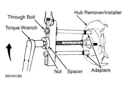

AXLE SHAFT (WINDSTAR)
Removal (Axle Shaft Assembly)
Raise and support vehicle. Remove wheel assembly. Remove axle nut and washer. Discard nut. Remove anti-lock sensor retaining bolt, and position aside. Remove lower ball joint pinch bolt and nut, and discard. Separate ball joint from steering knuckle.
If necessary, disconnect stabilizer bar at control arm. Install Hub Remover/Installer (T81P-1104-C) assembly, and push CV joint out of hub assembly. See Fig. 2 . Using pry bar, separate inner joint from transmission. Remove axle shaft from vehicle.
Fig. 2: Separating CV Joint & Knuckle Assembly
Courtesy of FORD MOTOR CO.
https://www.2carpros.com/forum/automotive_pictures/266999_cv_1.jpg

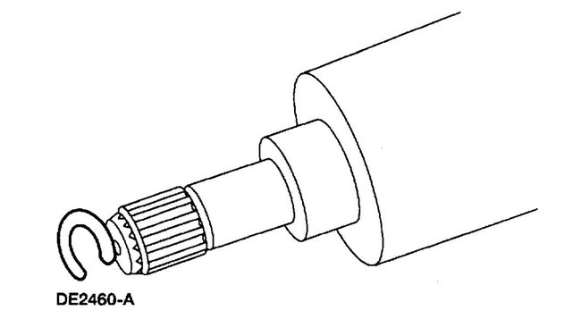

Installation
Replace circlip on transaxle end of axle shaft. Insert axle shaft into transmission. Ensure circlip is fully engaged in transaxle. If difficulty is encountered engaging axle shaft into transmission, tap on outer CV joint with plastic or rubber mallet.
Feed outer CV joint stub shaft into hub as far as possible. To complete installation, reverse removal procedure using NEW axle nut and NEW lower ball joint pinch bolt and nut. Tighten all nuts and bolts to specification.
