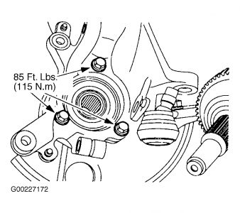

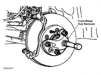

when replacing the bearing,how do i get at the three bolts that hold the assembly on
Jan 16, 2008 at 7:25 PM
BMRFIXIT
  • 19,053 POSTS
loosen the axle nut and push axel in
