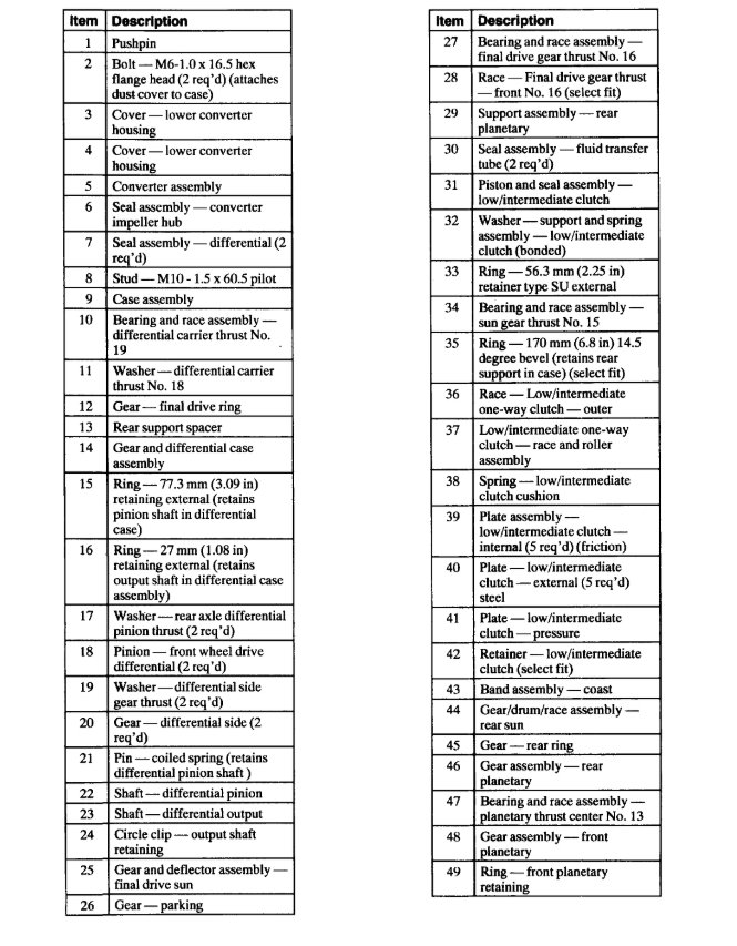

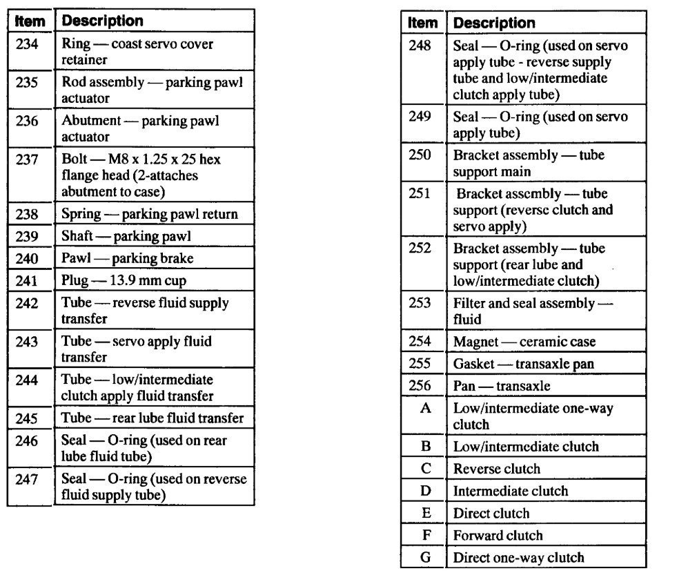

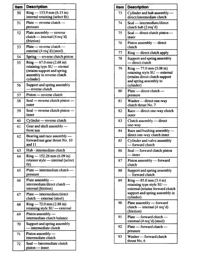

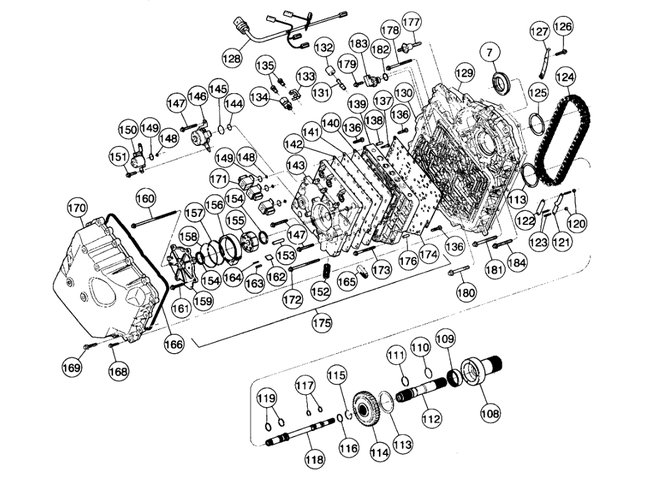

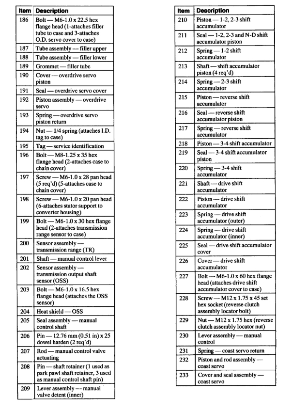

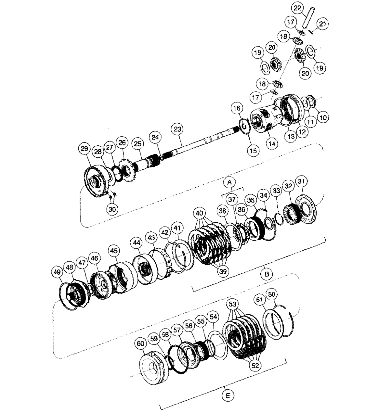

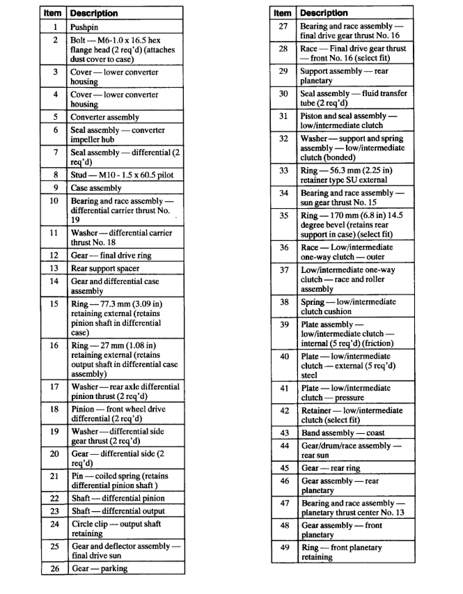

A diagram of how the transmission is assembled?
Saturday, May 30th, 2009 AT 5:35 PM
SERVICE WRITER
MECHANIC
9,123 POSTS

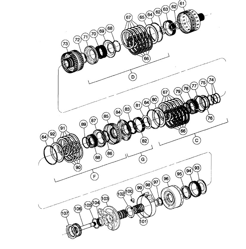

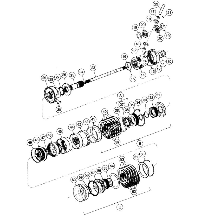

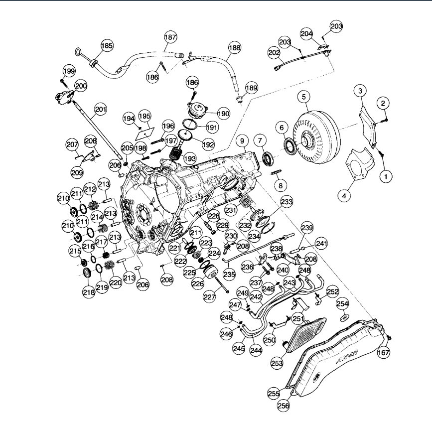

Here are the transmission assembly diagrams with the identification of the parts as well in the diagrams below. Check out the diagrams (Below). Please let us know if you need anything else to get the problem fixed.
