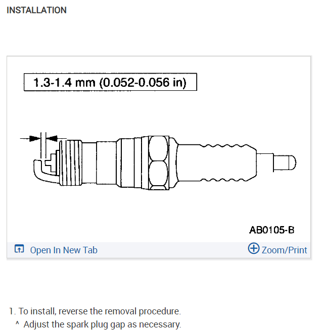

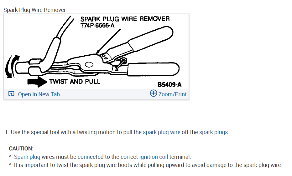

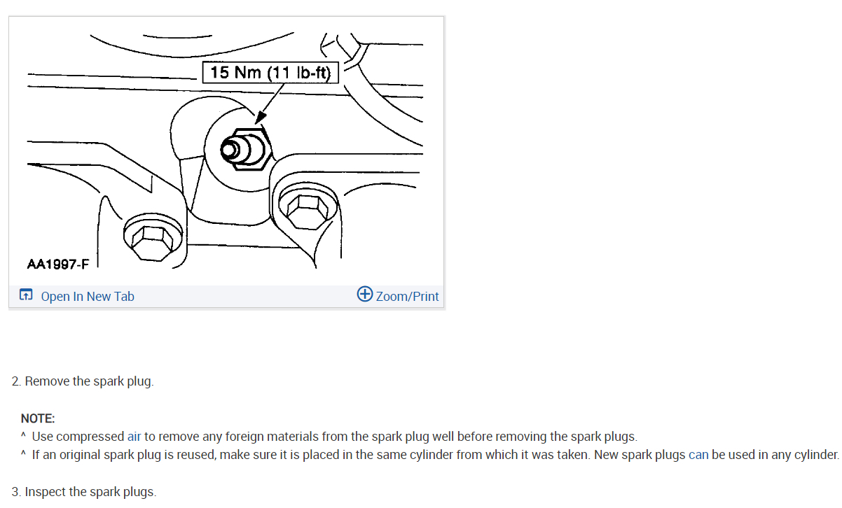

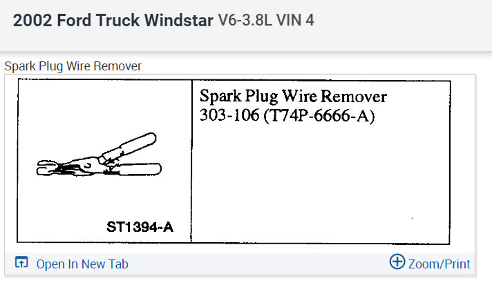

That does not make sense, I would do a full tune up which should be done anyway, here is a guide to help you, and don't forget to service the throttle body.
https://www.2carpros.com/articles/how-to-tune-up-a-car-engine
and
Original spark plug .................... AWSF-42EG or AWSF-42E
Replacement spark plug .................... AWSF-42EE
Replace the ignition coil and spark lug wires as well, that should fix it. Check out the images (below). Please let us know what happens.
