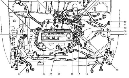

Good Morning, My A/C compressor on my van won't turn on. They tell me the freon is full, that the PCM turns on the compressor in "test mode". Both places I have taken it to are continuing to look for the outside air temp sensor. They get a B1254 code (air temp ext snsr failure). No one can seem to find the sensor. My questions: 1) I don't have an indication of outside air temp inside the vehicle. So would I actually have an external air sensor? It's supposed to be located behind the front bumper and no one can seem to find it. 2) If the IAT was bad would that cause the A/C not to turn on due to the sensor showing a cold temp? And isn't the IAT part of the MAF sensor?

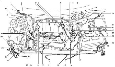

Top is 3.0 Bottom is 3.8 Iat= Intake air temp, not the same as AAT= ambient air temp! 3.0(top) it is at #22, Bottom(3.8) it's at #25 IAT= Intake air temp AAT= ambient air temp, not the same! AAT is what your looking for!

I have all of that. But is the AAT the sensor that can keep the A/C from coming on? Or is it the IAT sensor? And, do all vehicles have this AAT or is it possible that it really doesn't exist? The vehicle hasn't been in a wreck so no one has forgot to put the AAT back on. The A/C worked at the end of the season last fall (November 08) but now won't turn on. The 2 A/C repair places seem to be chasing their tails on this and have now had the vehicle for 2 weeks total and can find nothing. My question is which air temp sensor, (AAT, IAT) controls the A/C? Or what else could possibly be causing this lack of A/C?
