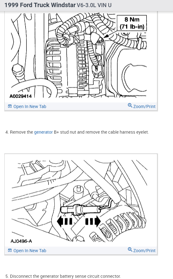

when driving my battery light will come on randomly and then goes off. but it does this everyday,day or night.stays on for a few minutes.
Jan 23, 2009 at 3:56 AM
SQM
  • 6,383 POSTS

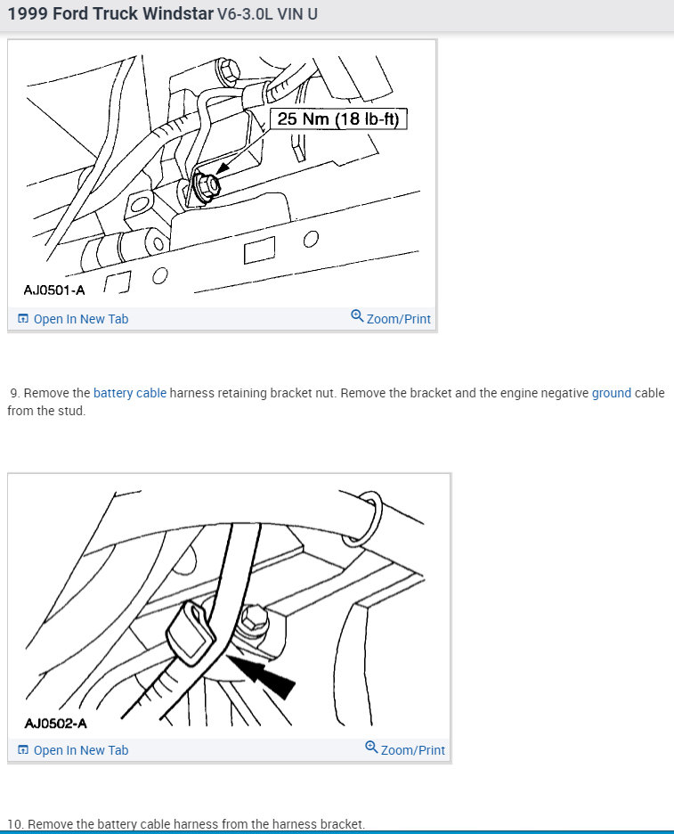

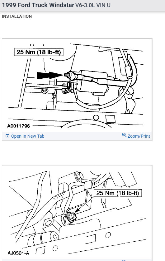

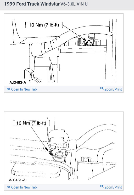

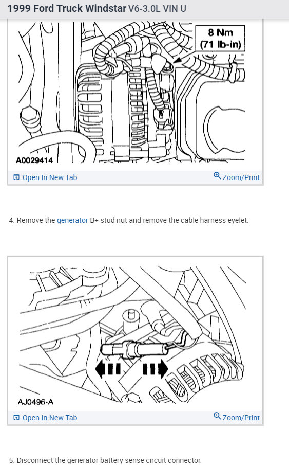

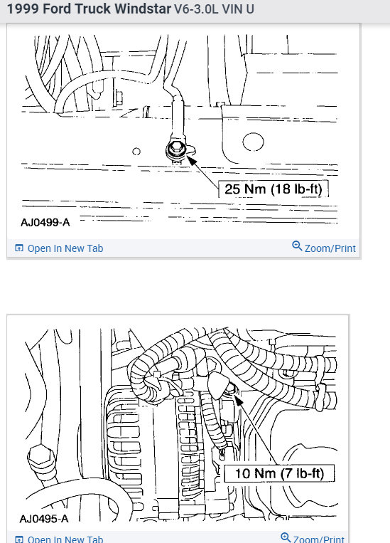

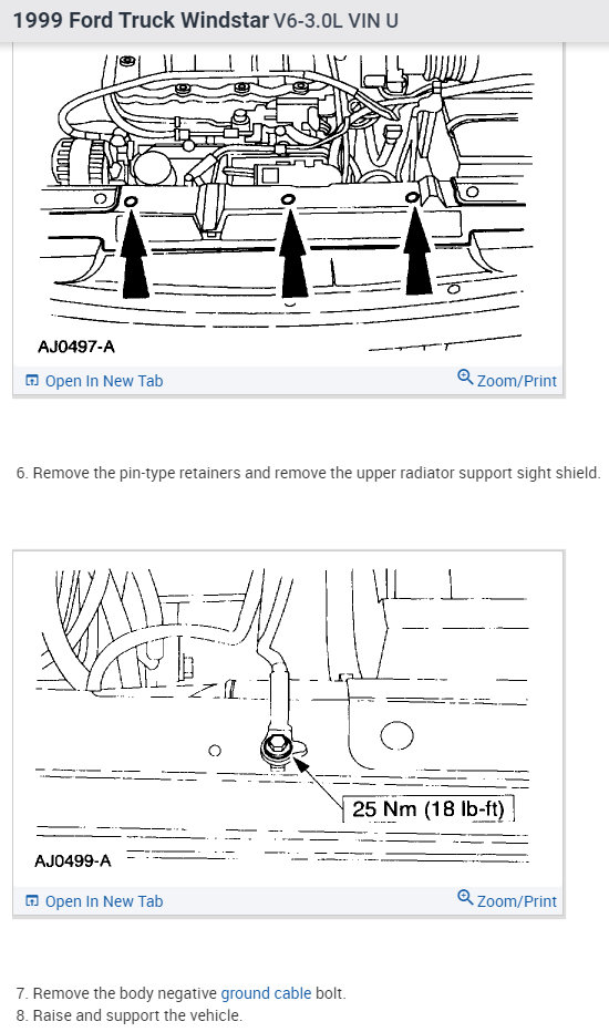

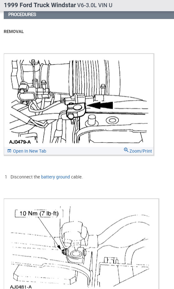

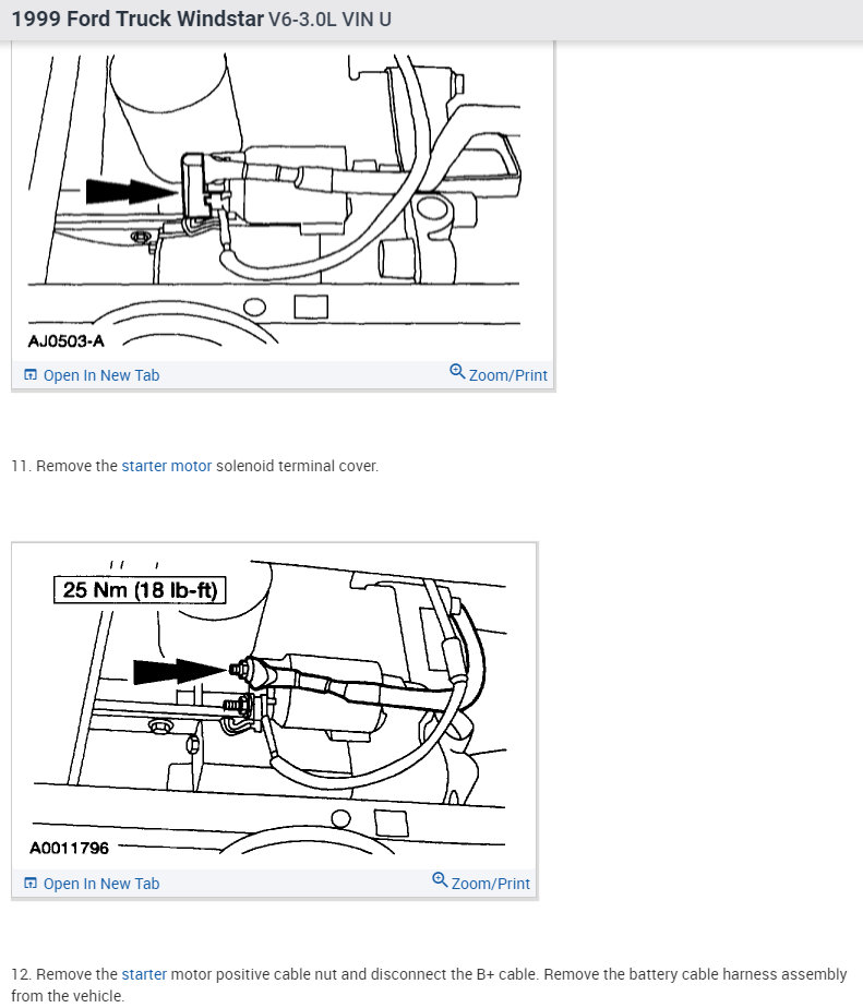

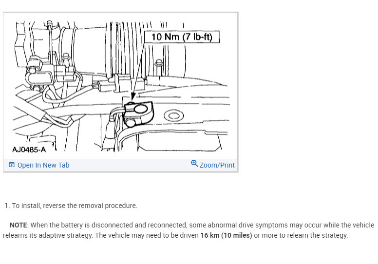

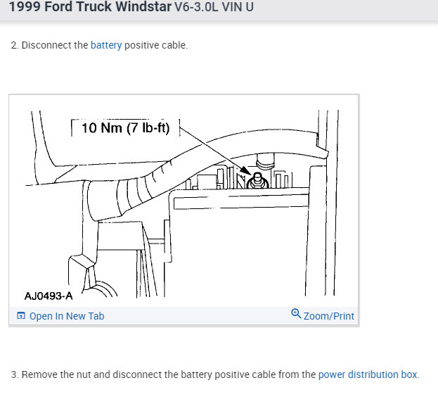

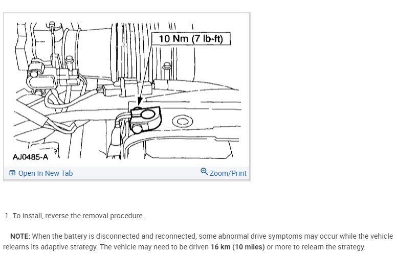

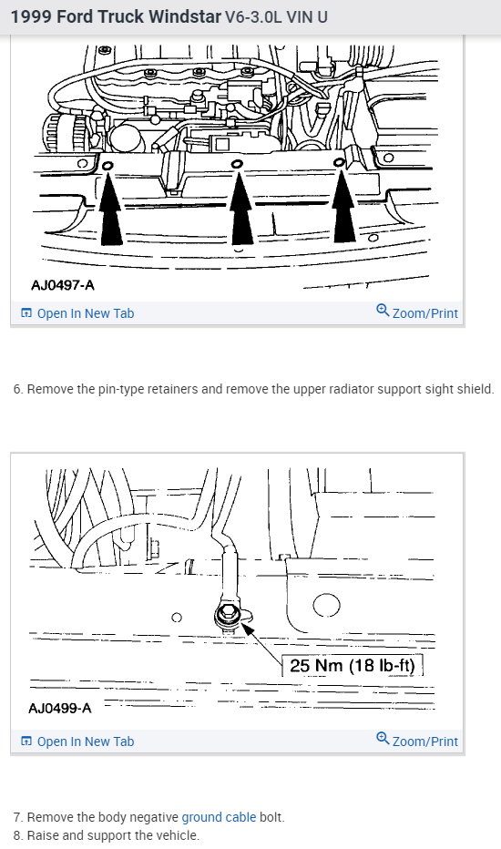

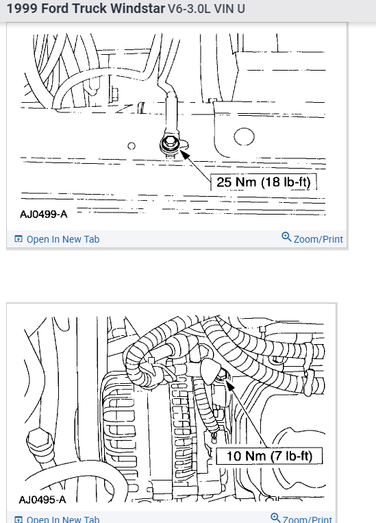

This could be due to faulty cable to the battery. As the light comes and goes it is an intermittent issue triggering by a connection.
Check the cable and make sure it is secured. Clean any corrosion that might be on the battery terminal.
Also make sure the alternator cable is secured and free of corrosion.
I have attached diagrams for the battery cable. Be sure to check all those connections.
