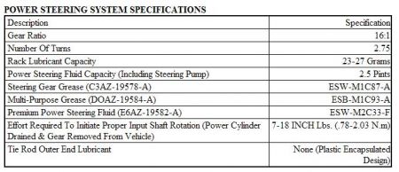

I just picked up a van, '95 Windstar, I believe the power steering fluid is low. The van did not come with an owners manual, so I was wondering what kind of power steering fluid do I need to use. I've read that these take "Mercon V" and that is all I can use, is that true? Where do I get that at?
Jun 9, 2009 at 4:28 PM
BLUELIGHTNIN6
  • 16,542 POSTS
Below are the specs on your power steering system, including the type of fluid to be used..
https://images.2carpros.com/forum/automotive_pictures/261618_Noname_518.jpg
