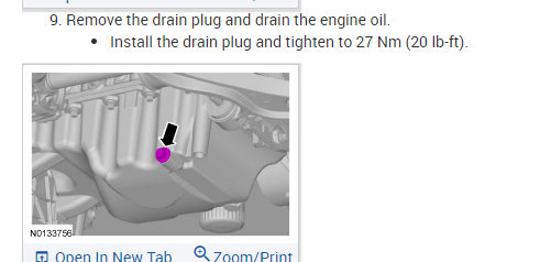

Hello, I am doing an oil change, does anyone know the socket size for the drain plug and torque?
May 21, 2021 at 5:36 AM
I attached the spec below for the torque of the plug. As for the size, it varies. It is either 13,15,16,17,19 or 21 millimeter.
https://youtu.be/nIau20nx8wU
Unfortunately Ford was not consistent with their drain plug sizes so I would just get down there with set of wrenches that way you are sure to have the right one and prevent you from getting up and down a number of times.
My money would be on a 15mm wrench as that seems to be the most common on my modern Fords.
