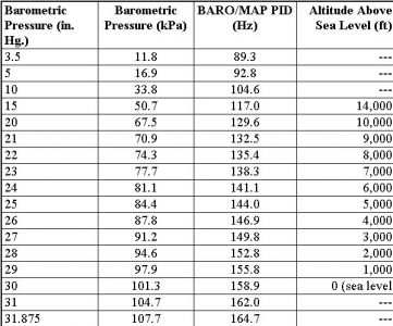

I'm still a little suspicious of the MAF sensor, and also wonder about a vacuum leak such as at the intake. I hate when no codes show. Check the baro reading and find what your area's sea level should be. Is it in spec when the problem happens?
https://images.2carpros.com/forum/automotive_pictures/30961_barochart_1.jpg

The graph for the MAF sensor corresponds to the throttle opening and follows the TPS graph almost exactly. I was thinking about a vacum leak maybe near the pressure regulator, i didn't find any hoses that seemed bad, I moved all of them around and nothing changed. I'll try a little carb cleaner around the intake to see if the idle changes. We're at sea level +30 feet here.

The graph is consistent when the problem is happening? I would still check the baro reading when the problem happens.

Yes the graph for both the MAF and TPS are smooth and even,no jumps or dips, they follow the amount I push on the throttle and each other's pattern the same as they do when it's running OK.
How do I check the baro, I've never done that before? I'll do it tomorrow when I go back to my shop. I havent hooked up the fuel guage after the engine is hot, I'm a little afraid of high pressure fuel around a hot engine while driving it. I did get it to act up while running in the driveway yesterday so I'll get it to mess up then I'll hook up the guage with a hose and extinguisher standing by and I'll let you know the readings.

The baro reading was a steady 30 at all times. I did get it to stall with the fuel pressure gauge hooked up. Just before the problem started I got a codeP0430 Cat low performance, then the fuel pressure started to drop, it went slowly down to 29, thats when the readings started to change for fuel trim and fuel injector pulse pattern, then the car started losing power, I disconnected the pressure regulator vacuum line and there was no change, I tapped the regulator a couple of times, no change, so I reconnected it, no change. Soon the pressure dropped to 19 and the fuel trim lines flatlined. I shut it off and restarted it and it was fine again for a while. I bet it's the fuel pump starting to go.... What do you think?
