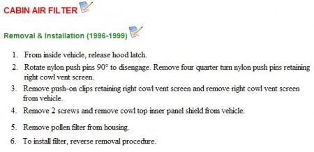

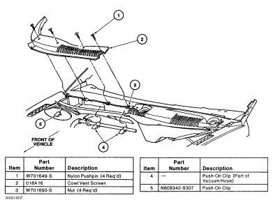

Brakes problem
1997 Ford Taurus 6 cyl Front Wheel Drive Automatic
HOW DO I REPLACE REAR BRAKES AND WHERE IS THE INSIDE AIR FILTER
