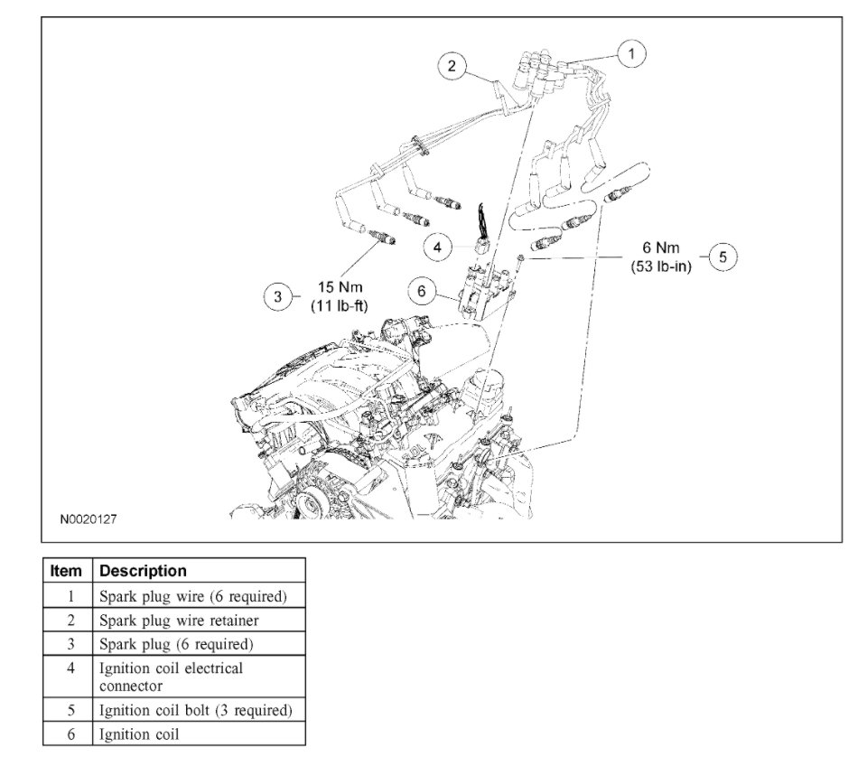

Here is a guide to help you step by step with instructions in the diagrams below to show you how on your car.
https://www.2carpros.com/articles/how-to-change-spark-plugs
Check out the diagrams (Below). Let us know what happens and please upload pictures or videos of the problem.

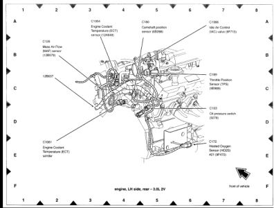

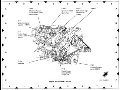

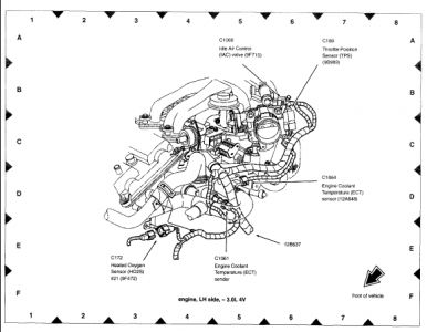

JOE THERIOT

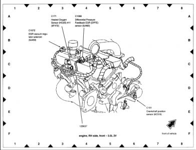

my engine is beginning to run badly as the car warms up and gets worse as the day gets hotter. it sounds like its running out of fuel. i am wondering where, if there is one, the crank sensor is, and the throttle position sensors are. i need to change the spark plugs and wires?
May 23, 2021 at 4:38 AM (Merged)
  • 75,988 POSTS
Here is a guide to help change the spark plugs https://www.2carpros.com/articles/how-to-change-spark-plugs Crankshaft Position Sensor 2003 Ford Taurus V6-3.0L DOHC VIN S
https://images.2carpros.com/forum/automotive_pictures/12900_c1_42.jpg
2003 Ford Taurus V6-3.0L VIN 2 Flex Fuel
https://images.2carpros.com/forum/automotive_pictures/12900_c2_34.jpg
Throttle Position Sensor 2003 Ford Taurus V6-3.0L VIN 2 Flex Fuel
https://images.2carpros.com/forum/automotive_pictures/12900_t1_26.jpg

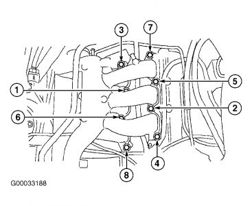

Its depend on you engine size I am going to assume you have the one that need upper intake removed or moved aside
https://images.2carpros.com/forum/automotive_pictures/99387_Graphic1_117.jpg

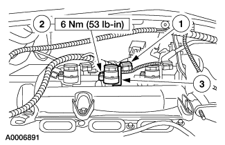

BMRFIXIT
  • 19,053 POSTS
Remove Upper intake manifold removed for clarity. Remove the ignition coil-on-plug. Disconnect the electrical connector. Remove the bolt. Remove the coil and plug.

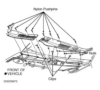

ZACKMAN
  • 4,202 POSTS
This guide can help help diagrams below to help you on your car. https://www.2carpros.com/articles/how-to-change-spark-plugs
https://images.2carpros.com/forum/automotive_pictures/55316_99taurussparkplug_1.jpg
https://images.2carpros.com/forum/automotive_pictures/55316_99tauruscowl_1.jpg

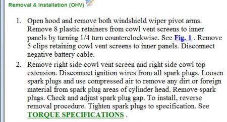

BMRFIXIT
  • 19,053 POSTS
what do u have for engine (DOHC SOHC ) 1.Open hood and remove both windshield wiper pivot arms. Remove 8 plastic retainers from cowl vent screens to inner panels by turning 1/4 turn counterclockwise. Remove 5 clips retaining cowl vent screens to inner panels. Remove left and right side cowl vent screens from vehicle. Remove 4 bolts retaining ignition coil 4 and position out of the way. 2.Disconnect negative battery cable. Ensure left and right side cowl vent screens are removed. Disconnect electrical connector from ignition coil and remove 4 ignition coil hold-down screws. Remove ignition coil to access spark plugs on cylinders No. 1, 2 and 3. Disconnect electrical connector from Intake Manifold Runner Control (IMRC) actuator. Remove IMRC mounting screws, and lay IMRC actuator aside to access spark plugs on cylinders No. 4, 5 and 6. NOTE: Spark plugs must be marked so they may be installed into the same cylinder from which they were removed. 3.Disconnect ignition wires from all spark plugs. Loosen spark plugs and use compressed air to remove any dirt or foreign material from spark plug areas of valve covers. Remove spark plugs.
https://images.2carpros.com/forum/automotive_pictures/99387_Graphic1_118.jpg
