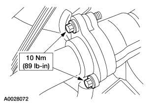

THERMOSTAT - 3.0L (4V)
Removal and Installation
1.Raise and support vehicle. For additional information.
2.Remove the front splash shield
3.Drain the cooling system.
4.Remove the cooling tube bolt.
5.Lower the vehicle.
6.Remove the radiator upper cooling tube bolt.
7.Disconnect the upper radiator hose and engine vent hose. .
8.Remove the two bolts, and separate the radiator tube from the thermostat housing. Remove the thermostat.
9.To install, reverse the removal procedure.
L(2V) locate upper hose and thermostat housing remove 3 bolts holding housing remove and replace thermostat

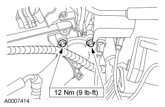

3.0 DOHC engine...
Drain the coolant until the level of the coolant is below the level of the thermostat.
Raise the vehicle and support it with jackstands.
Disconnect the lower radiator hose from the water inlet connection.
Unfasten the two water inlet connection retaining bolts and remove the water inlet connection.
Remove the O-ring seal and thermostat from the water inlet connection. Inspect the O-ring for damage and replace as necessary.
To install:
Clean the water inlet connection mating surfaces.
Install the O-ring, thermostat and the water inlet connection. Refer to the accompanying illustration If you can-t remember how the O-ring and thermostat are positioned.
Install the water inlet connection assembly retainers and tighten them to 71-106 inch lbs. (8-12 Nm).
Connect the lower radiator hose to the water inlet connection.
Fill the engine with coolant, start the engine and check for leaks.
Stop the engine and top off the coolant recovery reservoir as necessary.

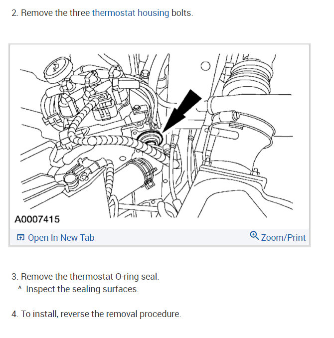

RONTANK71
May have a warped thermostat cover.
Oct 21, 2020 at 3:01 AM (Merged)
RIVERMIKERAT
  • 6,110 POSTS
No.See images.

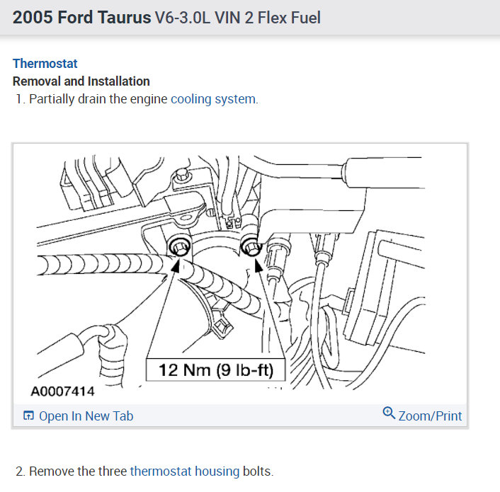

REEVESLG
Where is the thermostat located on the engine
  • 75,992 POSTS
Removal and Installation Drain the engine cooling system.
https://images.2carpros.com/forum/automotive_pictures/12900_t1_2.gif
Disconnect the lower radiator hose from the water outlet adapter.
https://images.2carpros.com/forum/automotive_pictures/12900_t2_1.gif
Remove the bolts, the water outlet adapter and thermostat. Remove and discard the O-ring seal. To install, reverse the removal procedure. https://www.2carpros.com/kpages/auto_repair_manuals_alldata.htm
