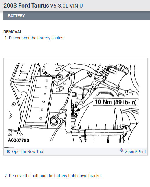

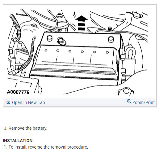

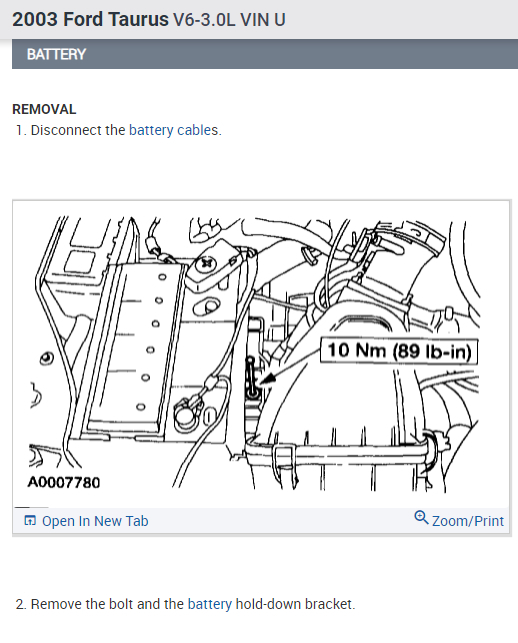

Just so can cover all the options, have tried to jump start the vehicle?
It sounds like you might have a weak battery and it loses charge rapidly.
https://www.2carpros.com/articles/how-a-car-battery-works
Another possibility is you might have a parasitic drain on the battery due to a electrical component staying on (like a glove box light or sticking window switch etc.) or a short somewhere that making the battery drain. You will need a voltmeter to check for the drain on the battery.
Here is an article that shows how to check for a parasitic drain:
https://www.2carpros.com/articles/car-battery-dead-overnight
