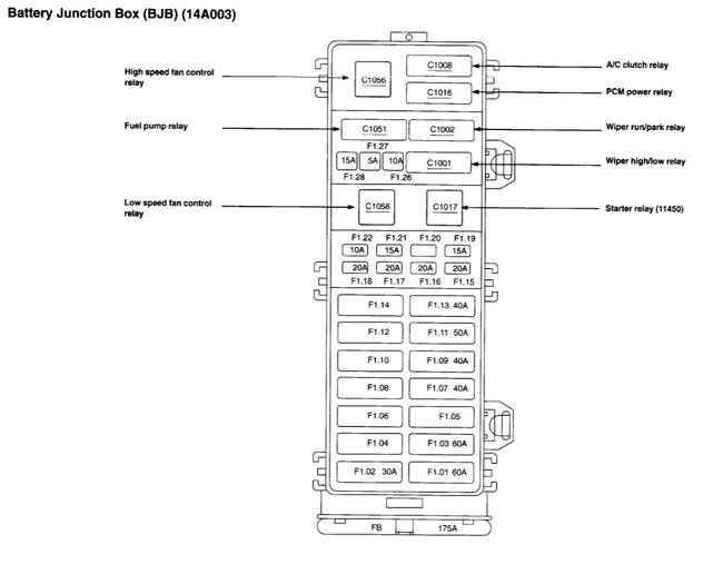

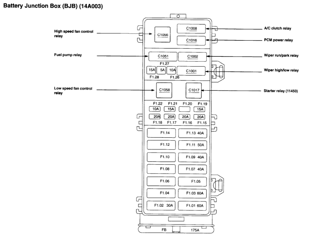

My cars wouldnt start so we bought a battery it still wouldnt start, than we bought an alternator it still wont start. Power goes on but it just clicks when you turn the key and nothing else? Why is this happening?

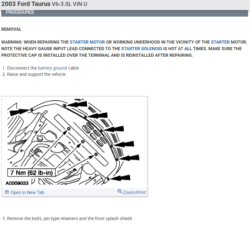

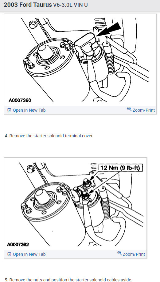

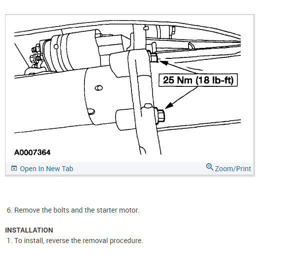

It sounds like you might have a faulty starter.

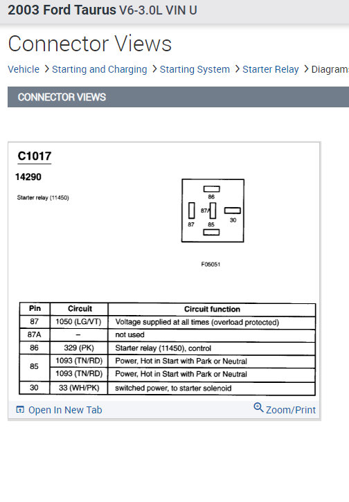

First you need to check the wiring that goes to the starter and verify you are getting power.
You will have to access the starter from under the vehicle.

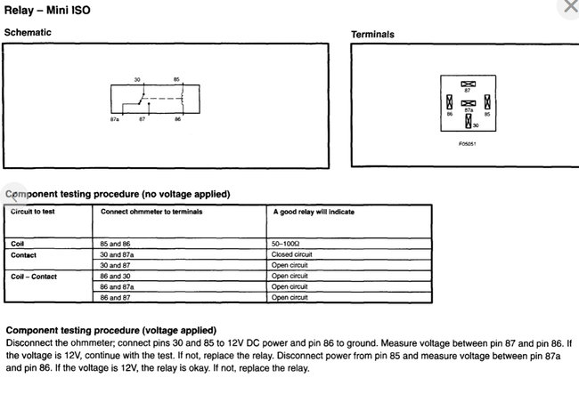

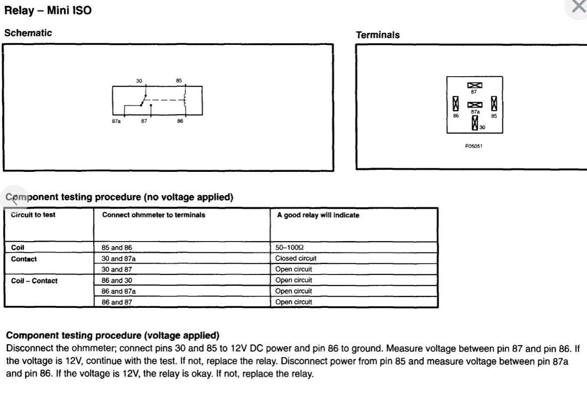

Another item to look at would be the starter relay.
https://www.2carpros.com/articles/how-a-starter-and-solenoid-works
Here is how to test relays:
I have attached starter replacement diagrams as well as relay location.
