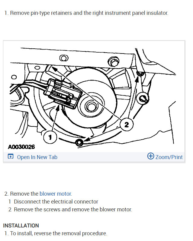

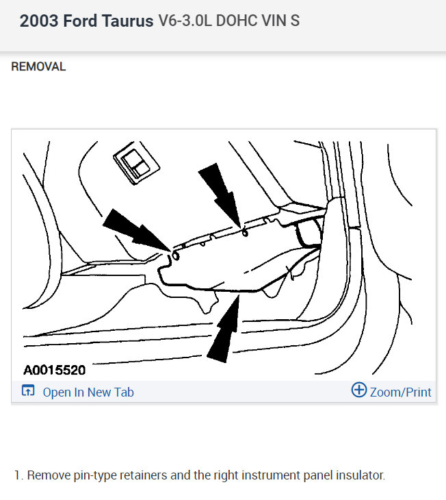

My heat and A/C is not blowing out of the vents at all. I thought maybe it was a fuse. I't don't seem to be a fuse at all. What could be going on.

Possibly the switch, or the resistor, even the blower motor itself, if no speeds work...Locate the blower under the passenger side dash, unplug the connector, then use a voltmeter to see if there is power to the blower, if there is the blower is no good, if no power the switch or resistor...

Yep, here is a guide to help you test to help you test for power and ground, and I have included how to change the blower motor out as well in case you need it.
https://www.2carpros.com/articles/how-to-test-an-automotive-hvac-system-blower-fan-motor-a-detailed
