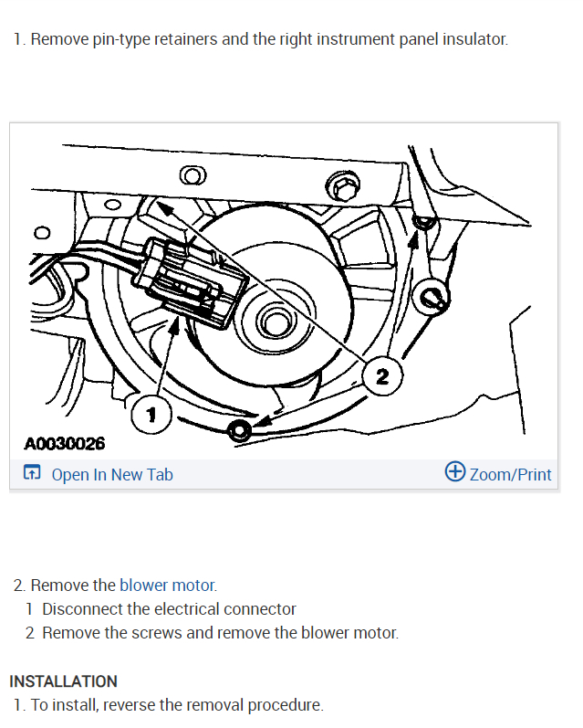

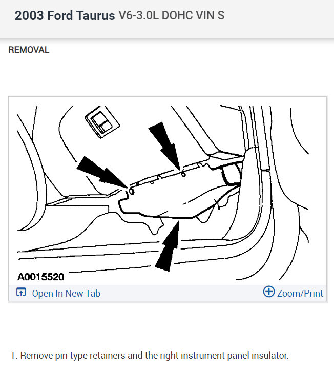

Possibly the switch, or the resistor, even the blower motor itself, if no speeds work...Locate the blower under the passenger side dash, unplug the connector, then use a voltmeter to see if there is power to the blower, if there is the blower is no good, if no power the switch or resistor...
Dec 9, 2007 at 11:14 AM
  • 54,837 POSTS
Yep, here is a guide to help you test to help you test for power and ground, and I have included how to change the blower motor out as well in case you need it.
https://www.2carpros.com/articles/how-to-test-an-automotive-hvac-system-blower-fan-motor-a-detailed
