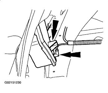

Heater blows out duct work only while at a stop light transmission has been rebuilt trans slipping again HELP is there a vacuum diagram problem that I can replace and could this have been the original problem 3K for the tranny a month ago

Tranny has to go back let them recheck it as for the heater yes you have a small black vacuum line that need to be checked for cracked of if off.

Under the hood and to the right side
also check the vacuum reservoir behind the right front fender splash shield
https://www.2carpros.com/forum/automotive_pictures/99387_Graphic1_623.jpg

Open the hood and check the vacuum lines
start engine, twist and turn vacuum hoses
you have a vacuum reservoir under the right tire splash shield
if you to remove the tire and the inner shield you should locate the box
with vacuum line make sure its not damaged or line off

Since the hit was on the right side and the vacuum reservoir on the right it is very possible that the body shop left the box disconnected or the box was damaged or removed
