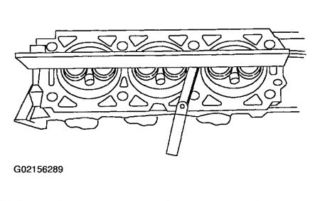

Ok there are many unanswered questions and I don't get in the middle of any kind of battle but I will give my opinion on what could be. First off what orings is he talking about? I think it may be a head gasket or a worped head. You have never said how hot this engine got before the gasket replacement. So if this isn't told to the mechanic he may not check the head for worpage (check pic below). So with that it would again blow the gasket once it gets warmed up because the head would distort more as it warms up. So without know what all he did or didn't do it is hard to say what could have really caused the gasket to go again. I won't do head gaskets on an engine with aluminum heads unless I check it for worpage and then have it shaved.
https://images.2carpros.com/forum/automotive_pictures/249564_Graphic_143.jpg
