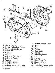

i have replaced back brakes on both sides, when i test drove the car the wheel cylinders on both sides blew at the same time. I replaced them and they blew again, i went back to the autoparts store and exchanged them two more times the keep on blowing , what am i missing here. i have replaced these many times and never had this problem.

For the wheel cylinder to come apart and leak its traveling more than it should make sure you have the correct shoes recheck hardware ,
