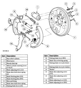

brake cylinder to push the piston out so far
2001 FORD TAURUS
PLYMOUTHIAN12
What would cause the brake cylinder to push the piston out so far,that all the fluid drains out and that you can see the piston pushed all the way out ,could it be i dont have the star wheel for the emergency brake adjusted right? thank you

About the only way this can happen is if the brakes are not assembled correctly or someone steps on the brake pedal with the drum removed. Here are videos and a guide to help you see how to do the job on similar vehicles, the process is the same. https://youtu.be/3W0fs6shT3o and https://youtu.be/1j7qDoi1LP0 and https://youtu.be/UV0kfP17Co0 and https://www.2carpros.com/articles/how-to-replace-rear-brake-shoes-and-drums Please run down these guides and report back.
