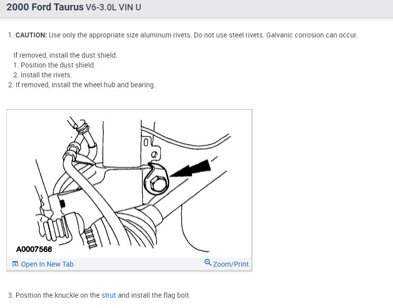

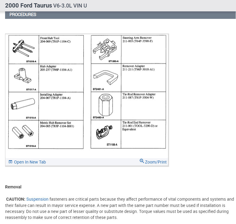

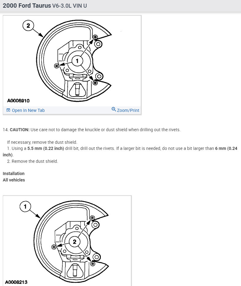

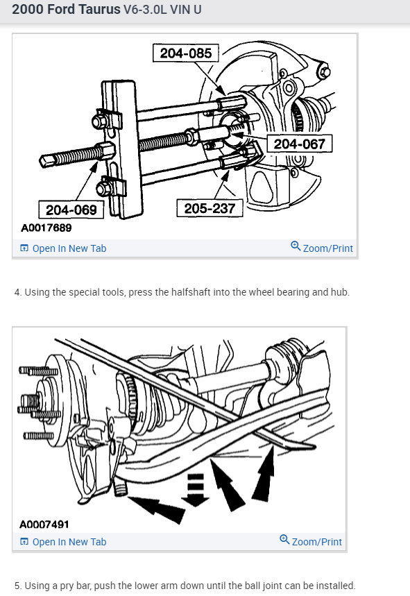

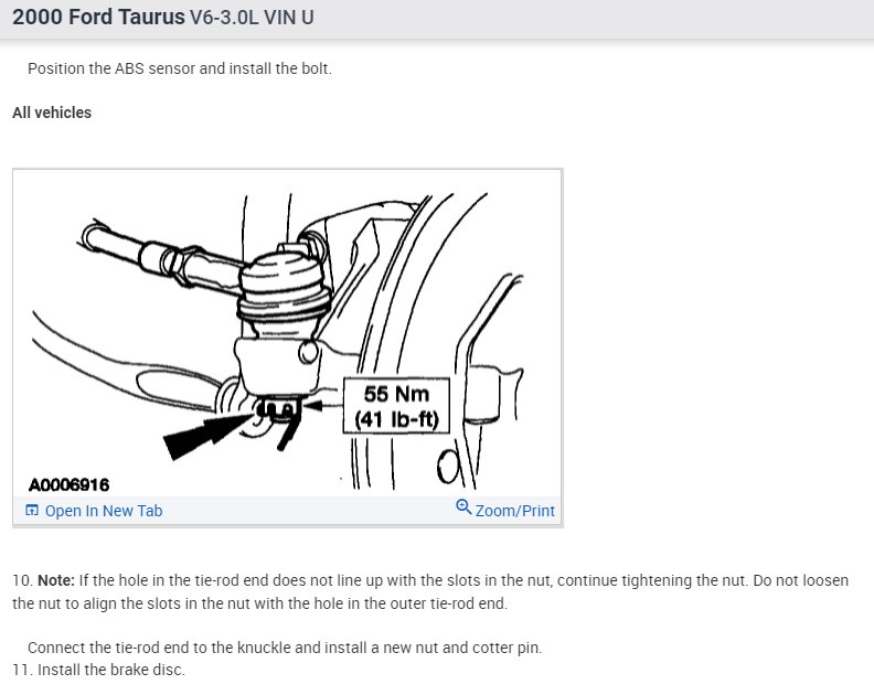

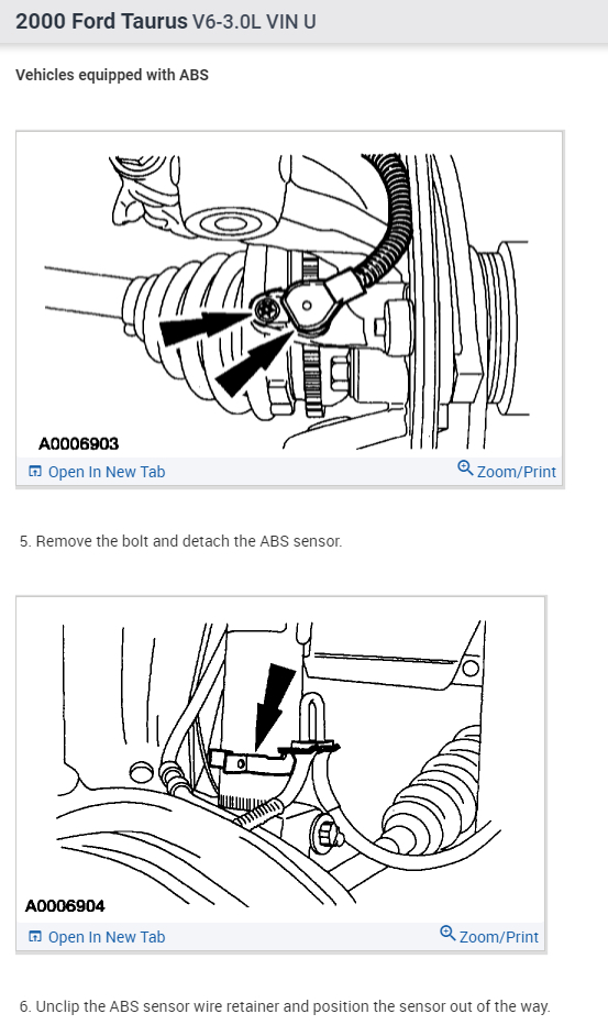

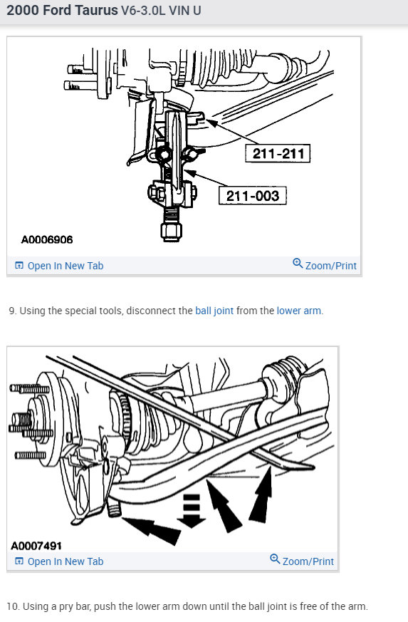

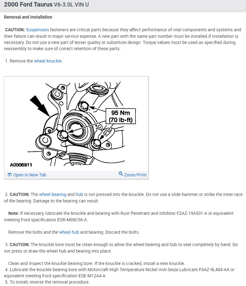

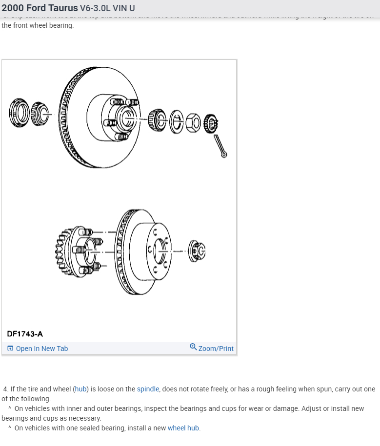

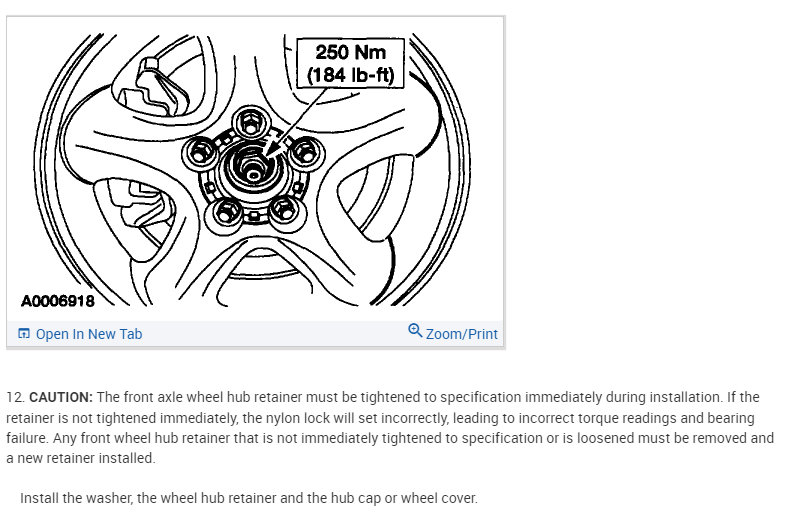

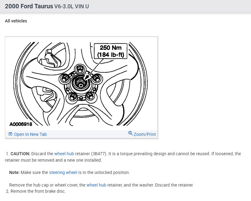

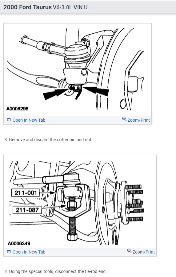

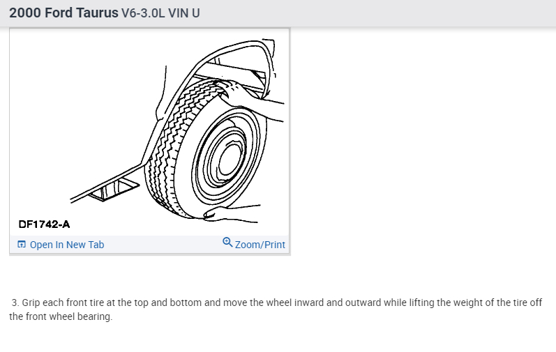

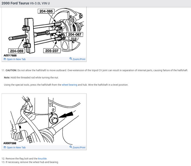

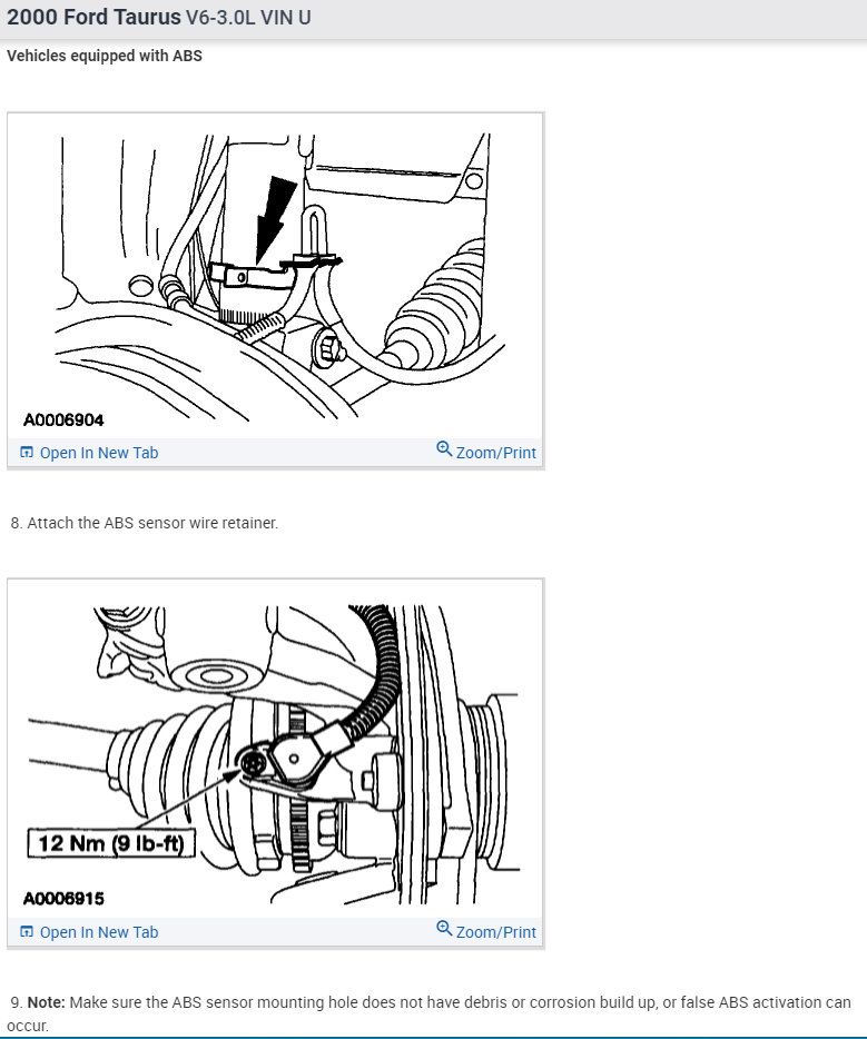

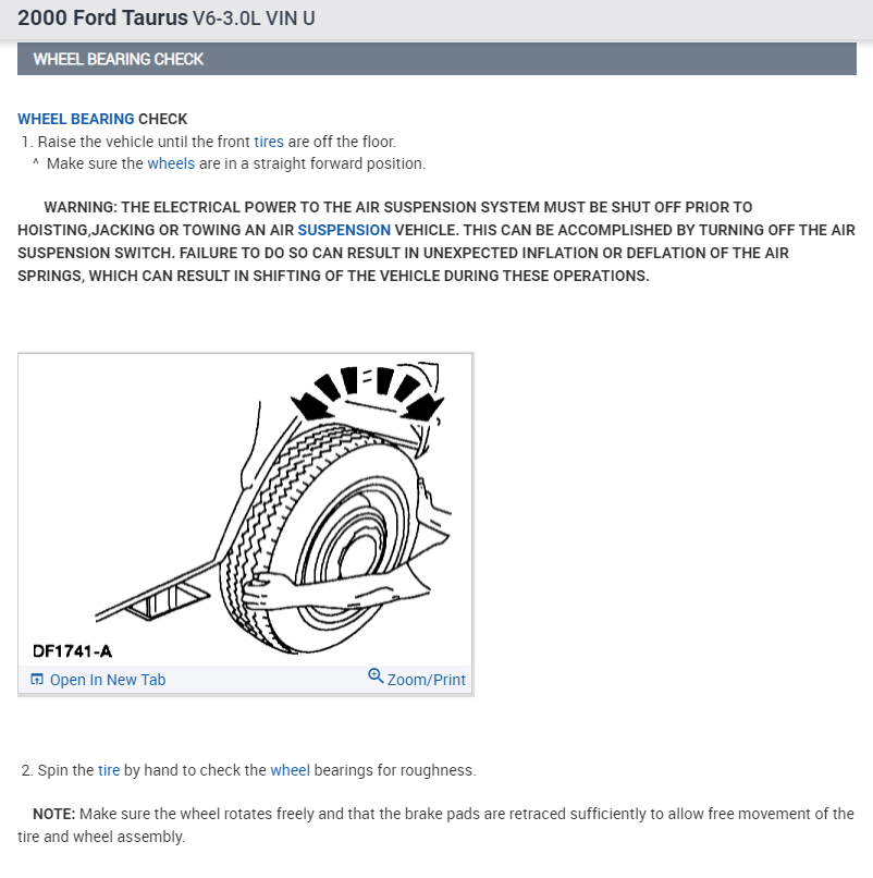

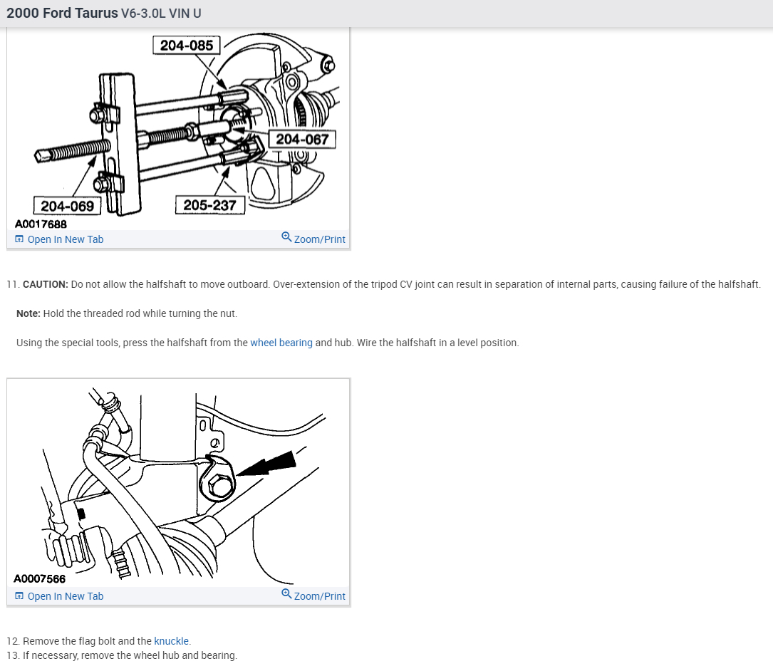

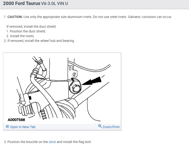

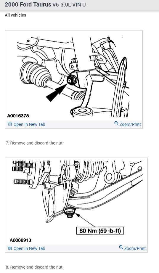

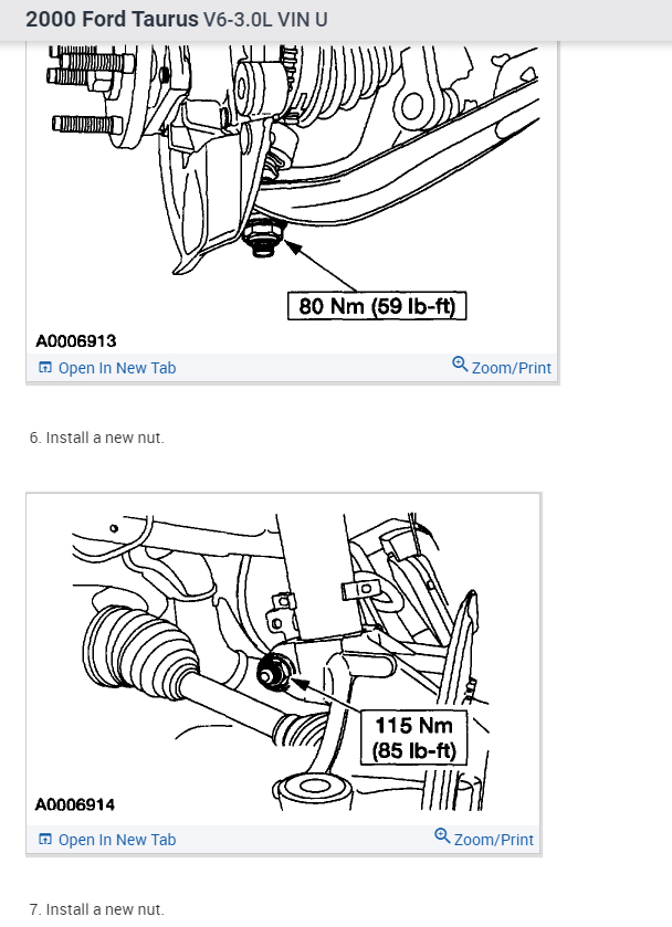

In order to replace the front wheel bearing there are a few items that will need to be removed first. You will also need a few special tools to complete this task. Primarily hub puller and steering arm puller.
Those tools can be rented from your local auto parts store.
Here is a helpful guide:
https://www.2carpros.com/articles/bearing-hub-replacement
I have attached diagrams for the replacement procedures including the required special tools below.
