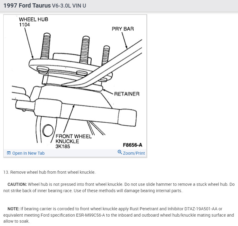

How much would it cost approximately to get the front wheel bearing replaced and how long would it take?
Nov 30, 2008 at 8:43 PM
SQM
  • 6,383 POSTS

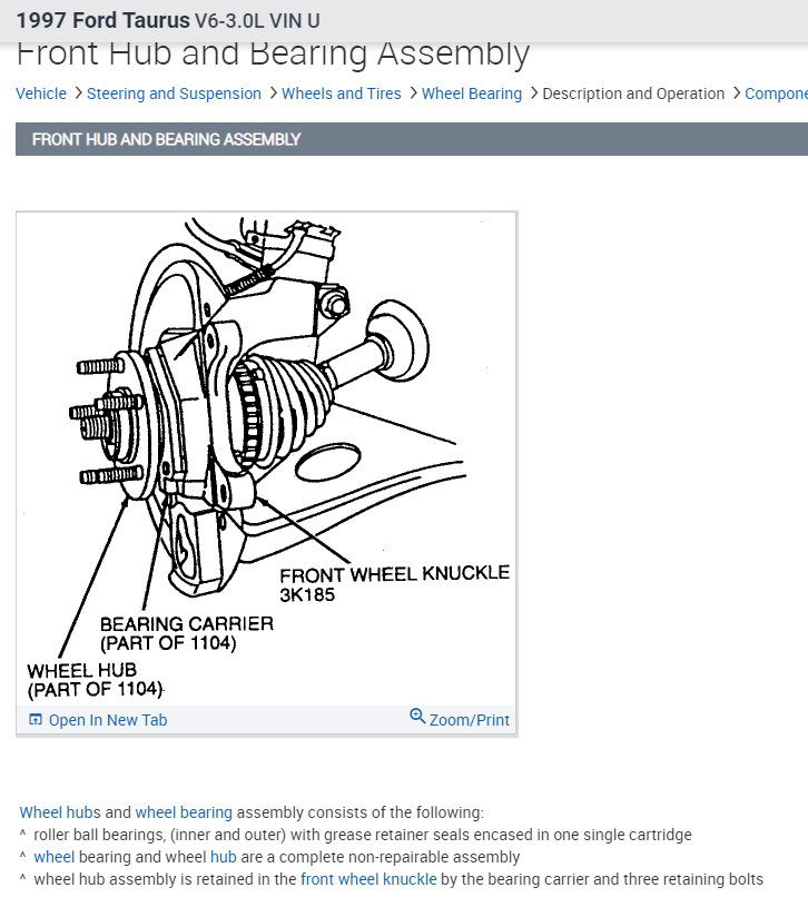

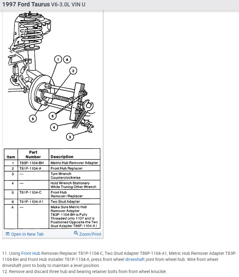

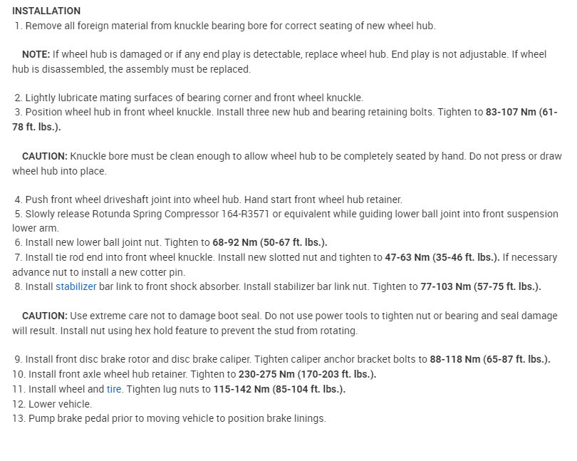

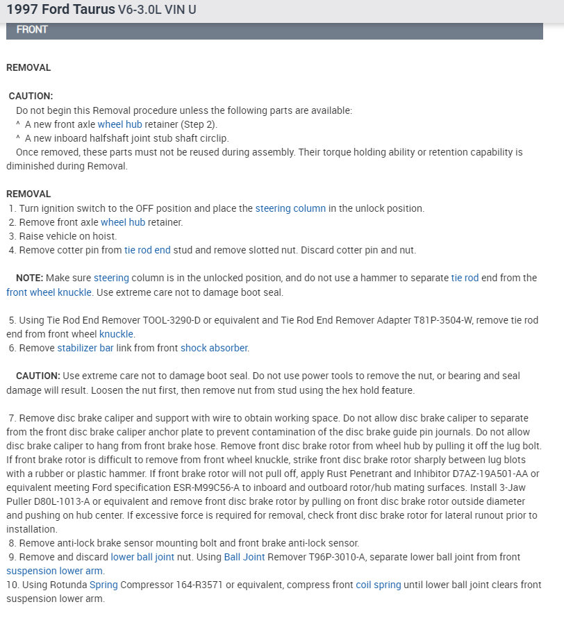

Replacing the wheel bearing hub can be done by using mostly common hand tools. You might need a hub puller to remove the bearing from the hub after removing all the bolts.
The hub bearing costs around $60.00 to $100.00 depending on the brand. As for labor cost, it will depend on the shop, as they all have different labor rates.
Here is a helpful guide:
https://www.2carpros.com/articles/bearing-hub-replacement
I have attached replacement procedure below for your reference.
