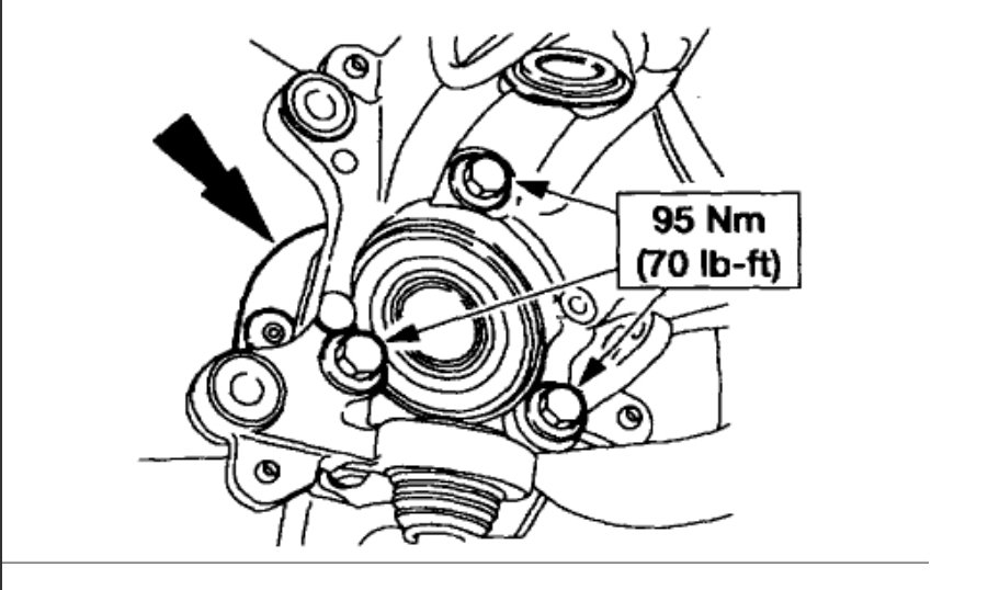

Could you tell me what the torque specs are for replacing the front wheel bearing assembly on a 2002 Ford Taurus SES, 6 cyl. DOHC, mileage approx. 100K

The torque specs are 70 foot pounds. Here is a guide to show you what you are in for when doing the job.
https://www.2carpros.com/articles/bearing-hub-replacement
Here is a diagram to show you what replacement the wheel bearing hub is on your car (below)
You will need a jack and jack stands to raise the car up safely.

Torque the front wheel bearing hub fasteners to 70 foot-pounds. Raise the vehicle with a jack and support it on jack stands, then replace the hub assembly using the hub replacement procedure.
