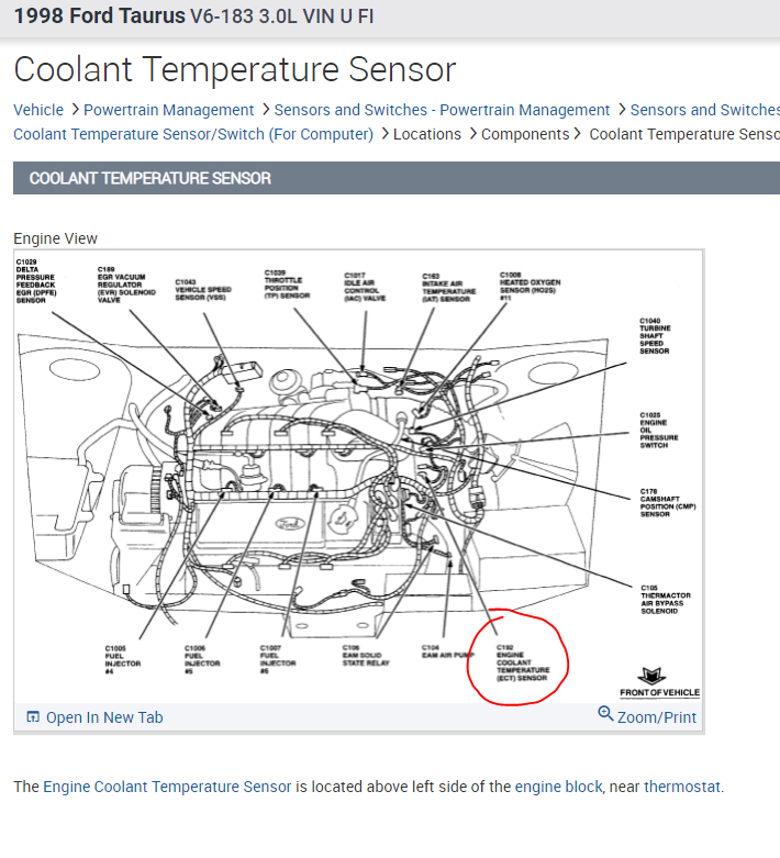

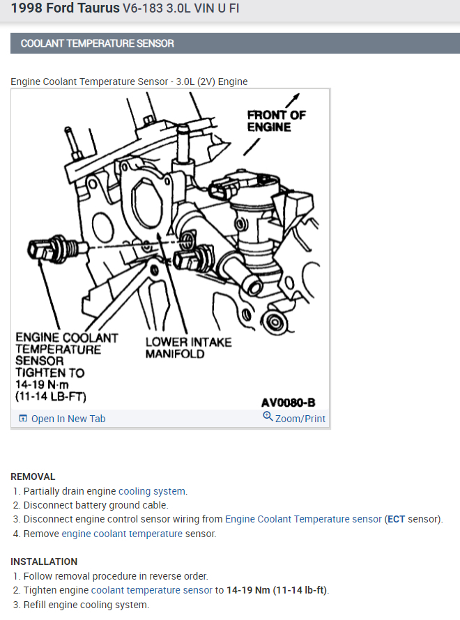

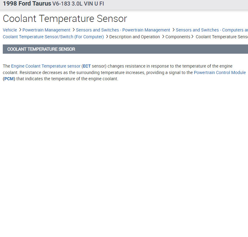

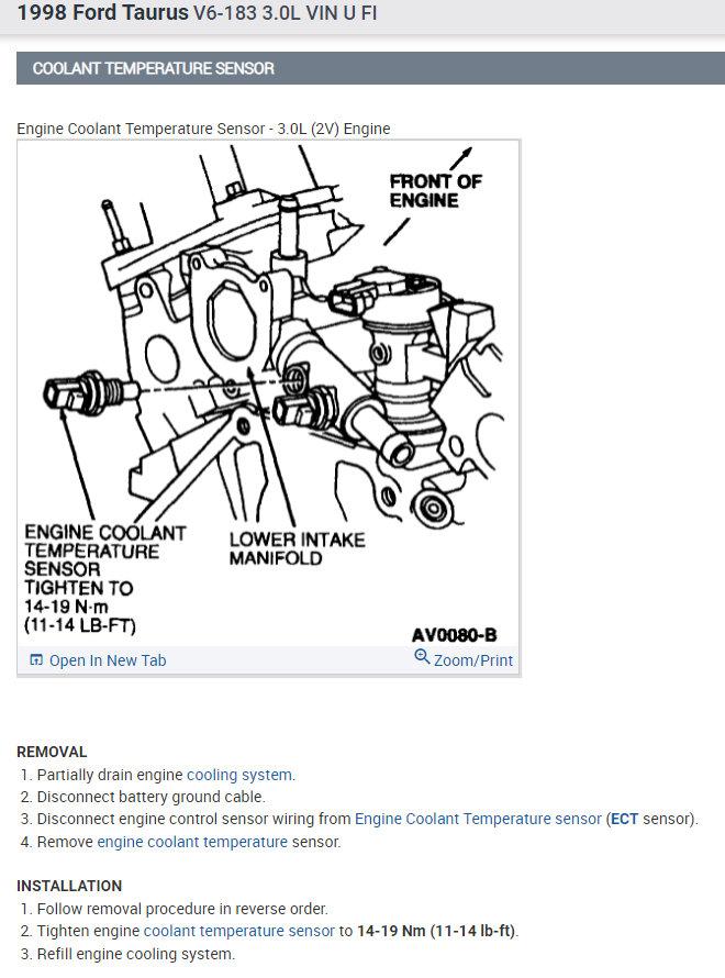

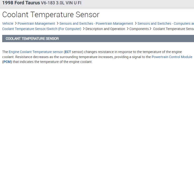

It sounds like it could be a issue with the coolant temperature sensor. It is possibly sending engine 'too hot' to start signal to the ECU. As you wait for a little bit the sensor resets and allows you to start.
The coolant temperature sensor is located on the upper part of the engine next to the thermostat.
Many times a faulty coolant temperature sensor will trigger the engine light.
