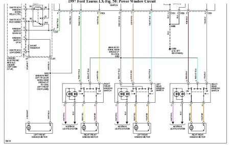

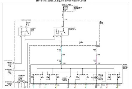

my starter went out, when they were checking fuses there was a spark and ow my windows will not work, fuses are all good. cant find correct wire from fuse box. is there a manual that shows which wire is which. thanks for any help

check fuse #4 in underhood fuse box
https://images.2carpros.com/forum/automotive_pictures/266999_taur_2.jpg
https://images.2carpros.com/forum/automotive_pictures/266999_taur2_1.jpg

thank you for response, fuses are all fine hard to see diagram you sent were can I find this.

left click your mouse button over the diagram and save it to your computer .. then you can enlarge it etc. ... there are 2 pictures to save !!
