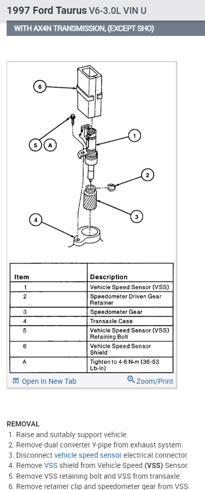

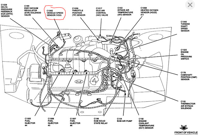

97 taurus 3.0 l. Car starts fine, but when putting in gear nothing happens at all. No sign of gear engagement at all. Put a volt meter on tr sensor & it gets power. Can't find vss on transaxle, have haynes book but picture doesn't tell much. Do I need to put car on jack stands to find vss to test w/ volt meter? Have looked at diff. Websites but not much help. Any help would be greatly appreciated. Thank you

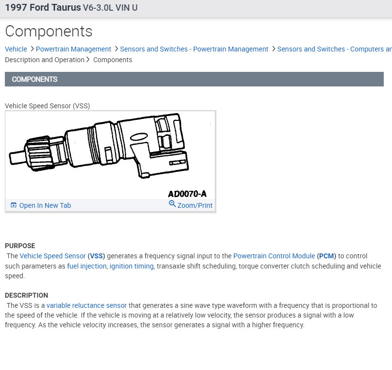

1997 Ford Taurus. I had the classic problem indicating a intermittent failure in the VSS sensor. The speedometer didn't work and and transmission didn't shift correctly or sometimes remained in low gear when the car got hot. I looked around on the passenger side output shaft and couldn't find the sensor. I then moved to the drivers side and looked in under the exhaust manifold and there was a sensor way back in there. To verify this sensor was bad, I disconnected the wiring while the engine was cold and everything was working. The speedometer and transmission stopped working. I installed a new sensor and the speedometer and transmission worked again. My question is, did I change the VSS(Vehicle Speed Sensor) or the TSS(Transmission Shaft Speed)? Can either of these cause the same problem? I sort of vaguely remember when I had this same problem 100K miles ago with this same car, the mechanic had a ratchet stuck down on the passenger's side of the engine compartment where most articles say the VSS is located.

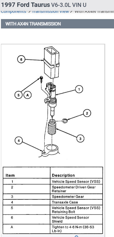

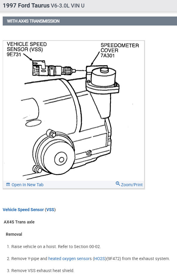

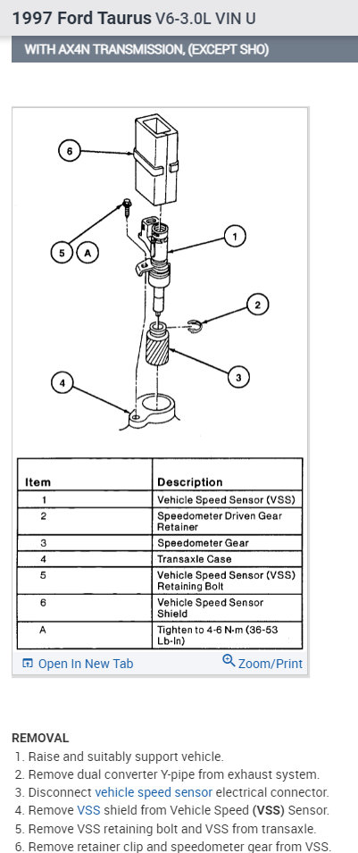

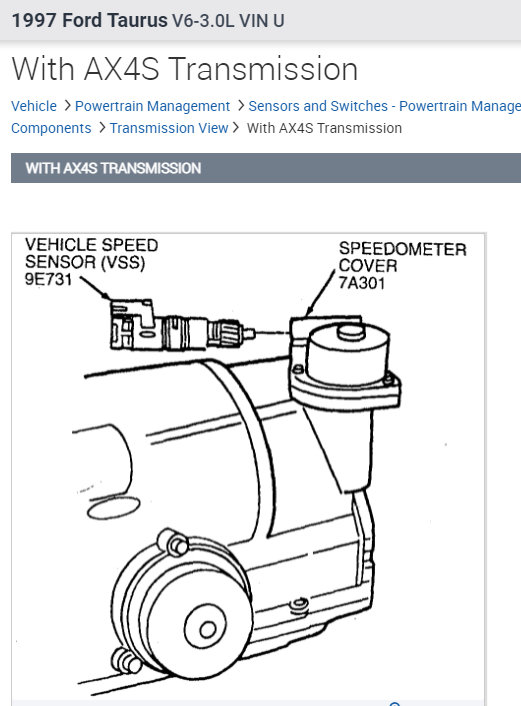

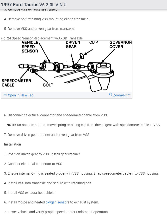

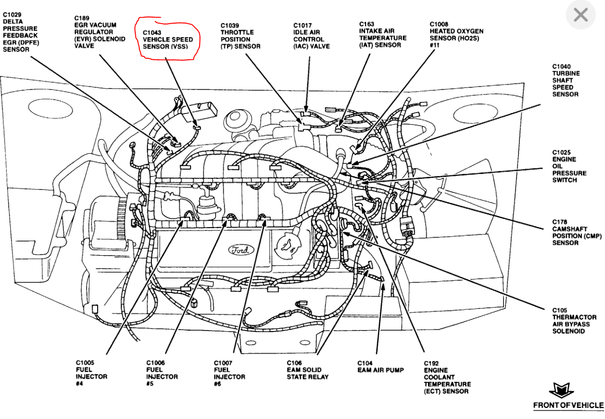

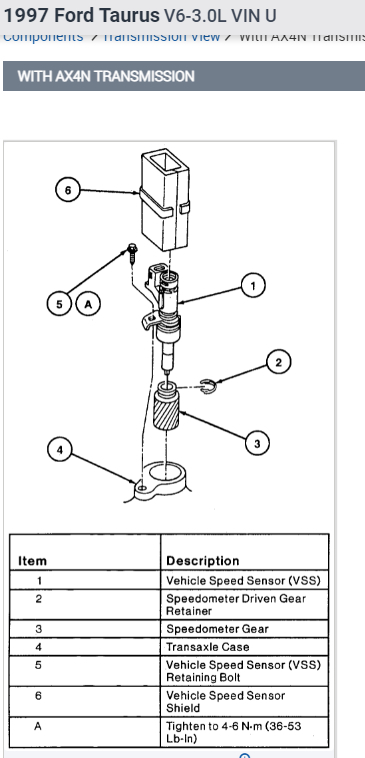

The Vehicle Speed Sensor is located at the rear center of the engine compartment, mounted on transaxle (see diagrams below).
Depending on the transmission of the vehicle AX4N or AX4S, the VSS can mount differently
I have included the VSS diagrams for both transmission below.
