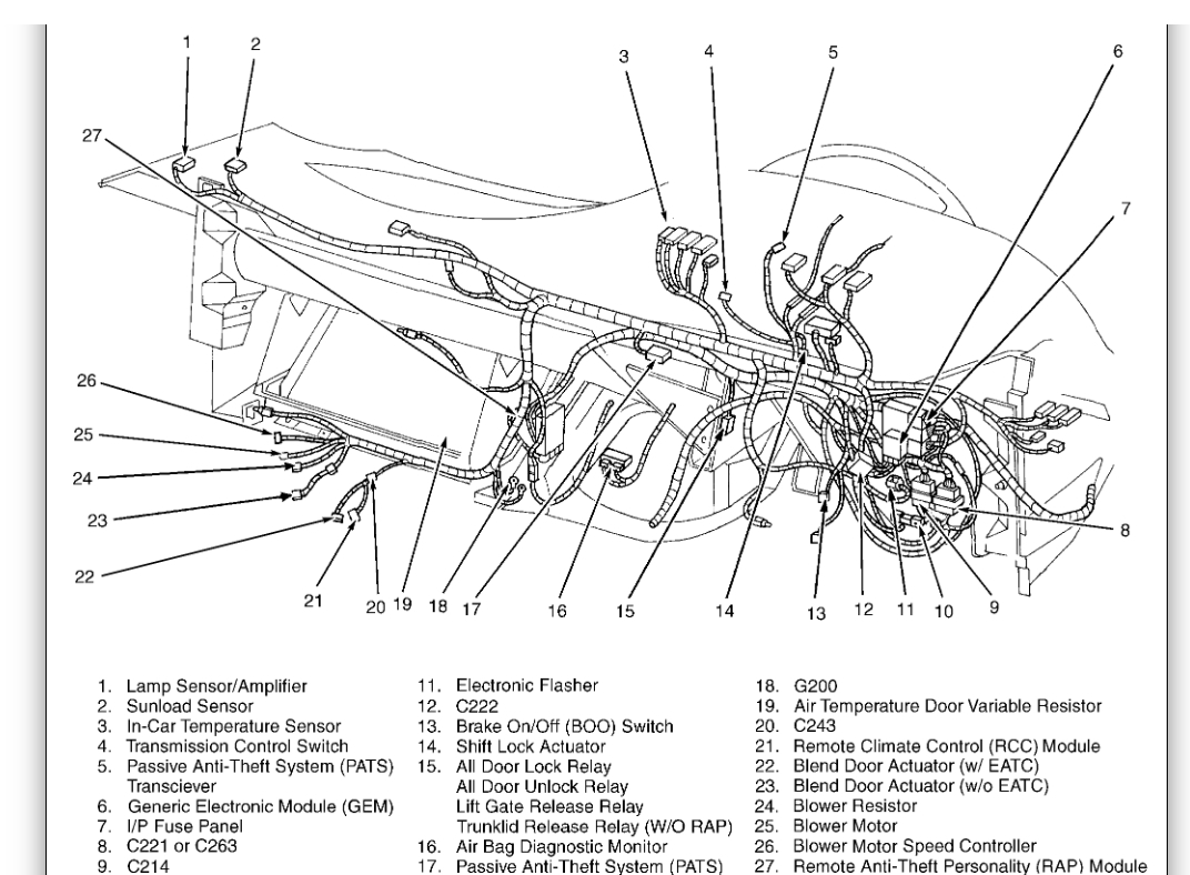

Where is the relay for turn signal/hazard lights on the above mentioned car?? Thanks much!
Feb 13, 2009 at 12:04 PM
BLUELIGHTNIN6
  • 16,542 POSTS
It is called a GEm module located in the front seating area, driver side, under dash, driver side of steering column, mounted behind instrument panel. Check out the diagrams (Below). Please let us know if you need anything else to get the problem fixed. Thanks for using 2CarPros.com!
