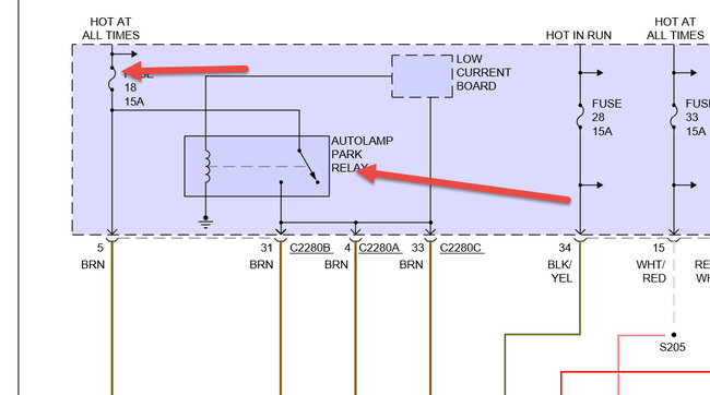

Parking lights and tail lights will not turn off
12,000 MILES • AUTOMATIC
DONNA BROOKS
Lights wont shut off, tail lights or parking lots. Disconnected battery and still an issue.
Nov 2, 2016 at 12:56 AM
HMAC300
  • 48,601 POSTS
check the auto lamp park relay in smart junction box. it may be sticking and holding them on. see picture. in the future if you pull fuse or relay they should go out. also if it still continues after this have smart junction box checked by a mechanic.
