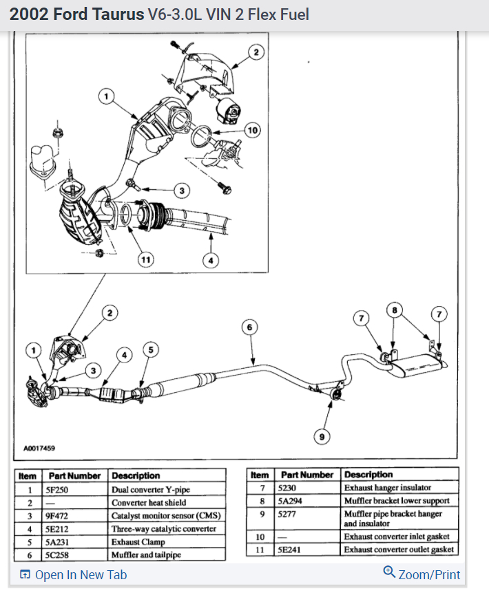

I have a 1996 Ford Taurus that has the catalytic converter low efficiency on bank 01 error. I know the Taurus has 4 catalytic converters. Can only the 2 converters serving bank 1 be replaced or will all of them have to be?
Also, are there any other causes to this OBD error. Since it measures the difference between the two O2 sensors, is it worth a try to replace these sensors or at least swap the sensors between the banks to see if the error moves with it?
Dec 14, 2020 at 7:46 AM (Merged)
MERLIN2021
  • 17,250 POSTS
If you have a P0420 code, read the live sensor data from the upstream and downstream O2's, the upstream should be constantly switch and the down stream should remain fairly flat. A dead sensor can cause this code, but the converter can also, You should change the sensors anyway at this point, or if you have 100,000 or more miles! Yes you can change seperate cats!
WRENCHTECH
  • 20,760 POSTS
It is extremely rare for this code to be anything but a bad converter. In order to set the code both sensors have to mirror each other and that doesn't happen by accident. I have seen it happen when there is an exhaust leak just ahead of the upstream sensor but I only saw that once.
Since this is a "Y" pipe setup, it's pretty impossible to weld in an aftermarket converter. the whole pipe has to be changed but there are aftermarket companies that sell them cheaper than the dealer.

My Dad's 1996 Ford Taurus 3.0L G, failed inspection for emissions. The results page showed codes of P0420 and 0430 which are Catalyst System Efficiency Below Threshold in Banks 1 and Banks 2. One mechanic told me that it means the catalytic converter needs to be replaced, while another mechanic said it means to just replace all four of the O2 sensors that the car has.
For starters, those two repairs are a major difference when it comes to price, the 02 sensors would be a lot less expensive of a repair, yet would that solve the problem to get his car to pass the state emissions inspection?
Second, if it's the converter, which one should I go with? I was on various car parts sites, and there's 3 different types for my Dad's car model(Taurus G), ranging from $41 all the way up to $350+. We need to get this resolved asap as he's due to take it back for reinspection very soon. The 45 day grace period is close to its end. Thanks for any help.
Dec 14, 2020 at 7:47 AM (Merged)
RACEFAN966
  • 5,029 POSTS
Ok here is how the test is done. This test is done at cruise mode. The counting of the front and rear Heated O2 Sensor switches are counted during a drive cycle. At that time the ratio of total rear switches to front switches is calculated. If the switch ratio is greater then the emission threshold the cat has failed and the light is turned on. The light is turned on after 6 consecutive drive cycles. Now none of this is counted at idle.
I would clean the mass air flow meter with mass air flow meter cleaner. Then have the code cleared and see if it comes back on. To clear the codes if you do not have a scanner I would call around and find a parts store that does free scans.
If the code comes back then I would call exhaust shops and see if any do an exhaust flow test to make sure the cat is pluged before replacing it. Thanks and Merry Christmas.

1996 Ford Taurus 6 cyl Automatic 119000 miles
My Dad's car failed for inspection due to P codes 0420 and 0430 which came back to be a bad cat. Also, the check engine light has been on steady since then. I've searched online and there seems to be endless types of convertors to buy for the car. We're looking for the most inexpensive route, and I have a link if you goes wouldn't mind going to it and helping me pick one. http://www2.partstrain.com/store/index.php?N=10340+1616+4294965378+11921+9189&Ns=price2|0&Npp=15
I'm leaning towards the one for $83, would that fit my car? It says that it's solely for the "G" model. The car is a 1996 Ford Taurus G, 4 door, automatic, 3.0 V6. Thanks for any and all help.
BMRFIXIT
  • 19,053 POSTS
In your case I would buy the direct -fit catalytic converter
as its easier to remove and replace
verse the universal -fit
as it will need cutting and welding and so on
what you chose is what I would buy
good luck
